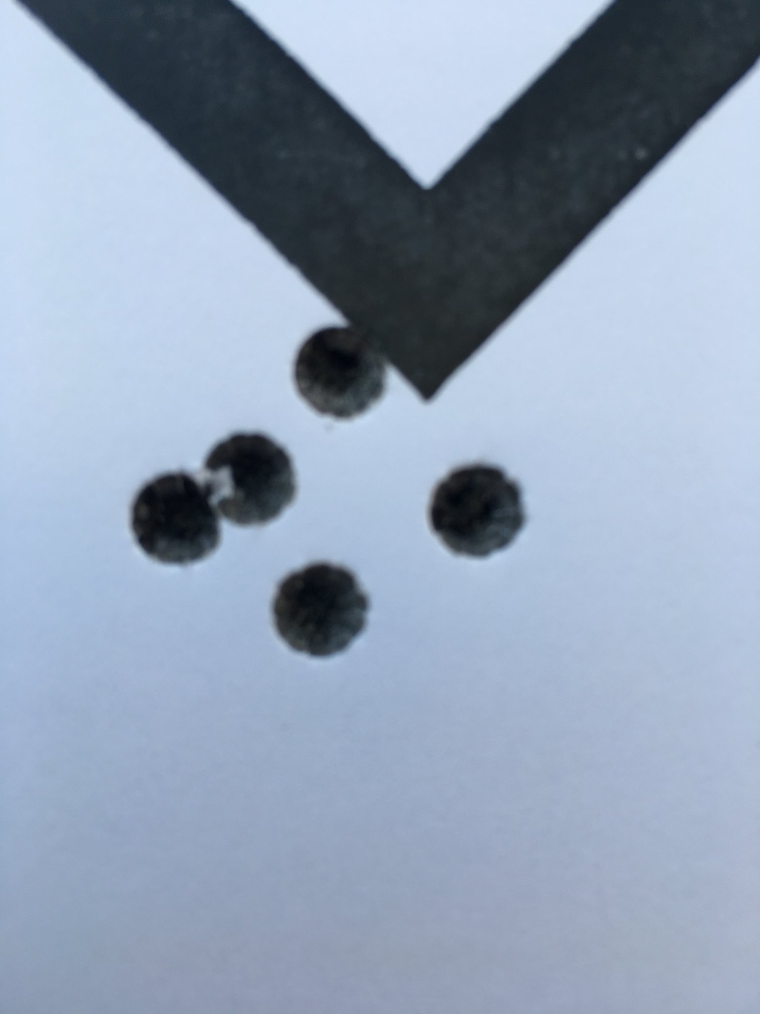

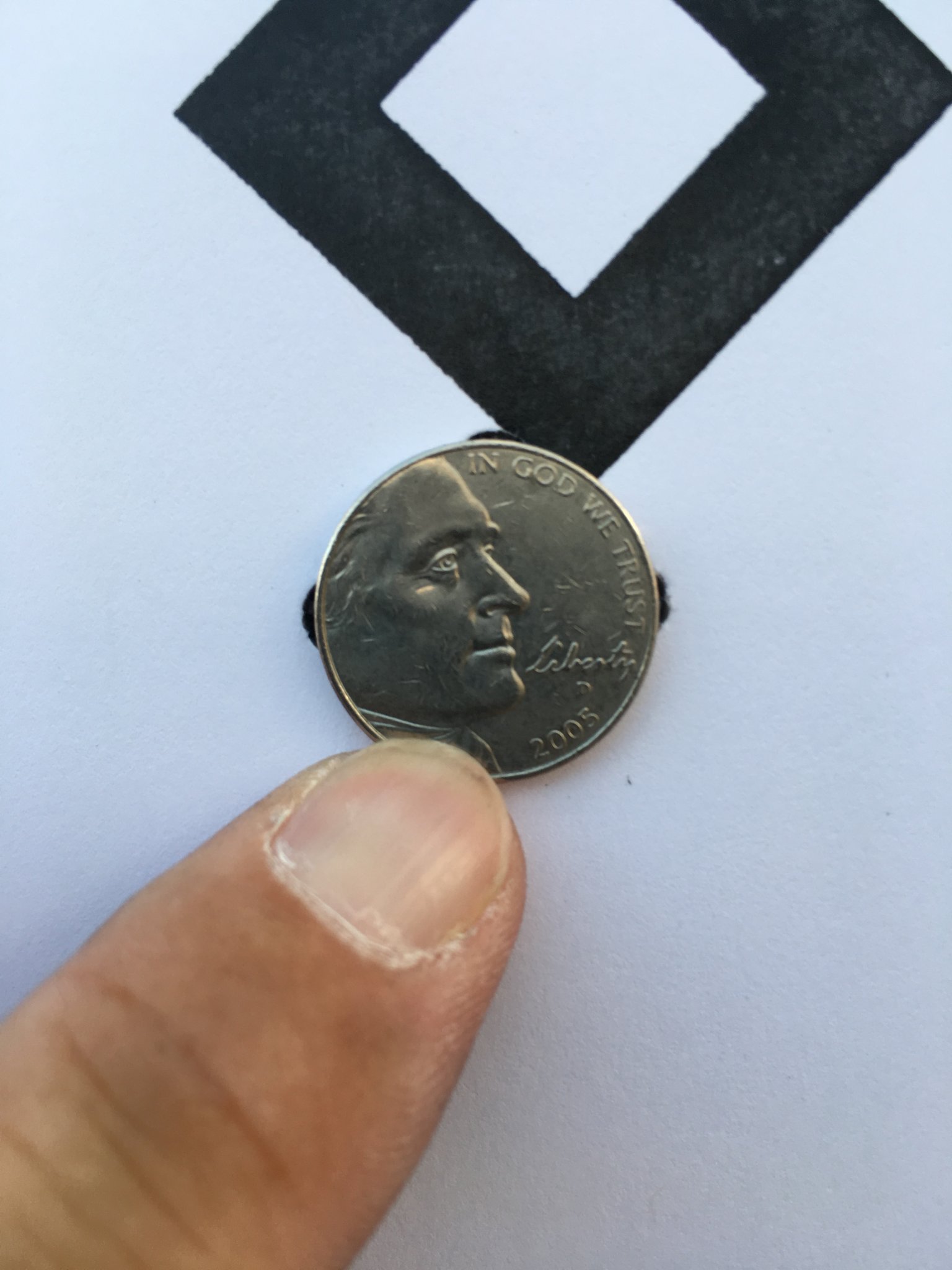

Best "factory" ammo for LR shooting is ammo that is tuned up to your rifle.
Quality ammo matters, longer the distance the more it matters.
Practice does not make perfect, perfect practice makes perfect.
Every time you change propellant / jacket material, takes 3-5 rounds for barrel to settle down. There is a reason service rifle guys try to run a single powder, jacket material. Your test of alternating PPU / FGMM for groups did more to muddy the waters than not.
First 5 rds @ 100
Second 5 rds @ 200
View attachment 7137433View attachment 7137434
Third 5 rds @ 100
Stock 700, 5R, 20”, 223, isn’t even bedded.
Berger 73 Match BT, virgin brass
Ammo matters if you want to learn, not guess what is happening, IMHO.
Better the ammo shoots from your rifle, the more you will get from the class.

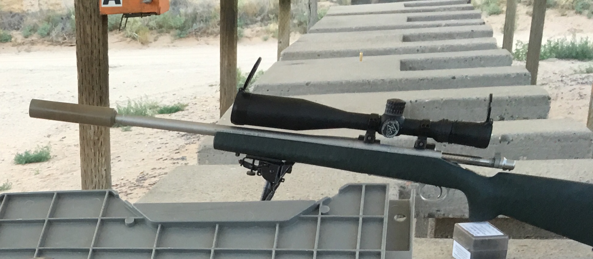

To your question, it is a FN A5m XP 20” 1:10 twist rifle with the factory barrel and the original McMillan A5 stock with a Steiner 3-15 scope in a Spuhr mount. I am quite unclear why you ask about the stock, optic, and the optic mount when it comes to the ammo selection? Can you clarify the reasoning behind the question about the stock, optic, and optic mount because I would guess that the rifle would shoot the same with or without an optic mounted neglecting the difference in overall inertia and center of mass differences.
My SAKO TRG 22/308 shoots factory Hornady 178gr BTHP better than FGMM 175gr SMK or 185gr Berger. The G1 BC of the Hornady 187gr BTHP is .530, which is better than the 175gr SMK.
YMMV
Best,
Will
Thats interesting. FGMM 175s are the most accurate factory load I have found for my TRG and I have tried many. I can handload for it with a lower SD but Ive yet to get a handload that shoots smaller groups at the shorter ranges before SD really matters.
Because ammo is the fuel for a SYSTEM, weak links in system can easily cause issues.
Rem 700 in a Tupperware stock? That’s gonna be an issue.
Bushnell 3-9 Sportview? That’s gonna be an issue.
Without having some idea of the system being used, really hard to make any meaningful suggestions.
