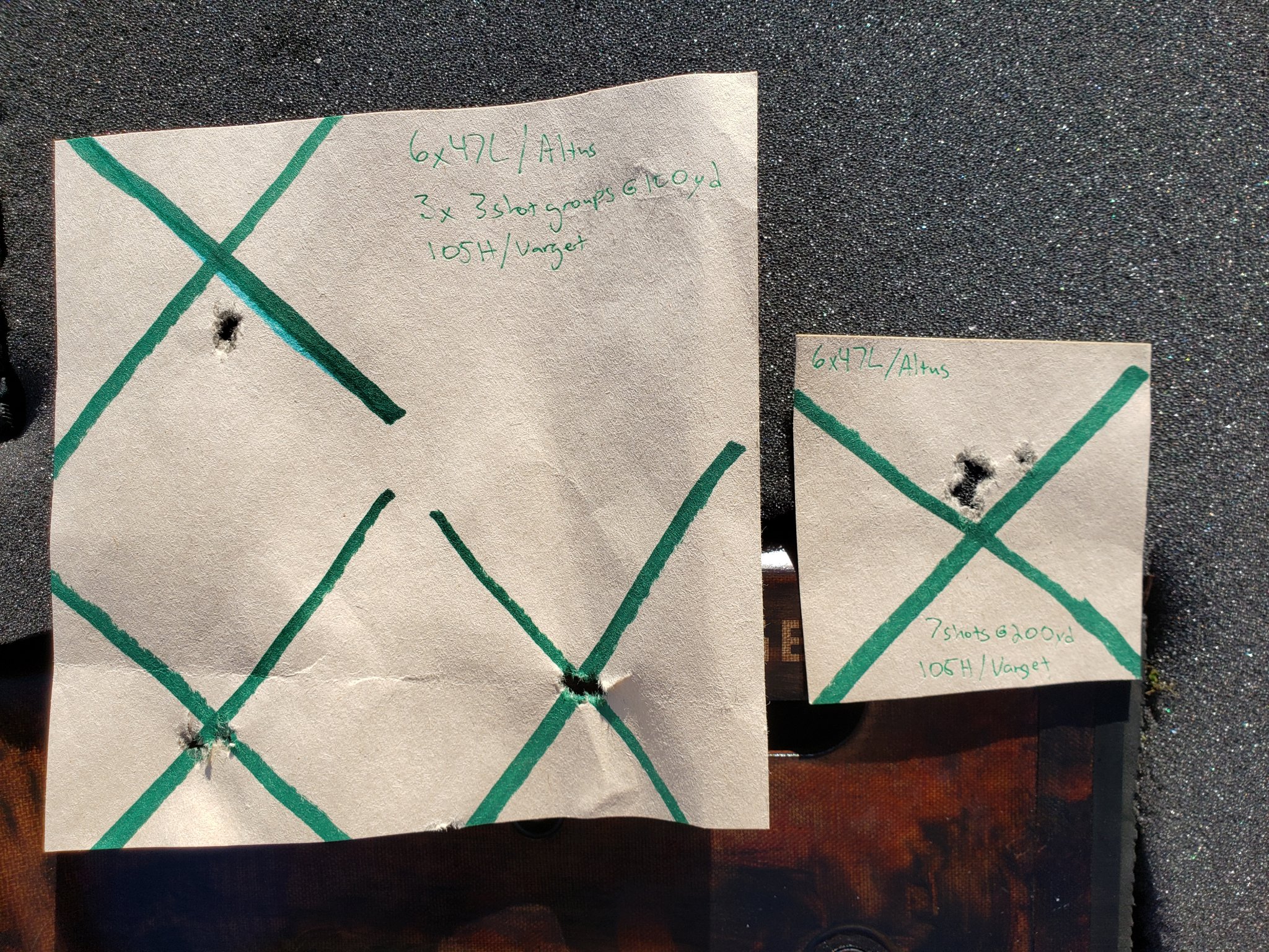

I've had great luck with the x47 as long as I'm using Varget and not hot rodding it. One rifle averaged .15 moa over 5 groups during load development, the other shot three back to back groups that averaged .16 moa at 100, and 6 of 7 shots at 200 went .17 moa getting an initial zero. Pretty fat accuracy node from 2950-3050 fps with 105 hybrids.
Or you can listen to the internet and not get one lol.
Added: RL16 and H4350 are not nearly as consistent and have a much narrower band for good accuracy and it will be harder to tune. Treating it like a dasher and sticking with varget is the key in my experience. I'd even go as far as to say that a lot of the reason the dasher / BRA is so accurate is that they also use varget / 105 hybrids. It seems anything that uses those two can shoot very small groups very consistently. The 6mm GT that GAP is coming out with is no exception either.

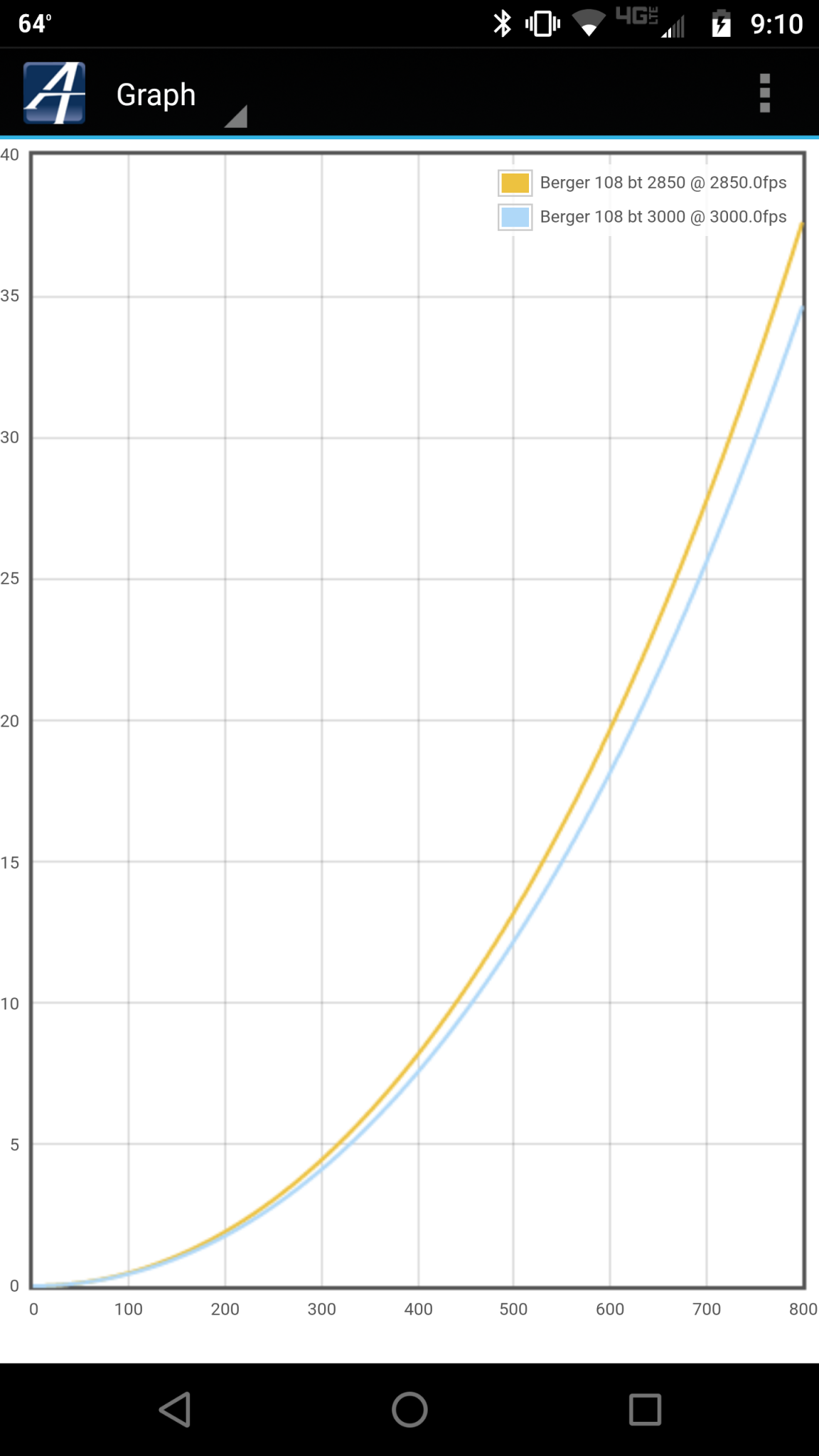

The difference between a 105 at 2800 and a 105 at 3100+ is pretty damn significant on paper. In function though it doesn't really bother me that much. I do miss pushing the 115s I ordered a 6.5 cm barrel though for longer ranges and windy conditions. My next round will be 6.5/284
The difference between 2850 and 3000 isn't that much on a 1-3moa target in a low to no wind place like Missouri.
8mph wind with current atmosphere here today in Missouri.
I'm in TN our wind in the mountains is either non existent or Gale force... I absolutely love the 6 br round I have taken mine out to 1200 with regularity. If I miss I would have missed with a 6.5 caliber also or with a hot 6. I just spin on the 260 if the wind is up. I actually have a cutout in my pelican for two extra barrels lol.

.243 gets my vote. You can shoot 108s 3400 FPS with R26 or 2850 FPS with H4831sc. Pretty versatile.
