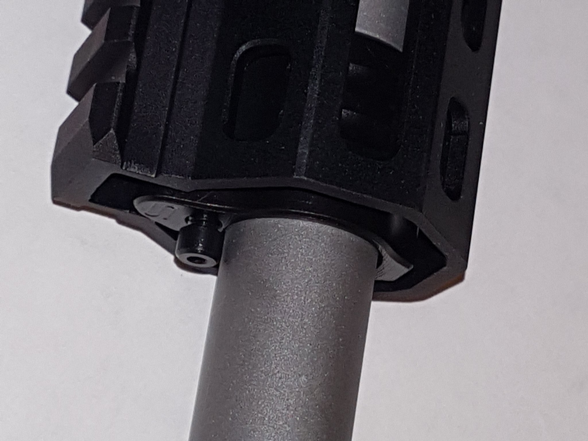

Rifle length gas is pretty easily accessible under a 15" rail with an SA. They come with a pretty long allen key to reach it. I have an SA on a rifle +2 and all but the back 1/4" or so of the block is outside the rail. On my other barrel that's rifle gas the block is just barely covered by the rail.

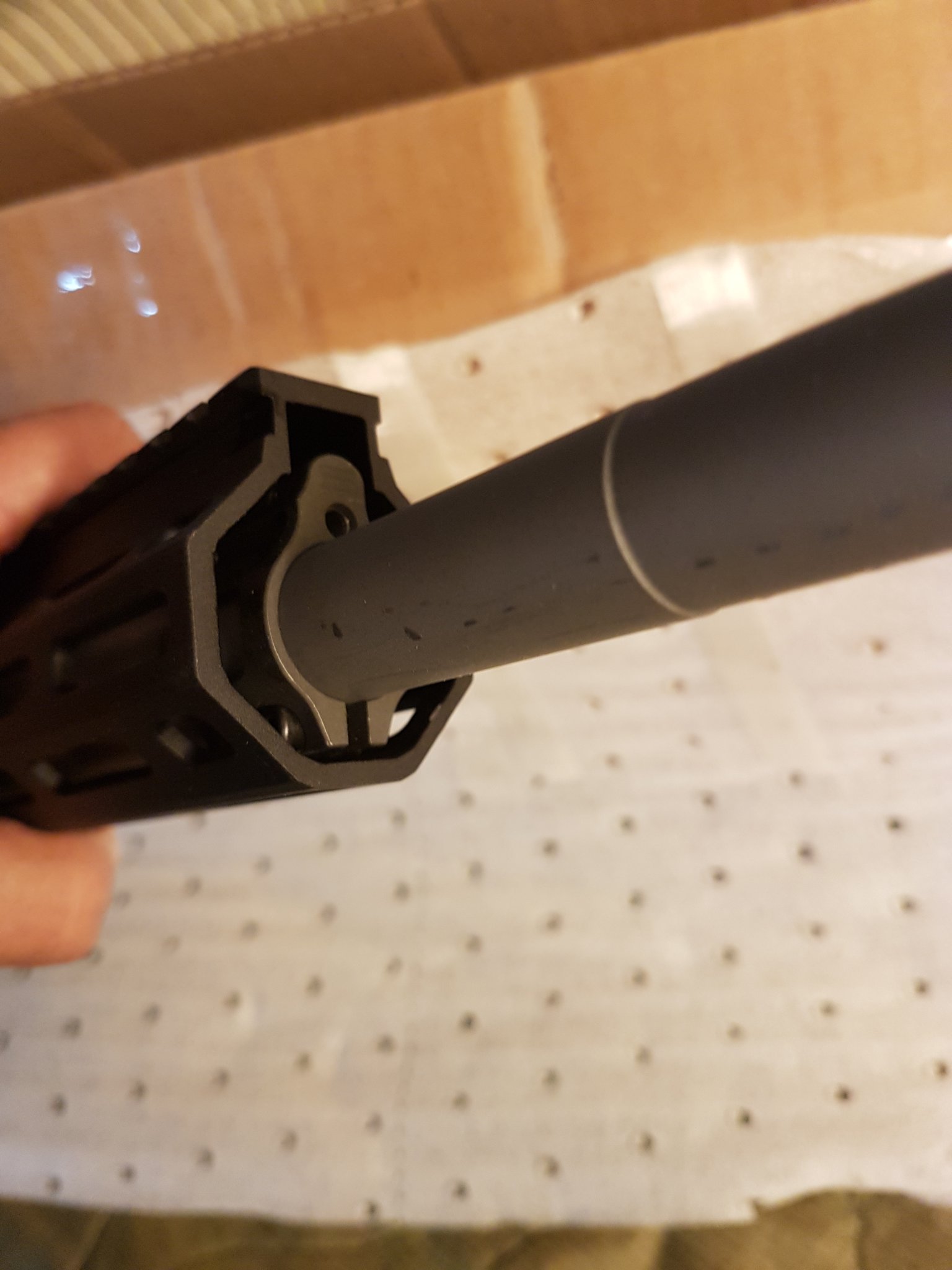

I have a Seekins on a Rifle+2 gas with 15” handgaurd. Sticks out about 1/2 the gas block. Just ordered and SLR Sentry 7 for a 6 ARC build on rifle system also with 15” handgaurd.
Seekins adjust from the side. Not too good unless your handgaurd has m-lock or other relief access. The SLR adjust from the front. Much easier access with supplied allen or longer allen wrench depending on your gas system and handguard length.
PS - my Seekins is a 0.875” AGB and barely fit under a 15” Rise Armament Slim handgaurd. I had to relieve some metal around the gas tube channel as the gas block widened too much to clear the channel.
...SLR "clamp" & "set screw" type AGB's under a CMT 13.7" HG, rifle length gas system....
