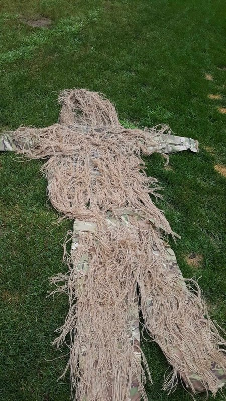

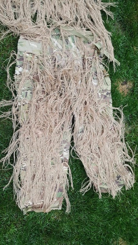

this is about how much jute i run on my ghillies......this is my newest suit i just put together, still need to break it in.
i use them mainly for duck hunting, so i dont need to be "invisible" .....just need to break up my outline a bit.

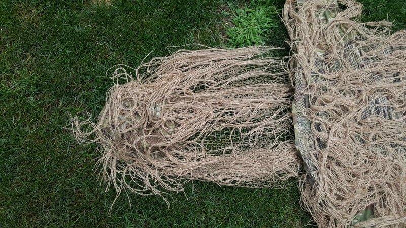

this is the suit i was running......i tried using sisal instead of jute.....not too happy with it, im probably going to strip it off and jute it.....but this is with only 30% of the veg on it, it usuaally has a lot more grasses on it
That thing needs a hosing down, some dirt and someone fucking it up with a wire brush :D
haha yeah im working on it.....slowly getting rid of the "pasta man" look......thanks for the wire brush tip, saved me a lot of time shredding the jute.
