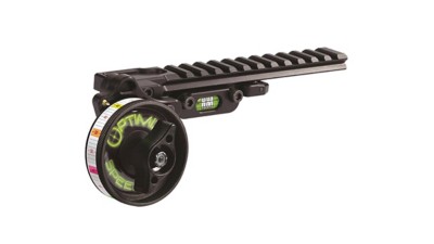

    Get one of these and put any scope you want on it. I put a 3-9x40 Leupold on mine. Crossbow scopes are junk. Took 30 minutes to dial it in at 60 and I’m good from point blank to 100.
