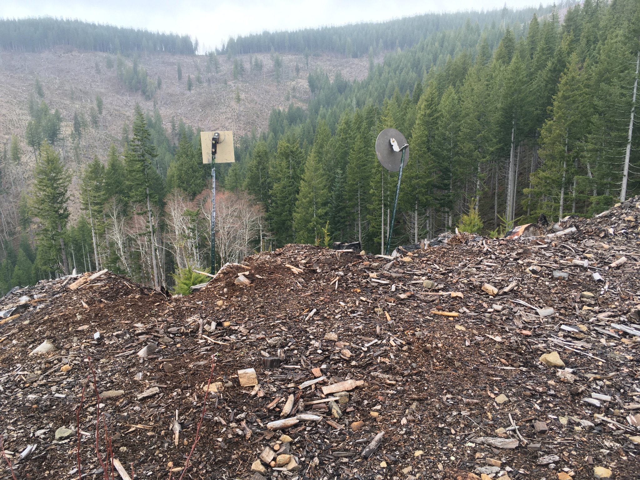

We used round farm type discs 18” to 20” And welded a 6” piece of closed end pipe to each side. Then pounded in two T posts and set the disc over the top. No bolts or chains. Need to be beyond 500 though, any closer our 6.5 PRC’s were punching holes.
12 square mk machining on left and 18 round hang fast target on right
I really like the hang fast system and it’s a 1/4 “ so it’s real loud both ar 500
