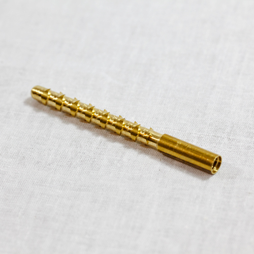

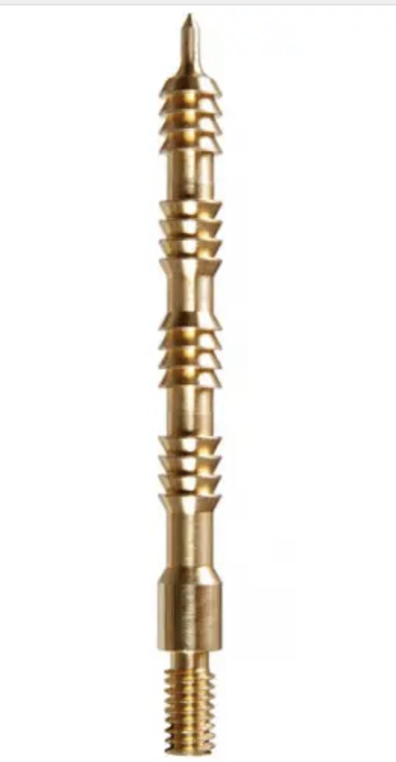

2. Brass Jags: I mostly use Parker Hale type...forget spear-type or patch holders. They look like this:
If you get them from Dewey, you made need an adapter if you intend to use them with other cleaning rods since they are female threaded.

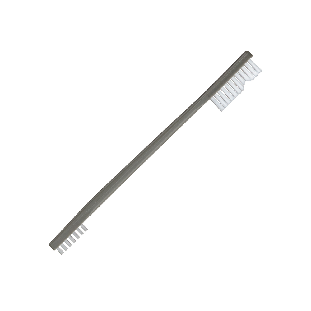

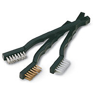

6. Toothbrushes: Get GI-Type toothbrushes, Otis Tech makes some damn good toothbrushes, with blue bristles.
Get ones that look like this:
Not these, these suck:

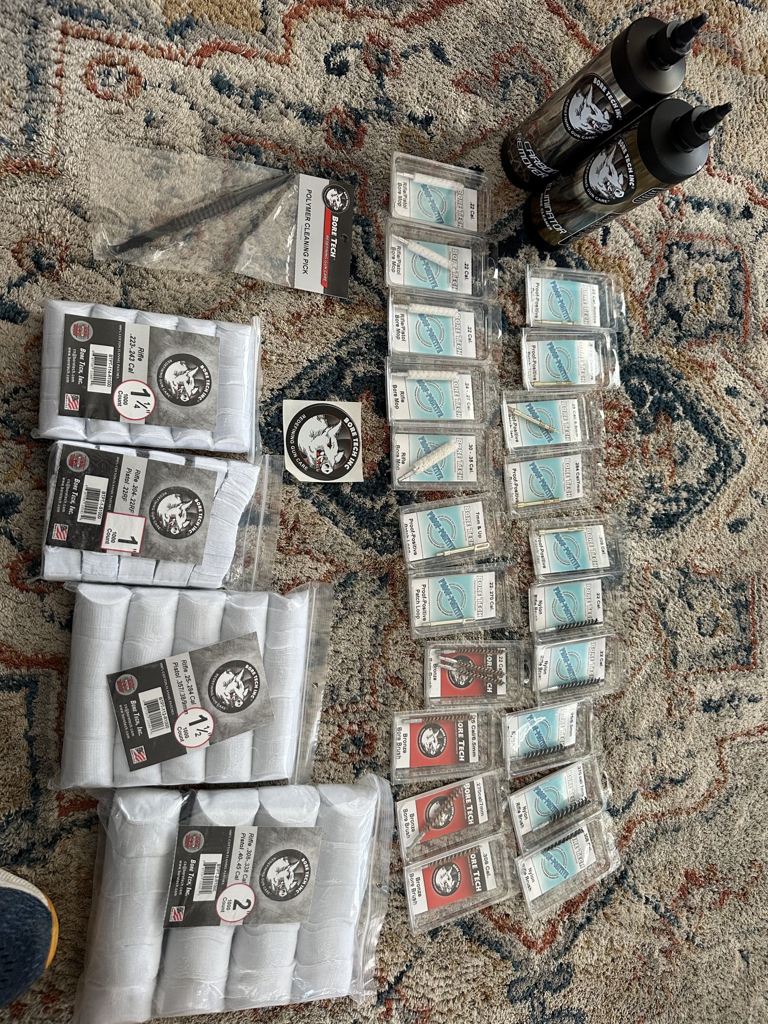

I ran the same random rods & jags until a couple weeks ago I decided enough was enough.
I basically ordered the whole Boretech catalog for all calibers I have.
Standardized & organized so cleaning is no longer a hunt through 3 different toolboxes of random junk.

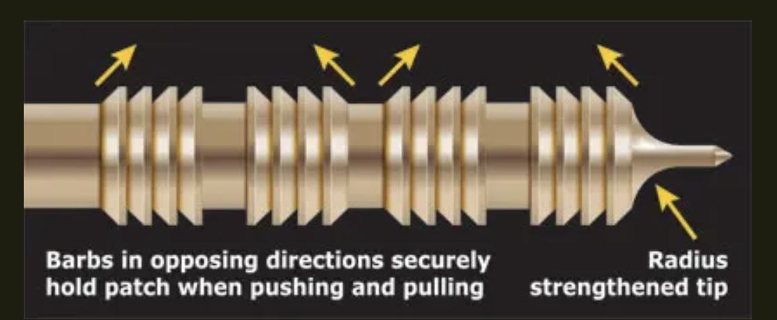

Just wanted to pop in and say Montana Xtreme’s jags are a cross between a spear jags and a Parker Hale. I’m a user of mainly Pro Shot rods and jags…they have nice Parker Hale type jags but I find cutting just the right size patch for each bore size tedious, and rolling the patch on the PH jag also a slight pain.
Again, slight pain here. Not a major pain.
What drove me to explore other brand’s jags is no one seems to make either 17 or 20cal PH jags.
With Montana’s “PH-like” jags, you simply pierce the patch, stick it in, and stroke back/forth. No winding the patch around the jag. Smart! And fast!
So far I only have the 17 & 20cal Montana jags of this type.
