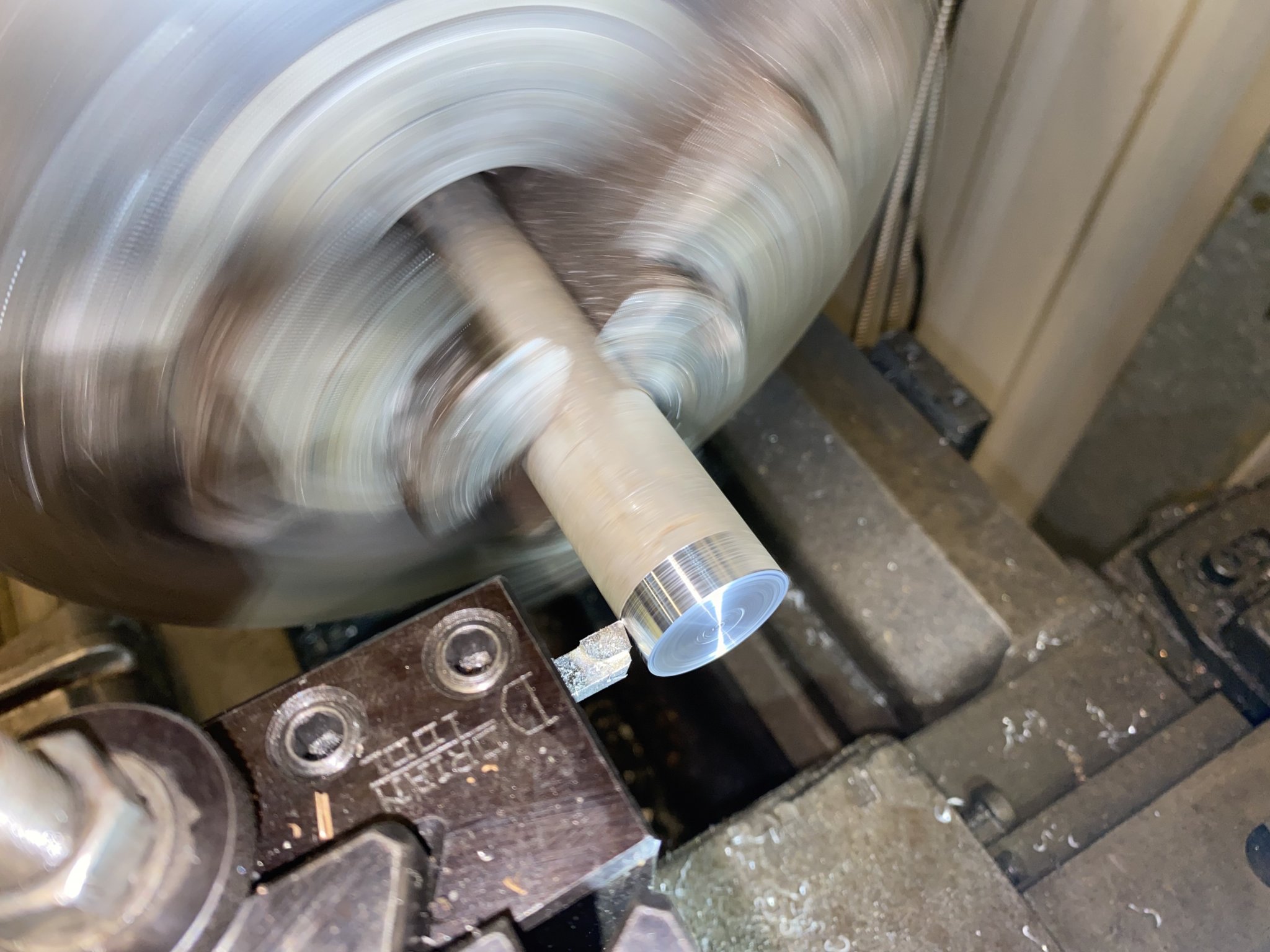

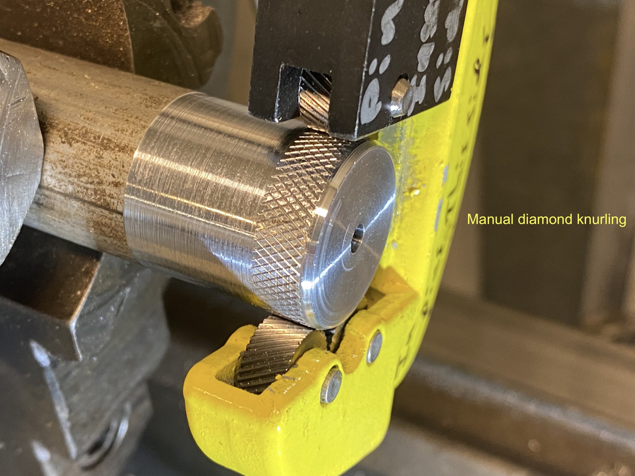

For almost 10 years now I have been using the vertical Bridgeport Series 2 & LeBlonde CXA size lathe now to tinker on gunsmith related projects. Need to learn how the machines work and how you work the machines. Tubal Cain (MrPete22, Joe Pie (Piecynski), and BlondiHacks (Quinn) have fabulous on line videos to learn from IF you have the machines to learn on. You might consider a local junior college campus that teaches machine shop methodologies, as there is a lot more to "gunsmithing" than turning tools (mill) and turning parts (lathe) than meets the eye. I am always in awe of some of the machining the pro's on this forum show us with their CNC machines at a different level of expertise.

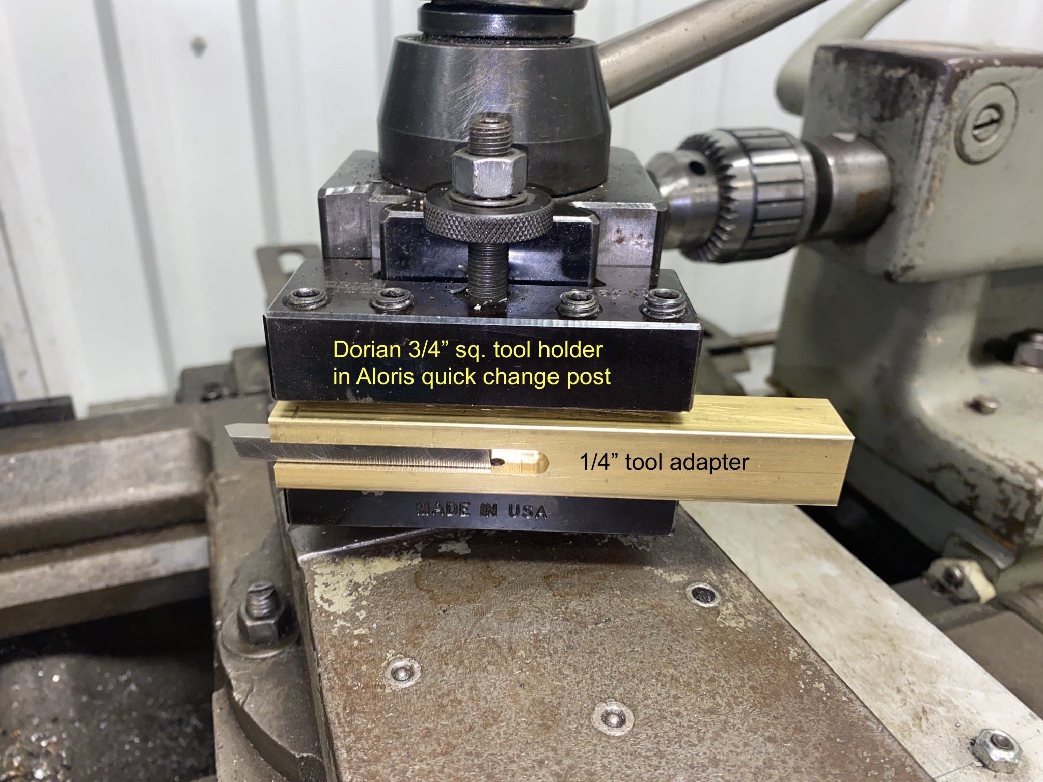

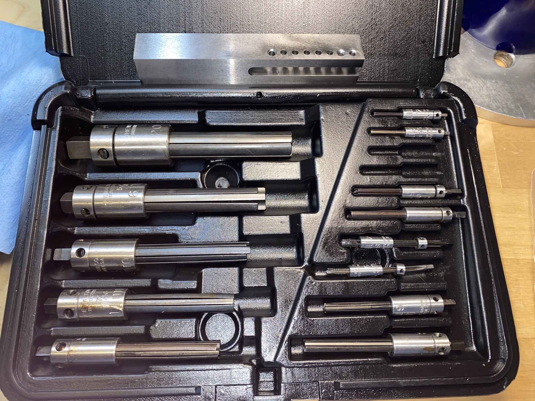

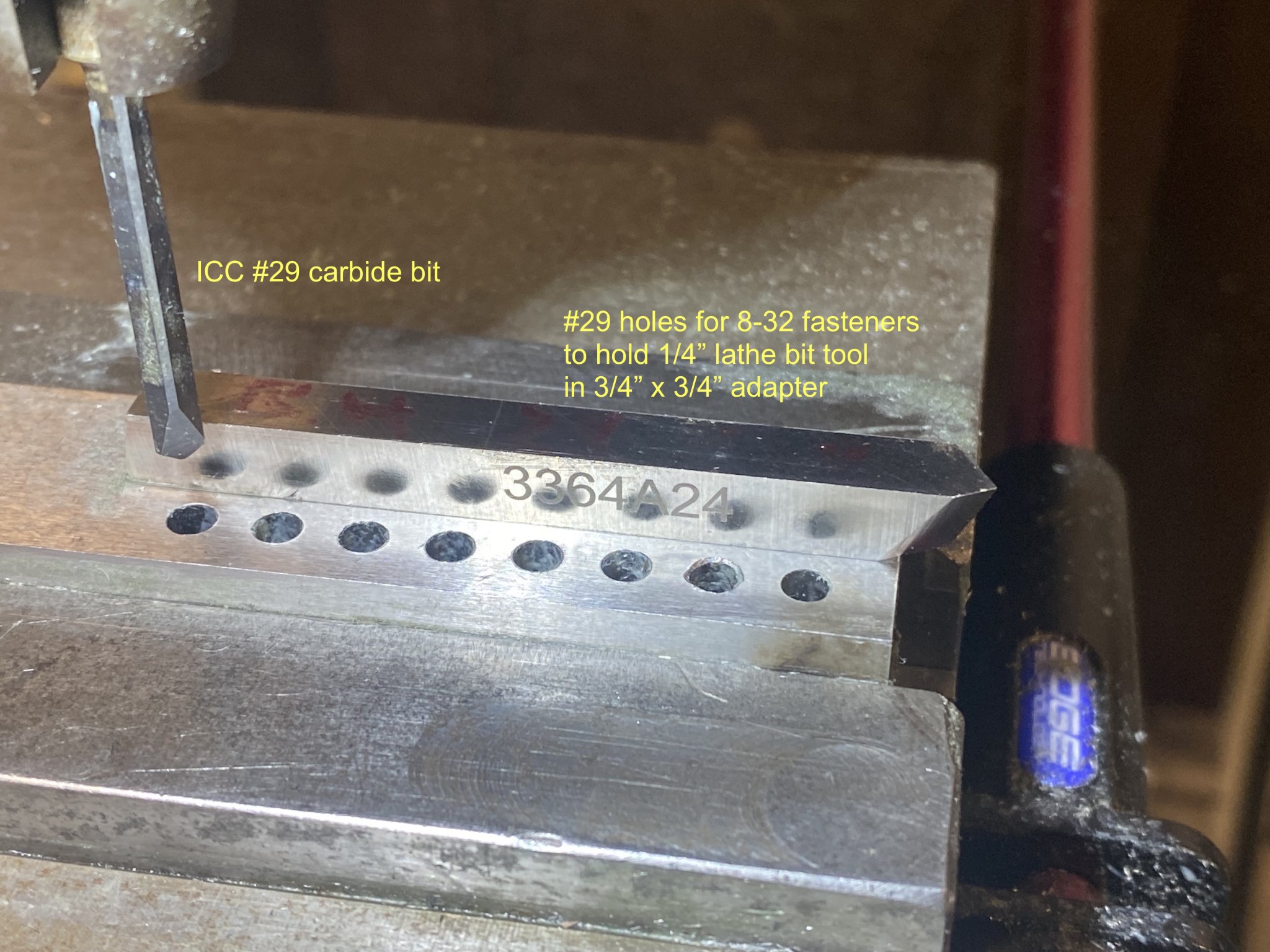

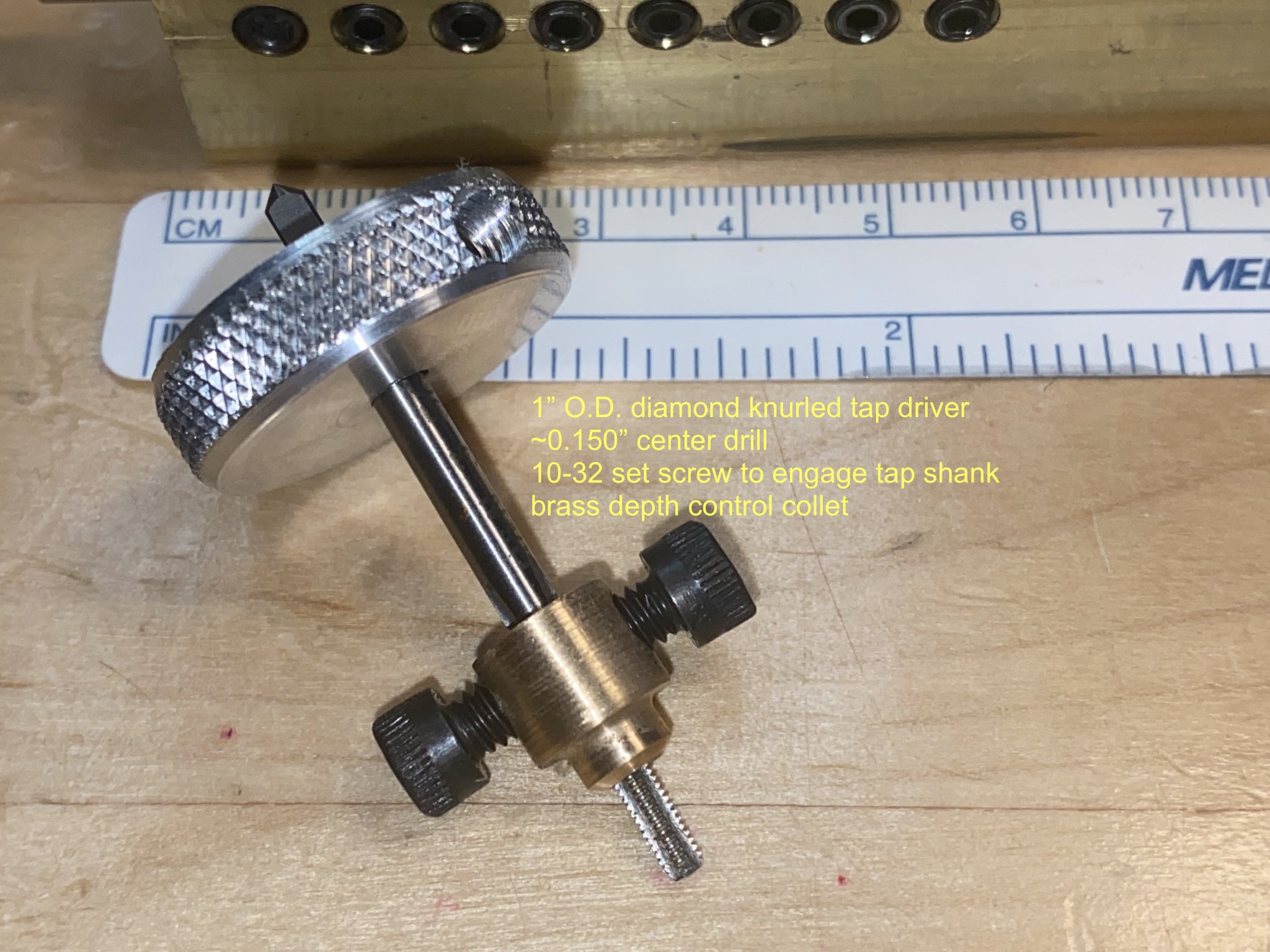

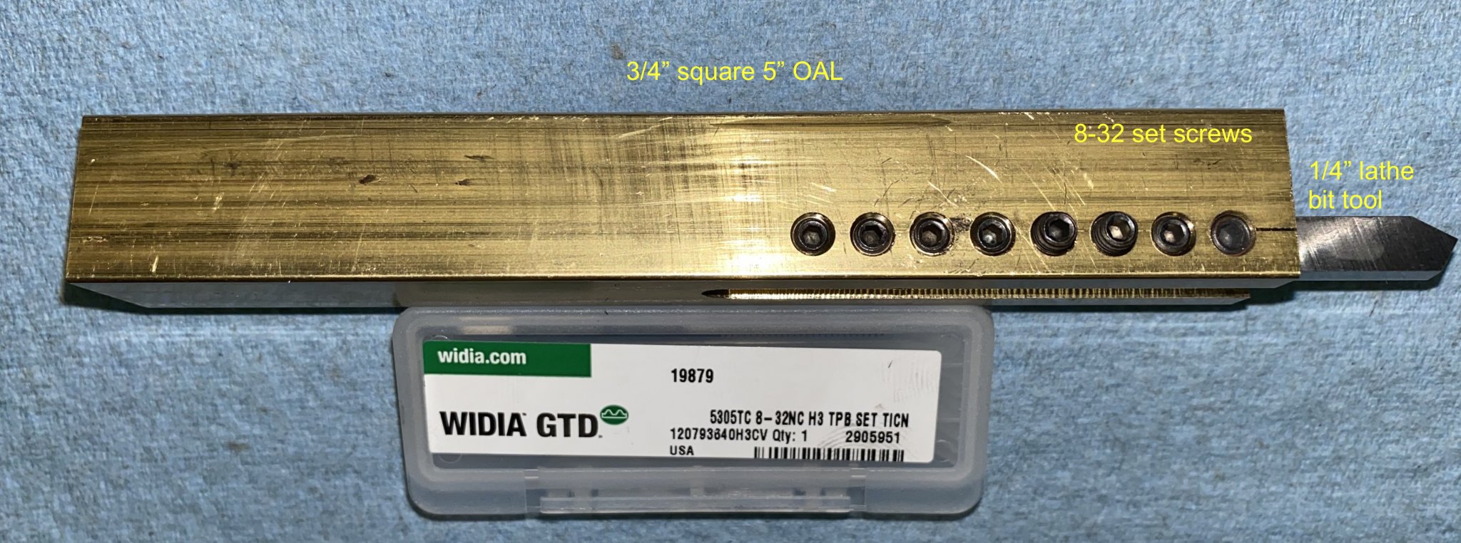

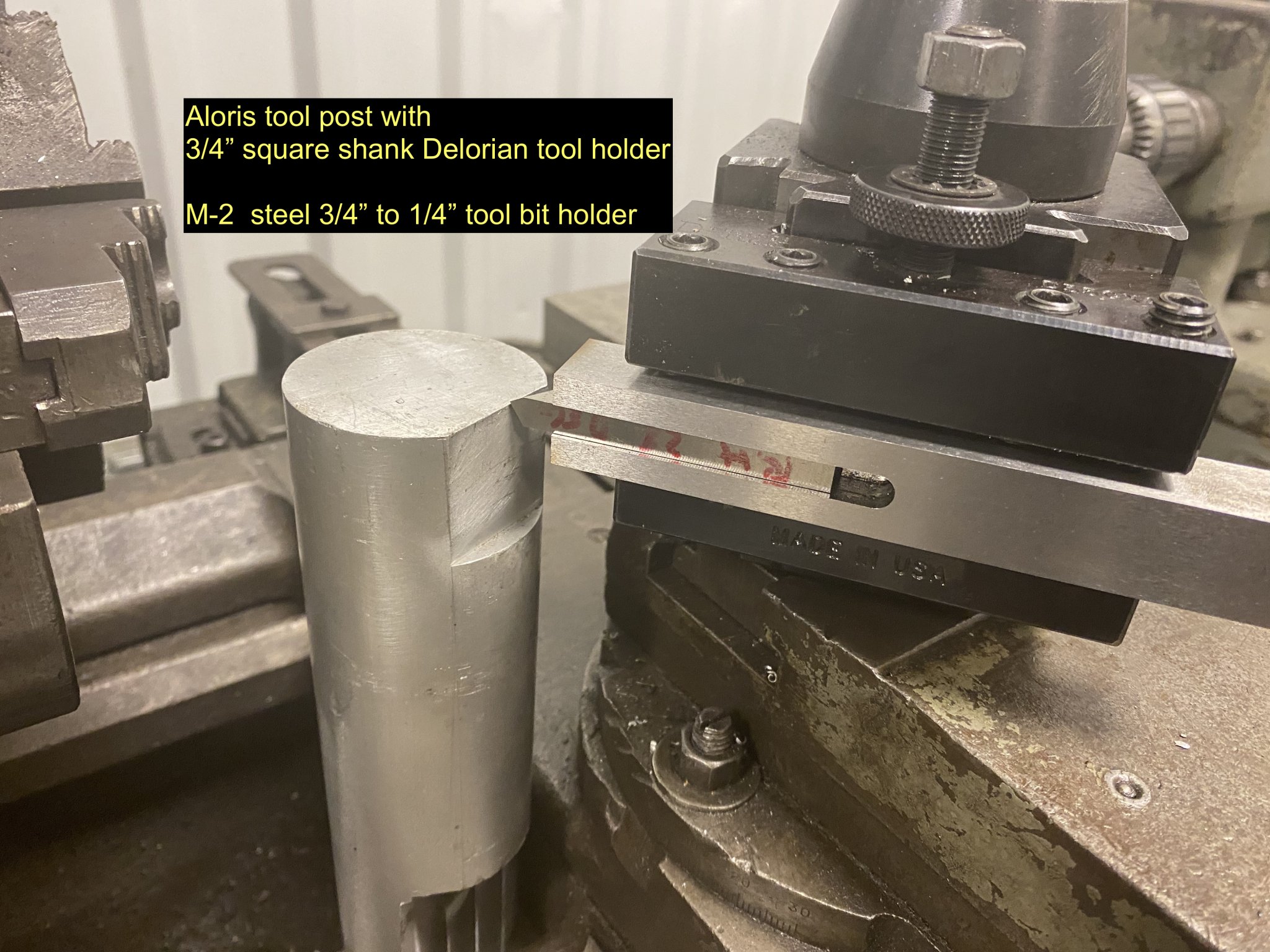

I just finished fabricating a 3/4" square lathe tool bit holder to use 1/4" lathe tool bits to get into smaller spaces than allowed by the larger tools held by the CXA post. Then used the adapter to fabricate a small cylindrical tap driver for very small gunsmithing hand tapping applications.

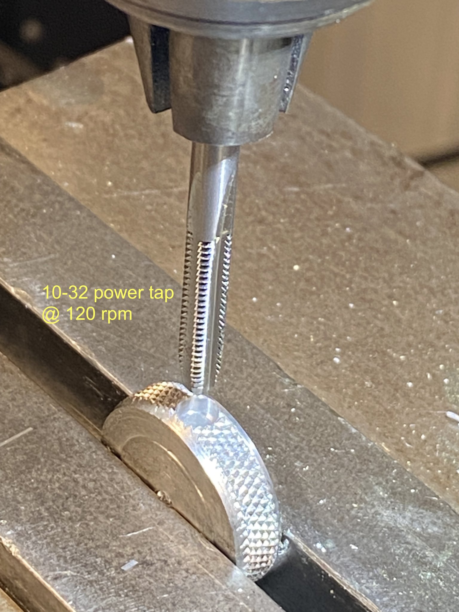

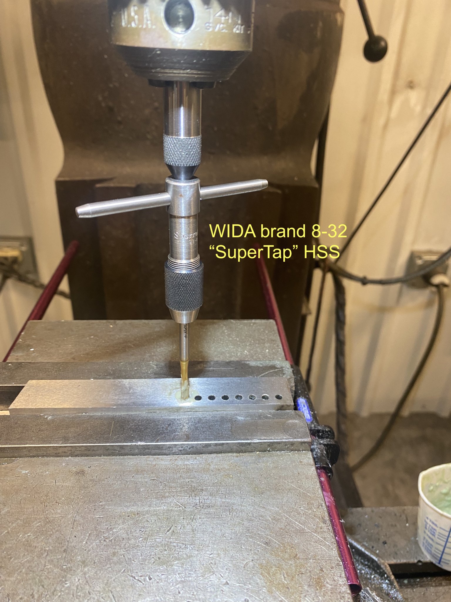

Tap depth control collets a separate fabrication.
IMG_9033LATHE TOOL BIT HOLDER AND SMALL TAP ALUMINUM ROUND DRIVER FABRICATED MJD 10.18.23A.jpg
IMG_9035LATHE TOOL BIT HOLDER AND SMALL TAP ALUMINUM ROUND DRIVER FABRICATED MJD 10.18.23.jpg
IMG_9043LATHE TOOL BIT HOLDER AND SMALL TAP ALUMINUM ROUND DRIVER FABRICATED MJD 10.18.23.jpg
IMG_9052LATHE TOOL BIT HOLDER AND SMALL TAP ALUMINUM ROUND DRIVER FABRICATED MJD 10.18.23.jpg
IMG_9059LATHE TOOL BIT HOLDER AND SMALL TAP ALUMINUM ROUND DRIVER FABRICATED MJD 10.18.23.jpg
IMG_9064LATHE TOOL BIT HOLDER AND SMALL TAP ALUMINUM ROUND DRIVER FABRICATED MJD 10.18.23.jpg
IMG_9065LATHE TOOL BIT HOLDER AND SMALL TAP ALUMINUM ROUND DRIVER FABRICATED MJD 10.18.23.jpg
IMG_9073LATHE TOOL BIT HOLDER AND SMALL TAP ALUMINUM ROUND DRIVER FABRICATED MJD 10.18.23.jpg

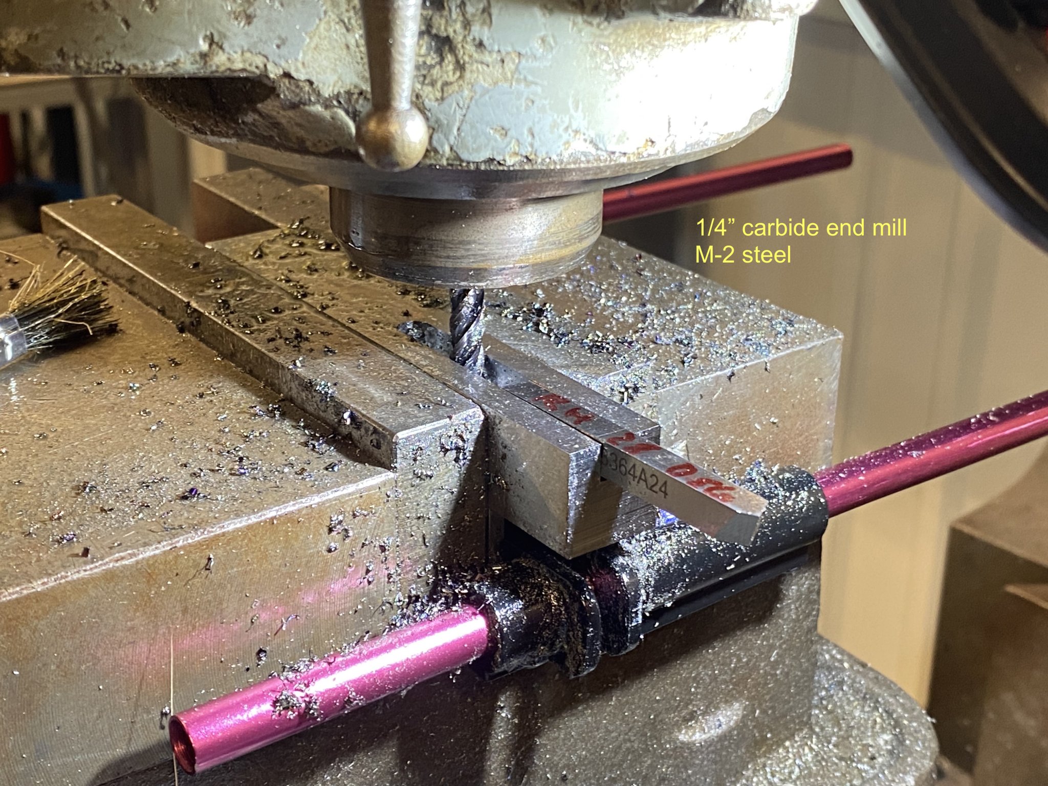

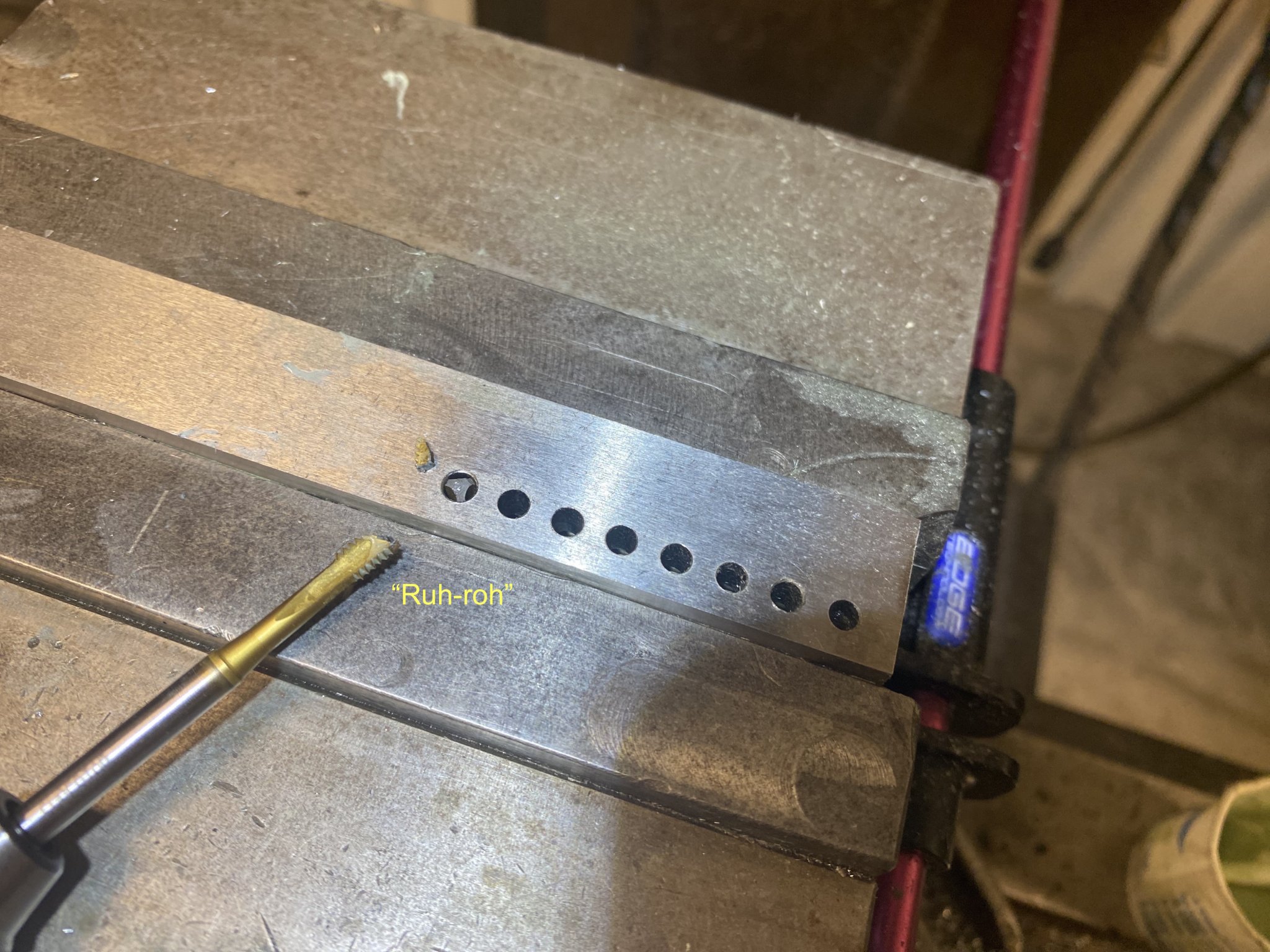

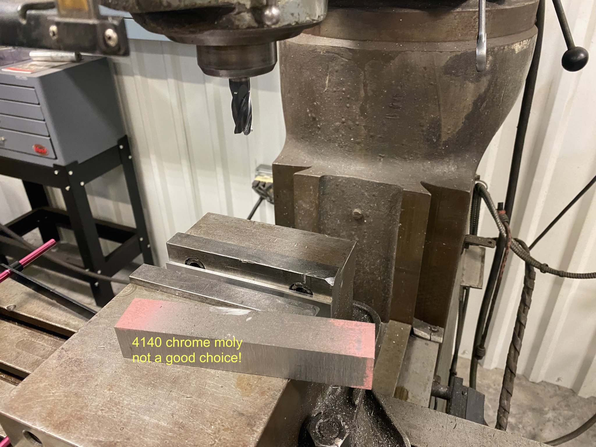

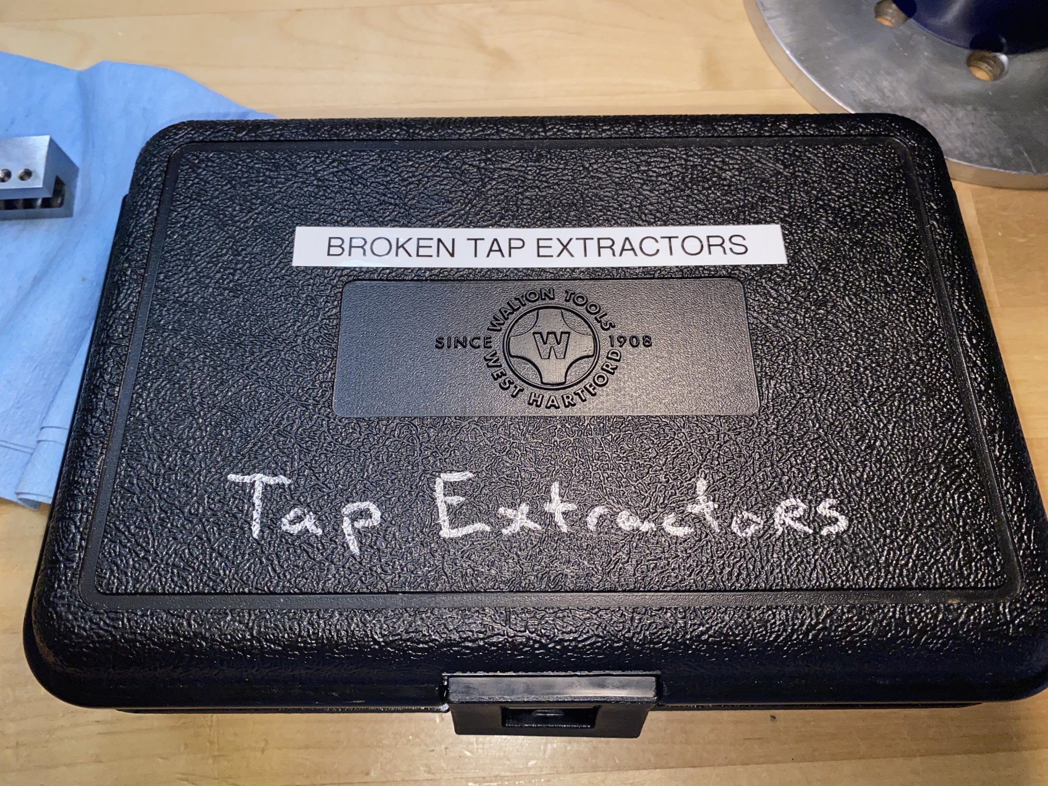

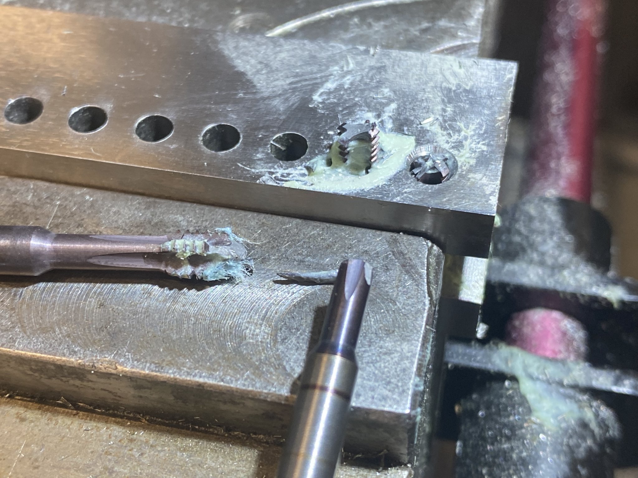

So, to McCameron's point: The brass fixture featured above is the second effort. First effort I attempted to use M-2 steel blank. Required carbide everything, drill bit$, chamfer$, tap$.....I have it 90 % completed except for threading the 8-32 holes, so far 2 solid carbide taps = $190 are now museum pieces. Apparently there is a roller coaster styled learning curve to power tapping M-2 steel on the mill with carbide taps. Attempts at hand tapping were laughable. FYI you will need a quality broken tap extractor $et.
So far this has been a $750 ( a semester of tuition at a CC or some long range ammo not purchased) home schooling lesson with no threads yet! Old adage Good Judgement comes from Experience; Experience often involves Bad Judgement.
