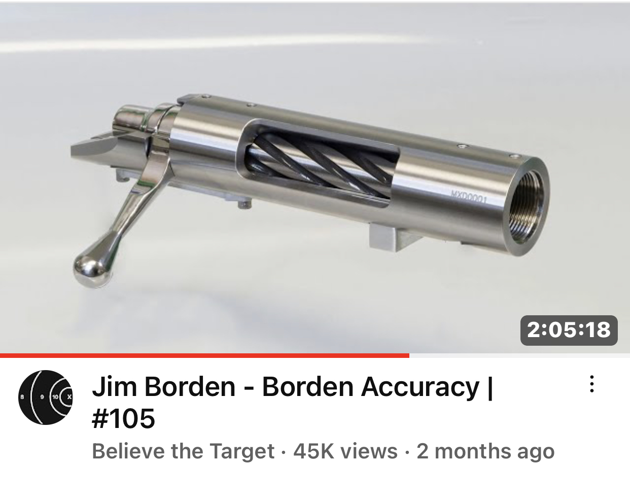

If you want the best repeater
Borden mountaineer . I shoot one in a MPA matrix pro chassis with a 308 bolt face. I can screw a 6ppc barrel on and shoot zeros. Yes it handles 6ppc. Screw a 6br barrel back on and and shoots more dots. Benchrest accuracy in a repeater. If you have time watch the Eric Cortina YouTube video
“Believe the target” - Jim Borden.
