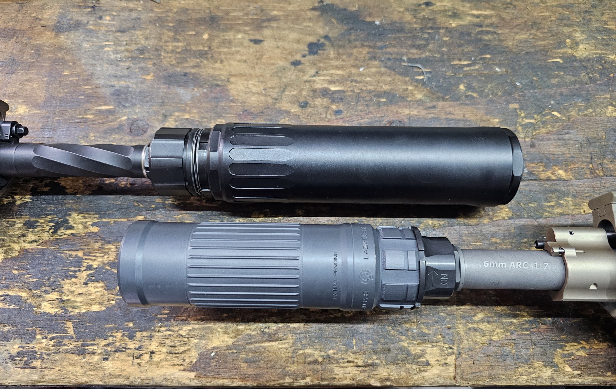

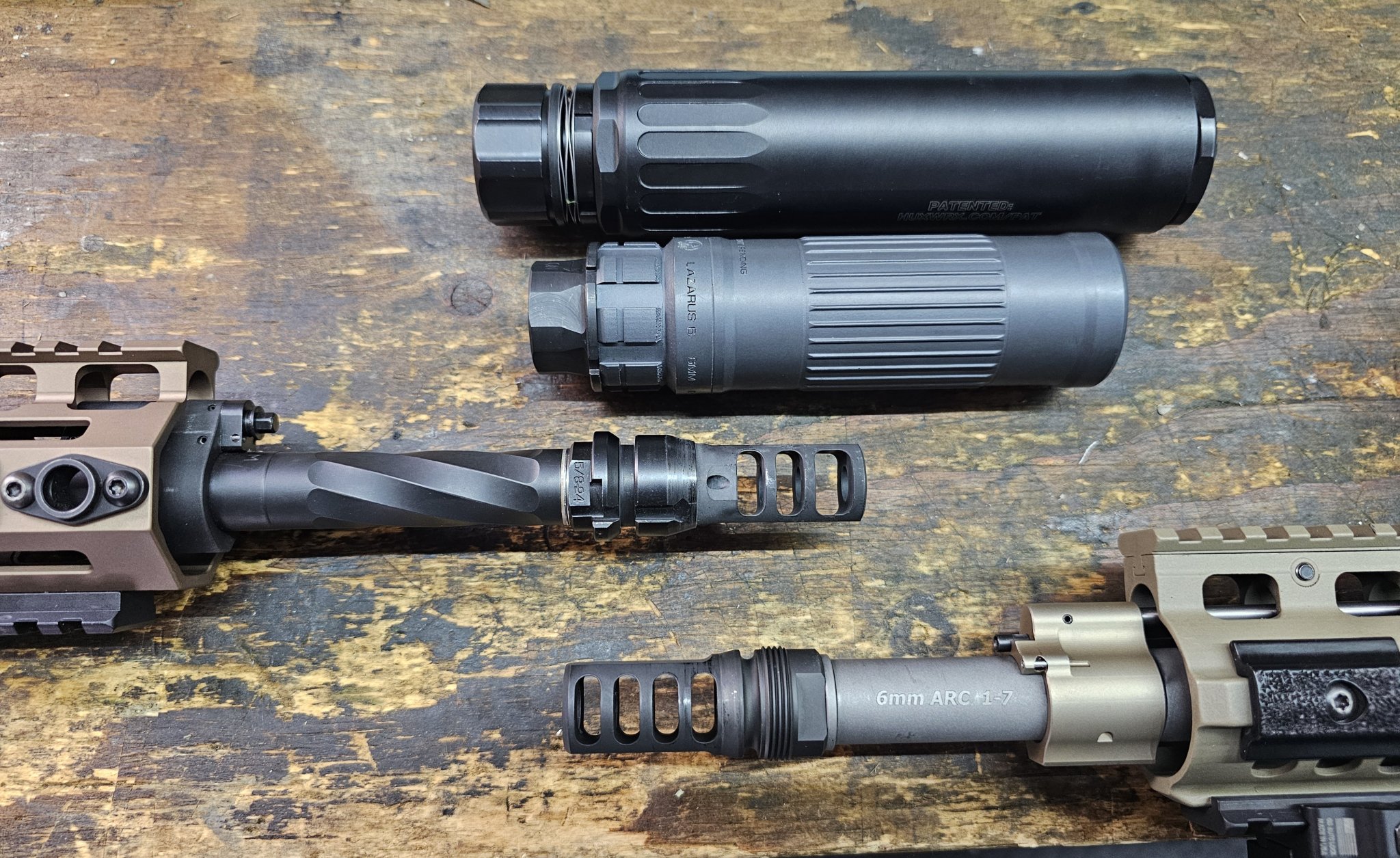

I haven't read through this entire thread so apologies if this has been mentioned.
Right now I have the HuxWrx Ventum with the Keymo Hub / Muzzle Brake and Deadair Lazarus with the Xeno Hub and Muzzle brake.
Ive probably put 800- 1000 rounds through both of them. What I've learnt is the Keymo is heavy, adds close to a 1lb IRC and doesn't like to stay tight unless I use a Strap wrench and adds close to 1.5" in overall length.
The Xeno Hub is the same weight as a direct thread but has a more limited option on Muzzle devises. The Xeno has NEVER loosened with it's left hand threads and I've also found a lightweight and effective four port Muzzle Brake that has more recoil reduction than the Dead Air Keymo Muzzle Brake.
The Xeno MB is made by LMT Advanced Technologies. I will be switching all of my Keymo over to Xeno.
View attachment 8540517View attachment 8540518
Yup, Keymo is a thing of the past. Tapers are where it’s at.
