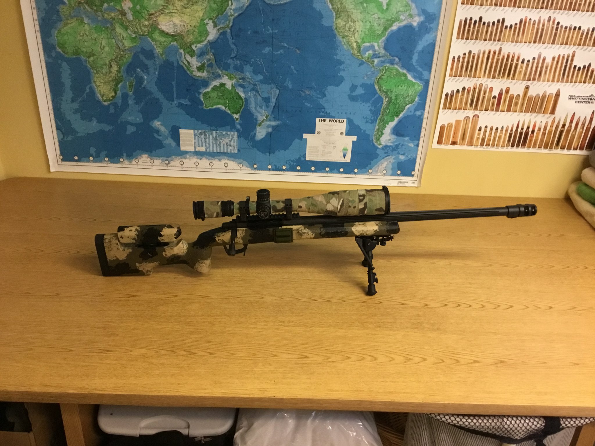

This 300 Win Mag loves 200gr ELD-X. It also loves to be out west, though the next time it gets on a plane it will be to Canadia (exactly 100 days from now, but who's counting?)
If I need to shoot in less light with it than I already have then I'll need to attach a PVS 30
What more can be said about NF turrets?
Quality of build and warranty... again, it's NF

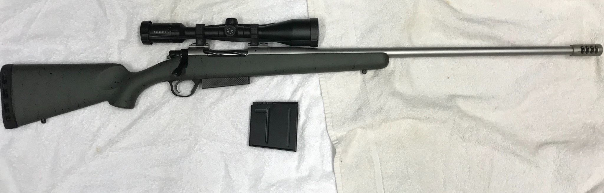

Christensen SS Classic in 338LM, 7.5 lbs plus scope/ammo
