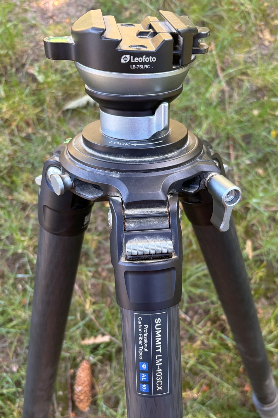

This is the one that had the tac table on it. The other one was an SO “x” inverted with an inverted ballhead.

If you’re not packing this around the mountains, you’ll want the largest diameter legs and the biggest bowl apex they offer for the best stability.
