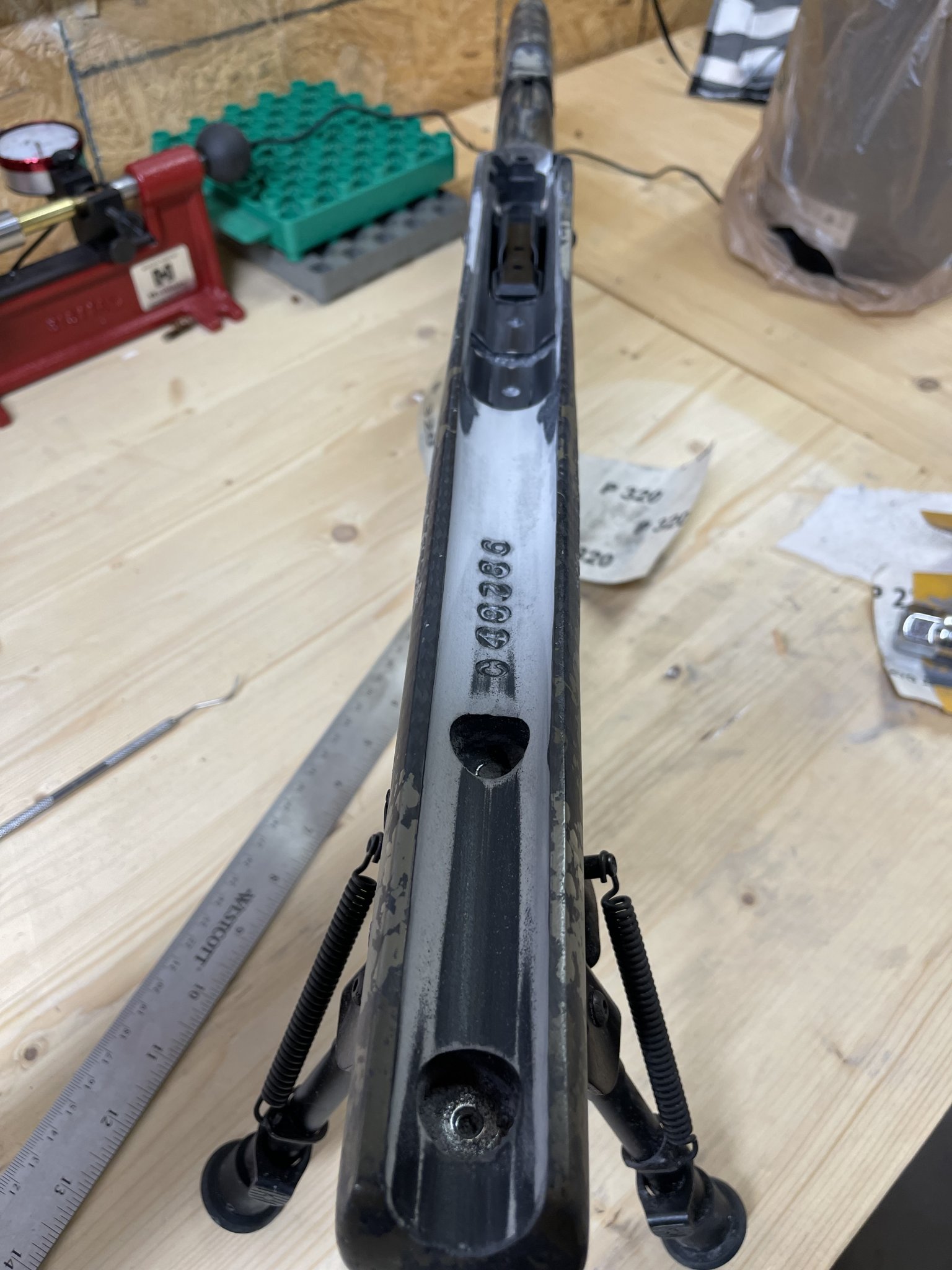

Takes about 5 minutes with some sand paper and that LRH stock will fit the proof bull. You can get a wood dowel rod, or just use the barrel itself. Just use some cardboard paper or even thin layer of plastic over the barrel and then the sheet of sand paper. Takes just minutes to open the channel up. No point in sending it back for that, unless something else is wrong on the stock. I just did one on my XM Defiance with a 1.20 carbon Bull 300wsm. Came out perfect. Haven't tried a 1.25.
I use a deep socket of the appropriate size and sandpaper. If you need it to look good tape it off and paint it your color of choice when done. This is a Manners
I’ve had to open up / straighten most if not all of my manners stocks as of late, just wasn’t sure if they was enough meat on the sides for the 1.25” with a LRH. I have 2, but both are running M24 barrels.

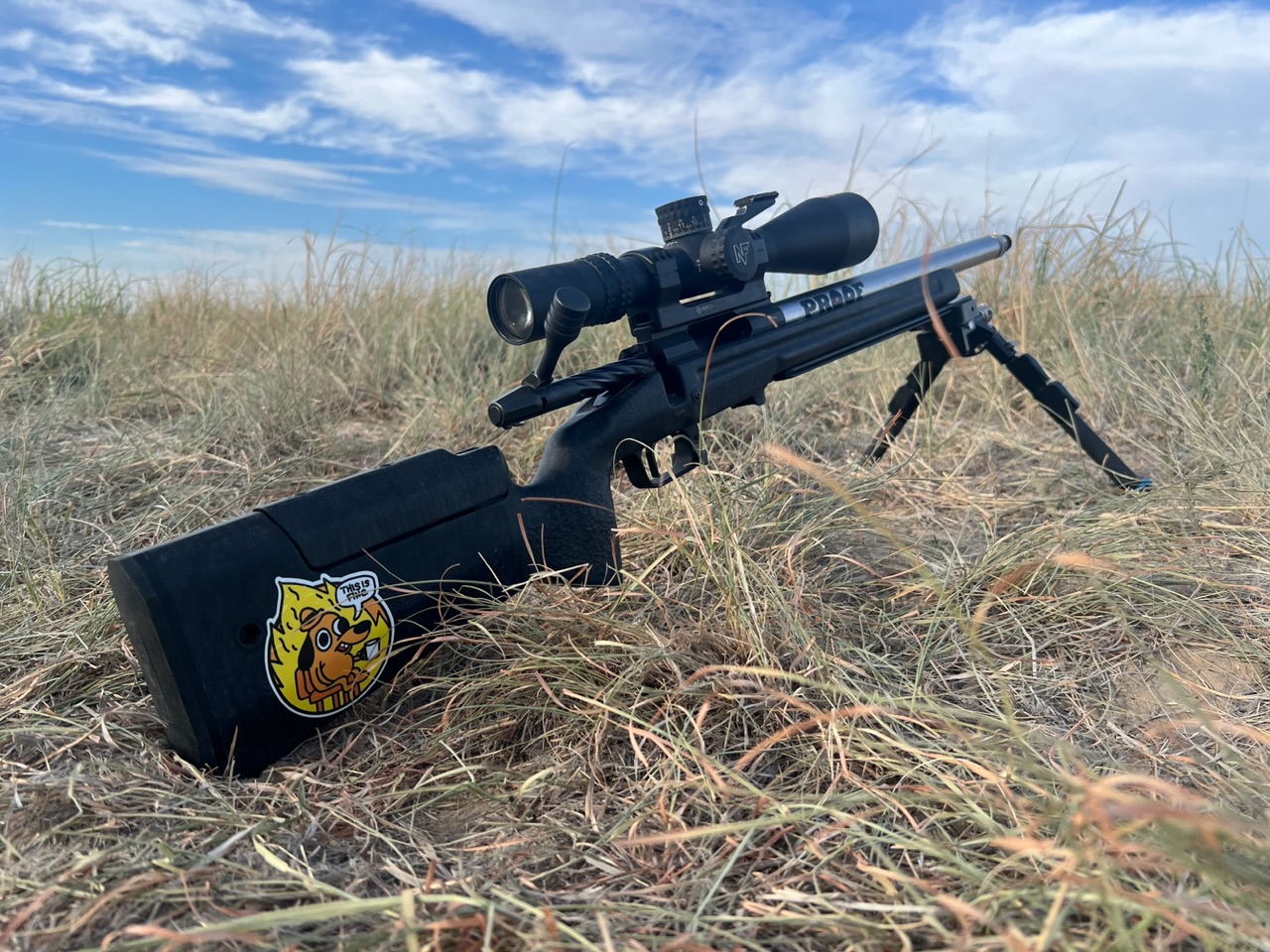

I have a proof sendero in an EH1.
Looks good. Shoots amazing.

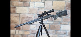

If using a proof, those carbon bulls are only 7oz heavier then the sendero. This AntiX XM balances really well with Dominus K SR and the S&B US on it.
