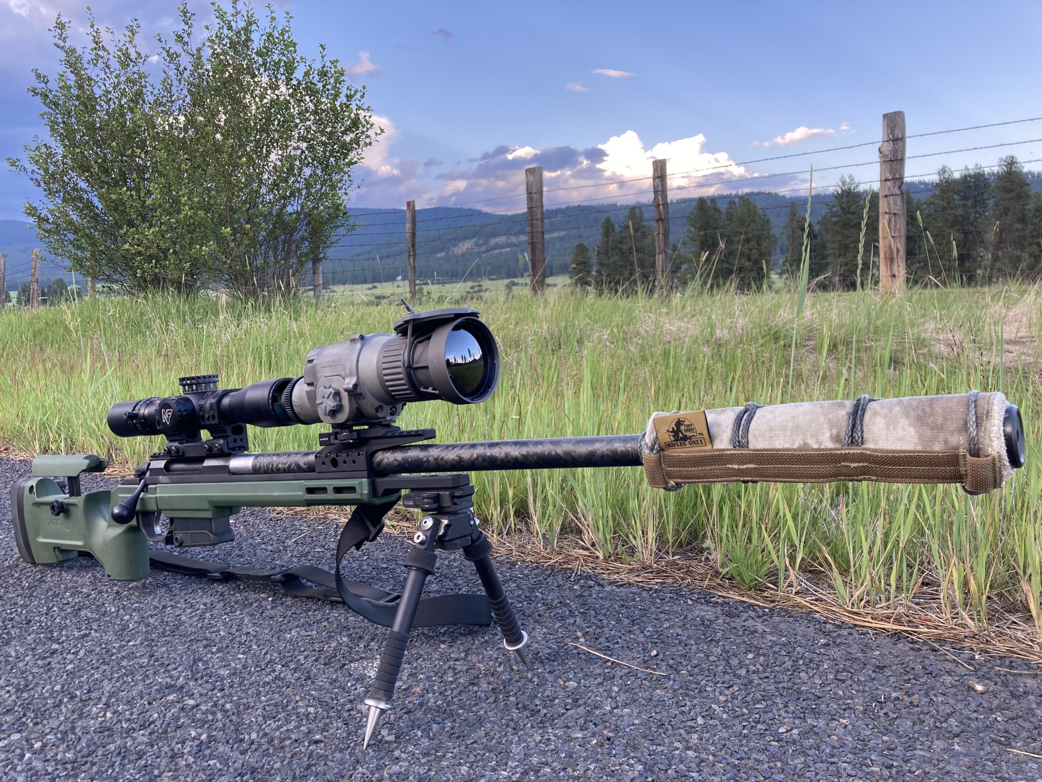

... What about the LWTS-LR? ...
Great unit - prism collimated. Together with the UTCs .. the LWTS-LR are among the very few prism collimated thermal clipons we can (almost) buy, :)

... How well does it work as a stand alone? ...
(assumption = "it" = LWTS-LR)
As a stand alone, the LWTS-LR is even better - image wise than as a clipon. Clipon mode applies a 0.5x magnification to the unit, thus decreasing resolution. Standalone mode give full resolution.
Stand alone mode has several BDC reticles, but no mil reticles. If you want to hold with your day scope reticle, then clipon mode required.
Reactions: SkyScrapin
I always wondered how they worked well as both. Makes sens they put it in .5 for clip on.
... I always wondered how they worked well as both. Makes sens they put it in .5 for clip on ...
The rear end demagnification on the UTCs are via optical lens ... whereas many other clipons use software demagnification. That's one of the big pluses for the UTC ... BUTTT ... also one of the reasons the UTC is more costly.
