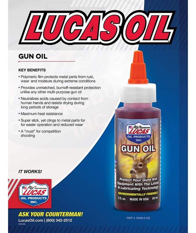

I've been using this for hunting since it's scent free, and now use it on my AR/SBR and it's been holding up well.

Been using MPRO-7 for years in all weather conditions without issue.
I second this. I really like this lube. Our PR club got a couple of cases of the Lucas Oils (car racing Lucas Oil) gun lube. I have been having excellent results with it as well.
