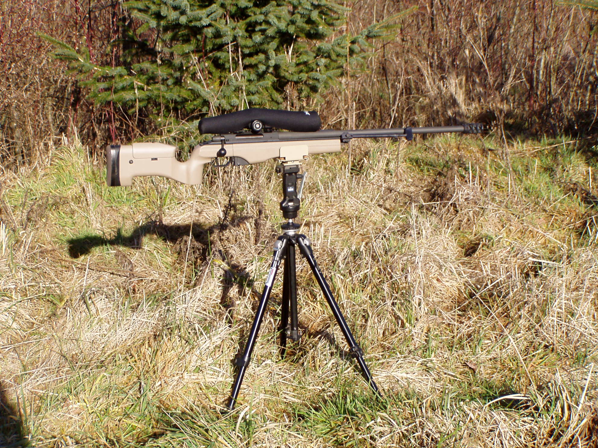

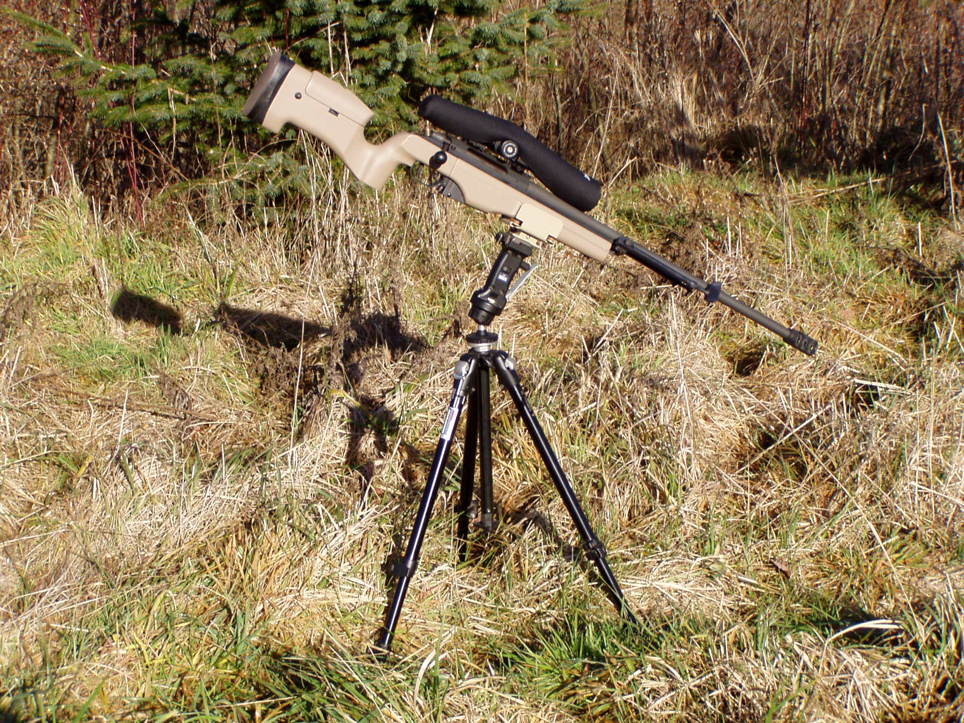

PIG, 3001BD, 3265 head
The PIG arrived. The rifle pictured is a TRG42 with a weight of about 15#. With the the rifle locked in at it's balance point, the setup holds the rifle securely in the horizontal or near vertical position but not in between.

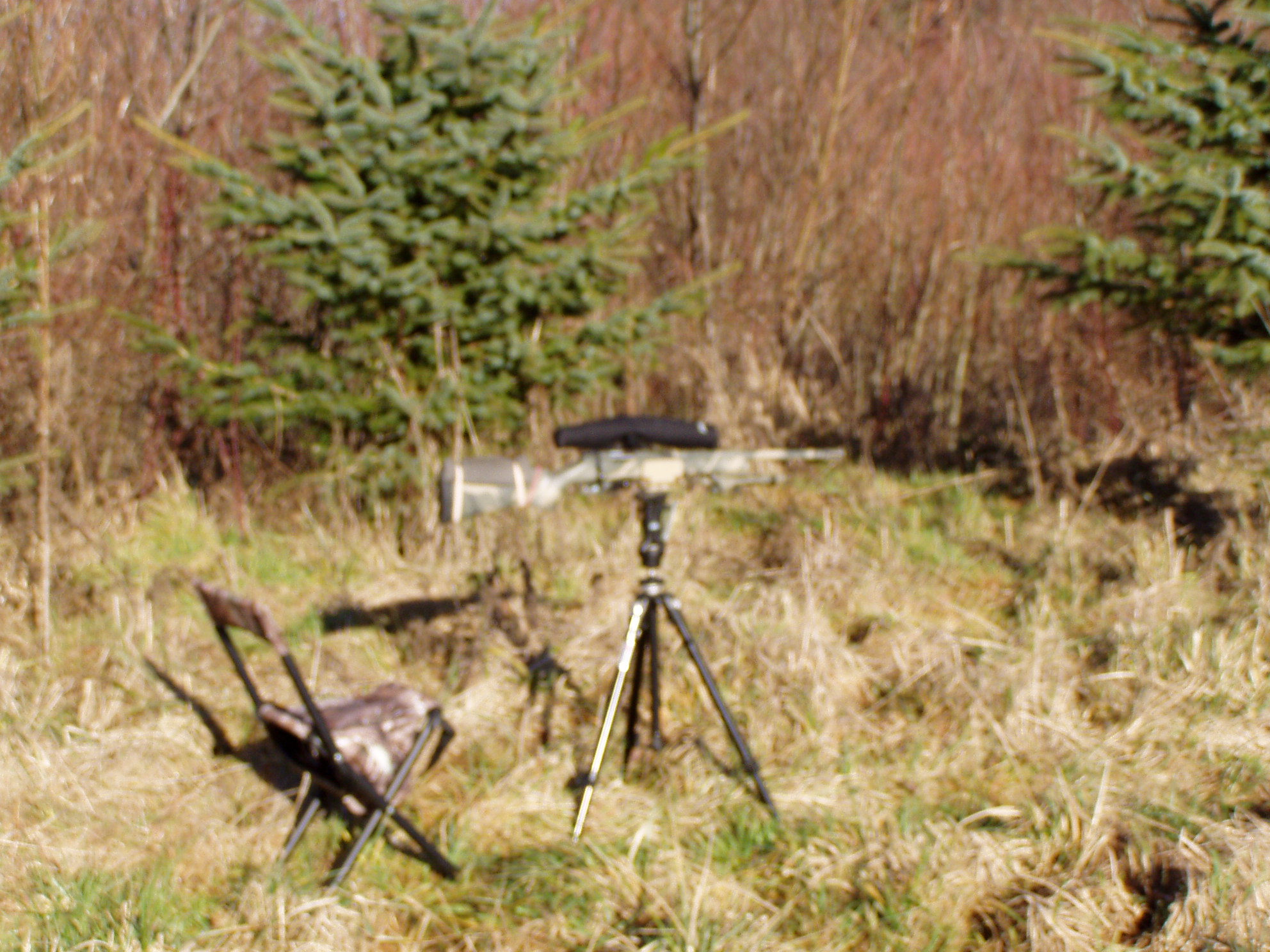

I apologize for the picture of the CZ527 with the dove stool but this is my walking rock chuck rig. Off a rickety table with a Harris and rear bag this is a 1/2" rifle. With the PIG I'm shooting an inch with little change of POI between the the bipod and the PIG. With some work on technique, I think I can hold in the .7s. The PIG will allow me the use binoculars and or LRFs while being able to quickly acquire the target.
