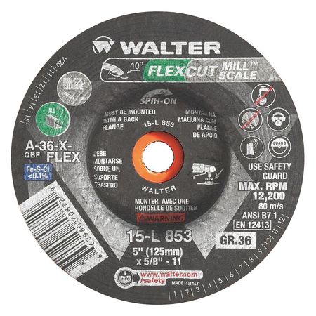

This is also a great tool to remove mill scale from steel
Speaking of mill scale removal, these are the best I have used,
