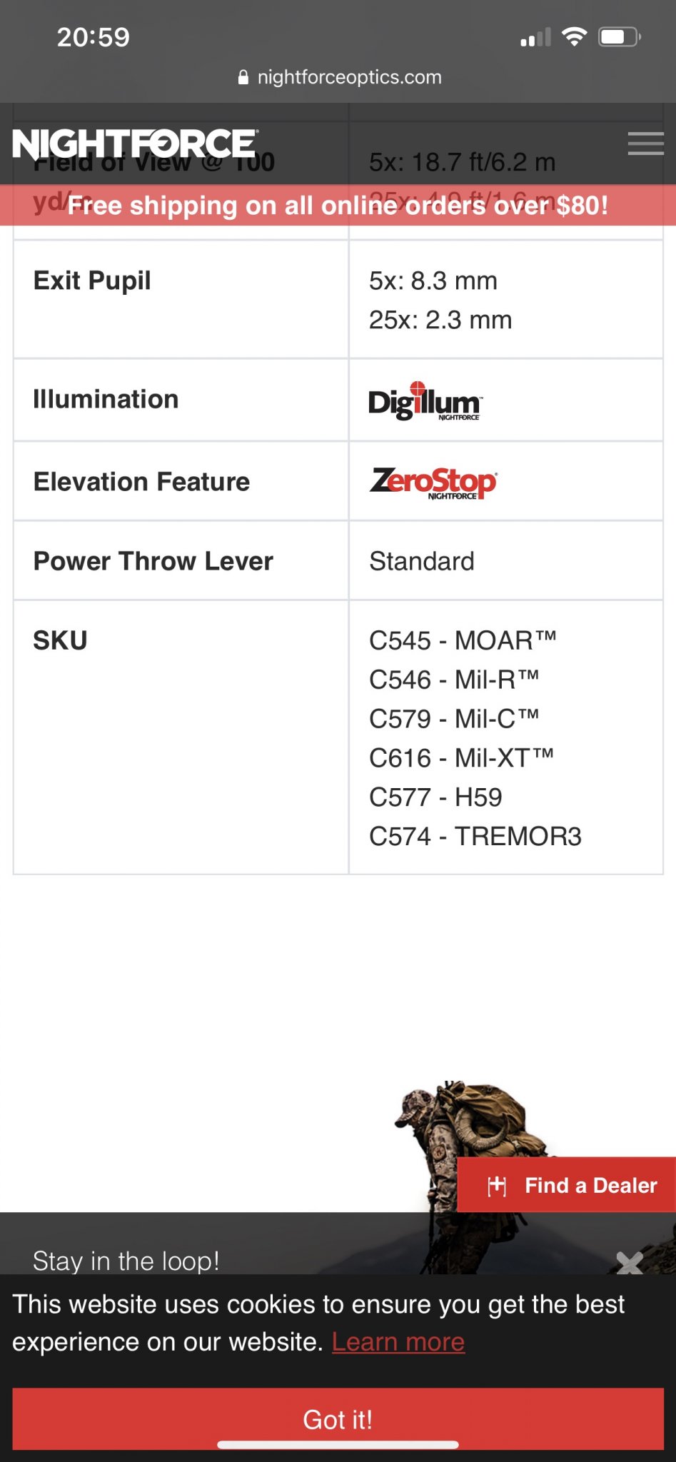

made talking having a new reticle Put in your NF or a whole new optic? If new SKMR 3 or 4. Not to cluttered but still has small wind hold stuff built in.

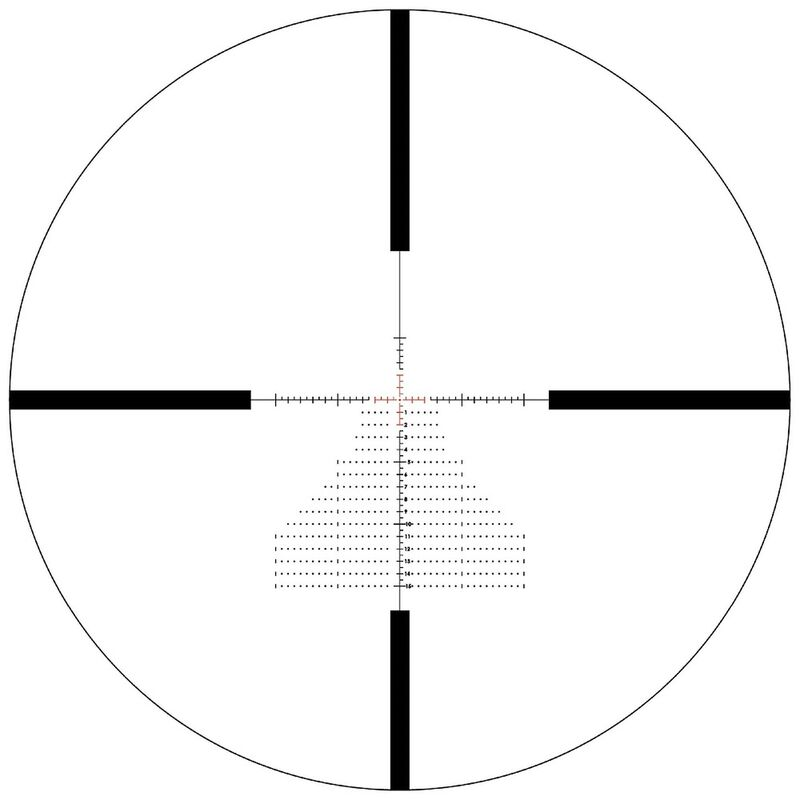

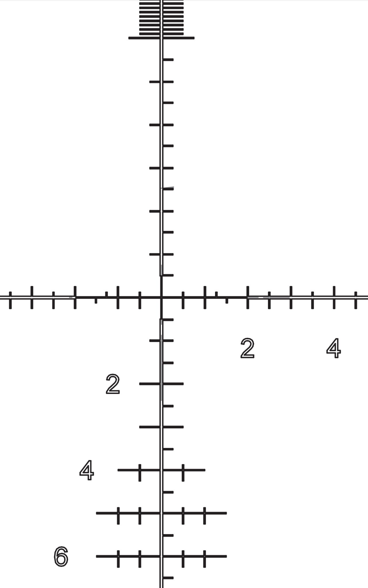

Bushnell G3. The illuminated versions of both the 3-12 and 4.5-18 LRTS have .06 mrad thick cross hairs which are I appreciate in a hunting scope. The illumination is done excellently also which should help that much more if you're using often in low light scenarios
Reactions: browning442
The Bushnell G3 is very nice. See attached pic for a DMRII with Illum G3. You should have no problem trading off that H59 for a MIL-R or MIL-C if you want to stick with NF. The NF MIL-XT might also be too busy for your eyes and purpose.

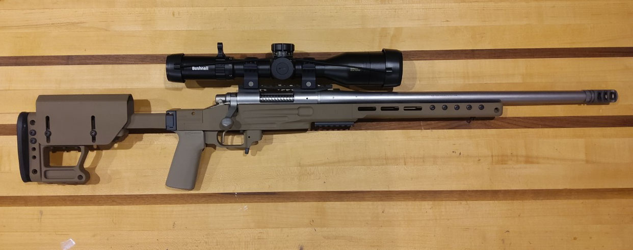

I hunt with the exact same scope you have, with a Mil-C. No complaints. I’ve tried lots of optics and keep on ending back up on the 4-16x42 for practical field use. $2k-ish for a gently used one. I don’t think it gets any better until you can afford a $3k+ ZCO , etc.

Thanks everybody, I appreciate all the great info and replies. I’m leaning hard toward another ATACR with the mil-R reticle. I’ll probably stick with the 4x16 magnification, I’m afraid anything over 20 would limit my field of view too much for shots under 500 or so
Are you looking at SFP scopes?
With FFP you can always dial back the magnification and the reticle will still be accurate.
The Leupold Mark 5hd in TMR would be worth a look for a FFP hunting scope.
