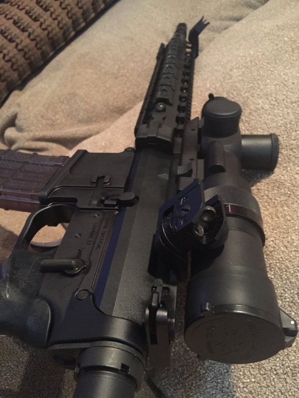

The 4616 is a cantilevered design which allows you to push the optic a little further forward for better positioning on an AR10. It also comes with a built in 20 MOA cant so you get more usable travel from the optic's erector.
I do understand you said QD but I don't really need QD as every stick has a dedicated optic. I had this mount and a Khales 6-24 mounted on my MR762 when I owned that rifle. The mount and optic is now mounted on a different AR10.
Spurs are a lot of $$$ but having an MR762 is also a lot of $$$. The mount is built as well as the rifle. It exudes engineering quality and they are by far the best mounts I have ever used. All of my AR rifles use Spuhr
The 4616 would be an excellent choice. The Bobro would be an great choice for QD, and I know you have a heavier scope if you are looking for a lightweight mount the Nightforce would be something to look at.
When I set up rifles for example a DMR setup I like to do a fixed mount and offset 1 o'clock or 45 degree irons or a RMR or an micor sight. I find shooting this setup to be very natural and intuitive.
If quick-detach is the deciding factor then Bobro is the option you need to look at. Otherwise, the Spuhr is fantastic. Finally, since it is a fine piece of German engineering, you could take a look at Era-Tac/Recknagel mounts as well.
