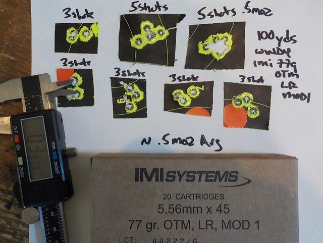

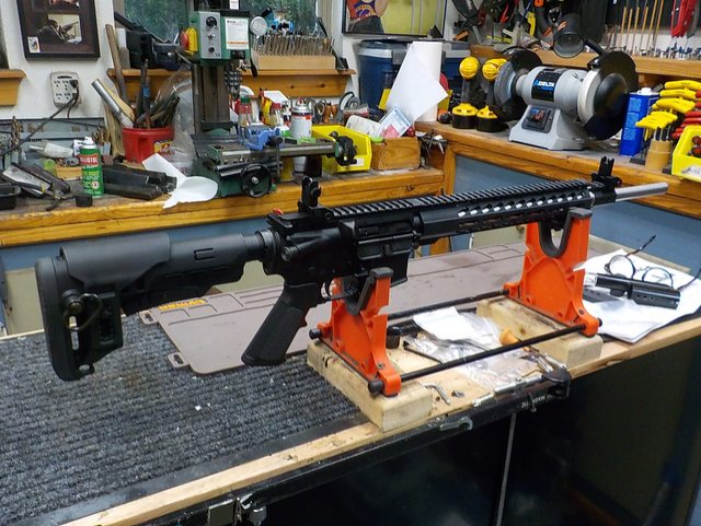

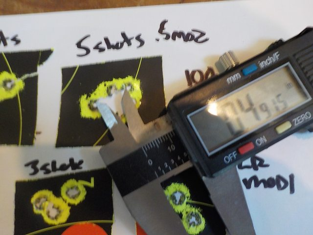

Just built an AR with a White Oak SS Match, 1: 8 , Wylde Chamber. Getting .5 moa 5 shot groups and several .375 3 shot groups with the very first rounds through the barrel. Excellent for the money...around $250.
I'm sorry but what in the actual FUCK! are we looking at here??? Did you really cherry pick random three and five shot groups and then average them like they are from the same target 😂
Maser.... Is that you?
I'm sorry but what in the actual fuck are we looking at here??? Did you really cherry pick random three and five shot groups and then average them like they are from the same target 😂
Isn't that how it works? Between what I see on the forums and Facebook, I can't believe that more records haven't been broken😁
Dude seriously!?..lol I'm about ready to go out and get all my old targets have some Arts and Crafts time and come back as a God amongst these forums.
It was sarcasm. These people that hand pick their groups then claim they are 1/4 moa shooters or better with factory rifles is comical. Just like the ones that claim they can beat the record for the long distance record but if you watch their scores at a match, they barely score any points for the entire match. It's always easier when you go out of a morning when conditions are nearly perfect.
I’m 100% guilty of this in that I only “count” days when conditions are great and I’m shooting well.
However...
I don’t think that’s the worst thing when I’m trying to narrow variables down for evaluating gear. My best and my worst barrels are 4 moa on bad days; only the goodies are sub 1 on perfect days.
Perhaps @buffalowinter has found, as I have, that fullsize targets- as shot on the range- don't store worth a fuck, and cutting them up to put in a notebook is a much more efficient use of space. And, it makes record keeping easier. I doubt he went out and shot a target in order to answer a Q on the internet, but probably had those groups in his records. Even I can tell that they were all shot on the same style shoot n see target, s ill give him the benefit of the doubt that they were shot on the same outing. For fucks sake, there's no proof that any target shown on the inter web was shot at the reported distance, but we usually give people plenty of slack. Unless they're shooting pretty darned good ammo... Hell, this ain't even the 6x5 thread.
Off course I cherry picked the targets. The OP asked for a barrel recommendation, not a display of my marksmanship abilities...or lack there-of. I'm showing what the barrel can do, not what I can do. All the groups were shot last week, on the same day, within an hour. It was part of barrel break-in for the gun shown which I had just built. Were there some looser groups...of course, but that was me not the barrel. It never even occurred to me that by cherry-picked you meant I "cheated". Hell, the groups aren't even that good, especially compared to a good bolt gun.
