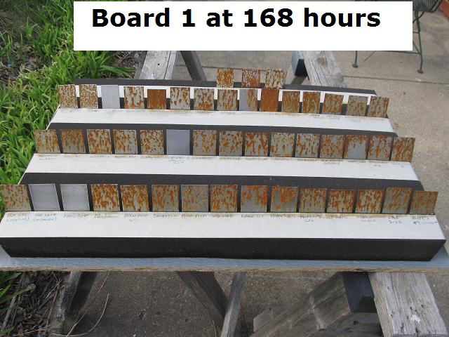

Rust preventative choices. Corrosion-X, sprays on, easy to apply, kills any existing rust, lasts pretty well. Renaissance wax, harder to apply, but VERY long lasting protection even against salt water spray.
Most oils are actually pretty bad unless the surface is kept visibly wet, which causes it's own host of issues.
Many tests have been done, of the oils Mobile One or other synthetic is probably best.
Reactions: 6.5SH

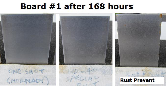

Hornady One-Shot is one of the better products at preventing rust and leaving a very slick/good dry lubrication.
COMPREHENSIVE CORROSION TEST: 46 PRODUCTS COMPARED
