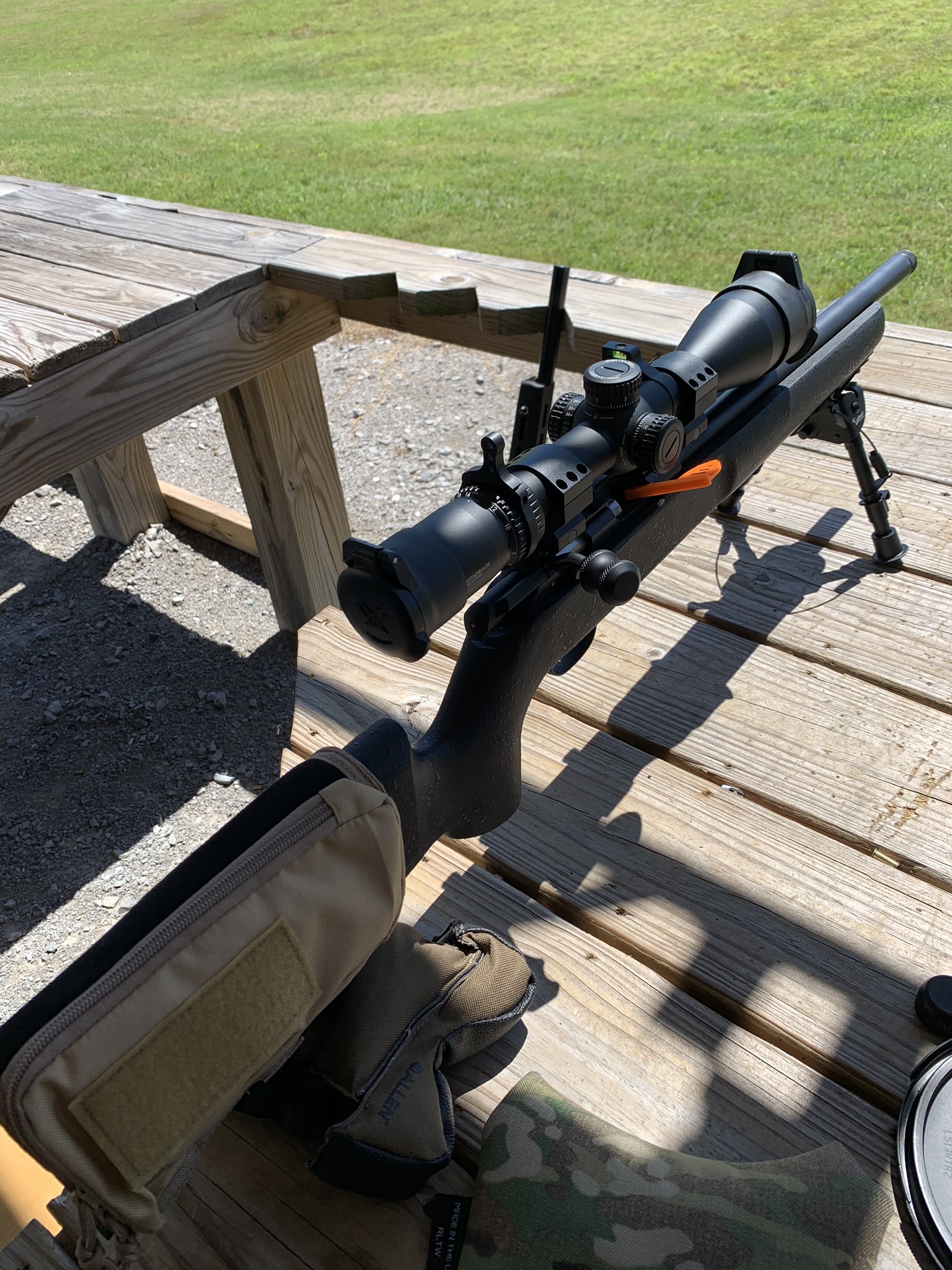

I just got a CZ 457 ProVarmint for NRL22 base class. Haven't taken it to a match yet but so far setting it up I have zero complaints. The stock is a Boyds ProVarmint, the action was a hair loose from the factory as I noticed the barrel had a little side to side movement, checked torque on the action screws (CZ-USA recommends 25in-lbs to 30in-lbs from what I've read) and it tightened right up. Unfortunately for base class you cannot replace or modify the stock so for that reason I chose the CZ.

I just got a CZ 457 ProVarmint for NRL22 base class. Haven't taken it to a match yet but so far setting it up I have zero complaints. The stock is a Boyds ProVarmint, the action was a hair loose from the factory as I noticed the barrel had a little side to side movement, checked torque on the action screws (CZ-USA recommends 25in-lbs to 30in-lbs from what I've read) and it tightened right up. Unfortunately for base class you cannot replace or modify the stock so for that reason I chose the CZ.View attachment 7226530
You can make mods to get a correct cheek height and should. 22lr can be finicky about parallax error.

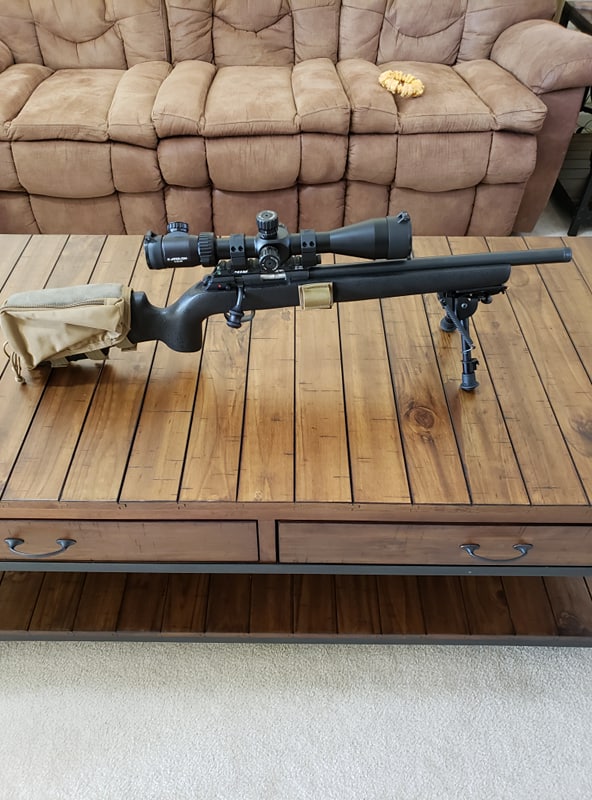

I just went through this, wanting to have a base class rifle in hopes of shooting open and base at local matches. I don't care about the Base score as much as just wanting to shoot more in each match.
I had a hard time deciding between the 457 Pro Varmint and the Tikka, but ended up going with the CZ. I mainly chose the CZ due to the stock and the fact that I already had a lot of CZ 10 round magazines for my 452's and 455's.
You will lovethe CZ. Here are a couple suggestions. BSCAR rail. Check into Area 419 bolt knobs. I didn’t like the little ball that came on it. Also Add a cheek pack on it to raise the height. This a great one for about $35. The pouch is great for the bolt, spare mags, etc.
I second all of that, I went with the Area 419 rail (30moa) and most places if you buy the 419 rail, they give you a few bucks off the bolt knob (it was either $5 or $10, I can't remember and then I went with a stock pack from Triad Tactical but that's just personal preference.
