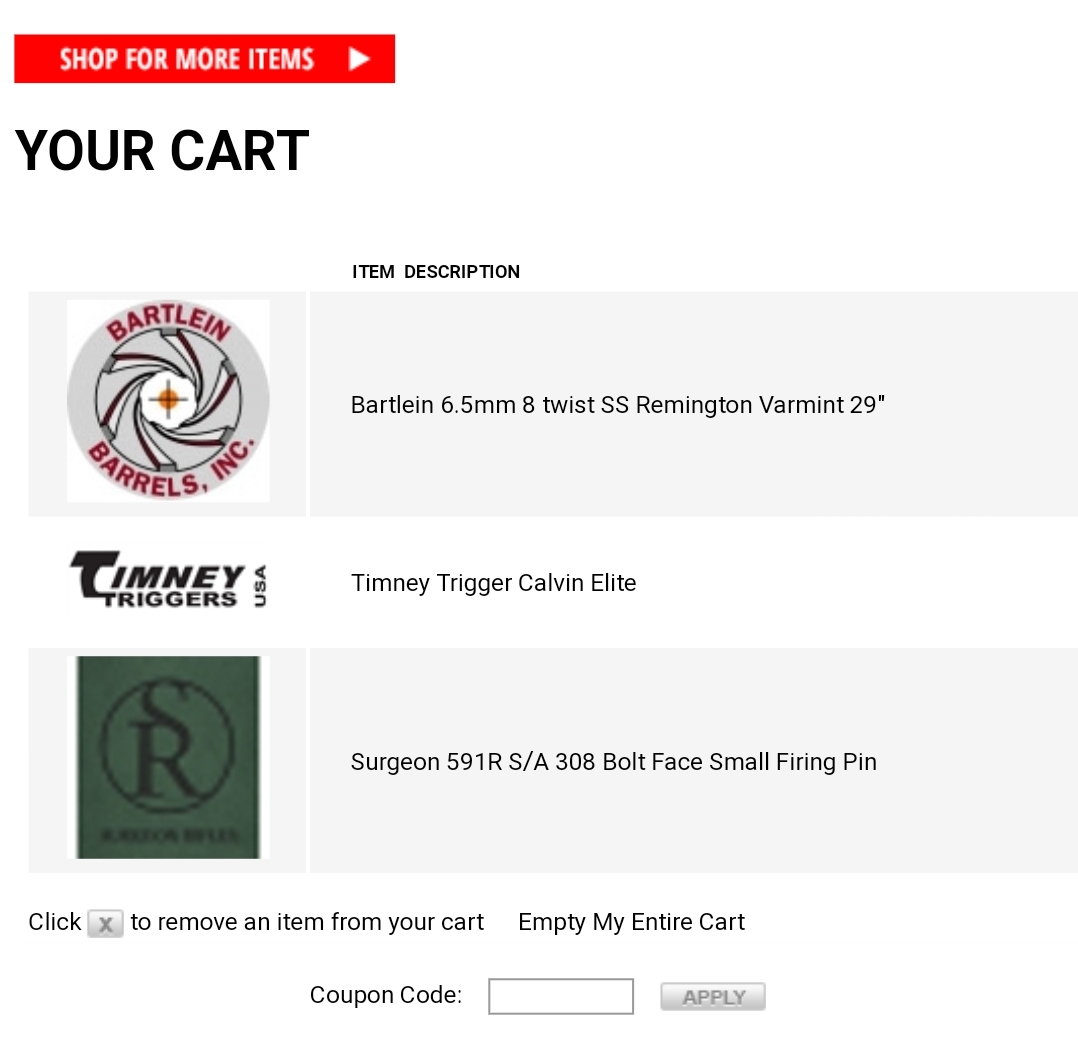

Sorry I'm new at this custom rifle stuff. So this is what I'm looking to order:
After I receive these parts then I would send all to a gunsmith to cut, crown, thread, chamber and install in the action?
Yes, OR vvv
it's already there. they can be the gunsmith too...
Go ahead and call them up, explain your question. Im sure they would be more than glad to explain the whole process to you. "Its sort of their thing" Both distributing as well as working on. Or you can send it all to any smith you care to. It seems you have nothing but open possibilities at this point.
Also, from the surgeon action in your cart: I thought this was for an action you already have you are wanting to rebarrel, or are you wanting to build a whole new rifle?
Yes, OR vvv
Now I'm thinking just having a whole new barreled action. Is that Surgeon a good action?

so you do from getting a prefit, to a full custom with a surgeon, but don't know anything about it?
i'd second the nucleus or origin in this case.
I don't want to have to wait months for an action which is why I'm not going with the nucleus. Yes I'm new at this and haven't owned a Surgeon action before and this will be my first time getting custom parts to have assembled. All the rifles I have purchased with custom parts have already been assembled and were used aside from new factory rifles.
