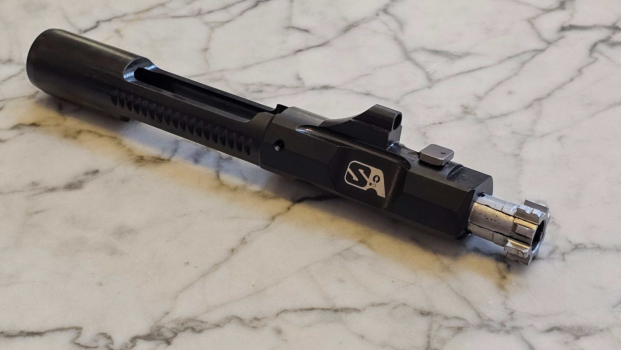

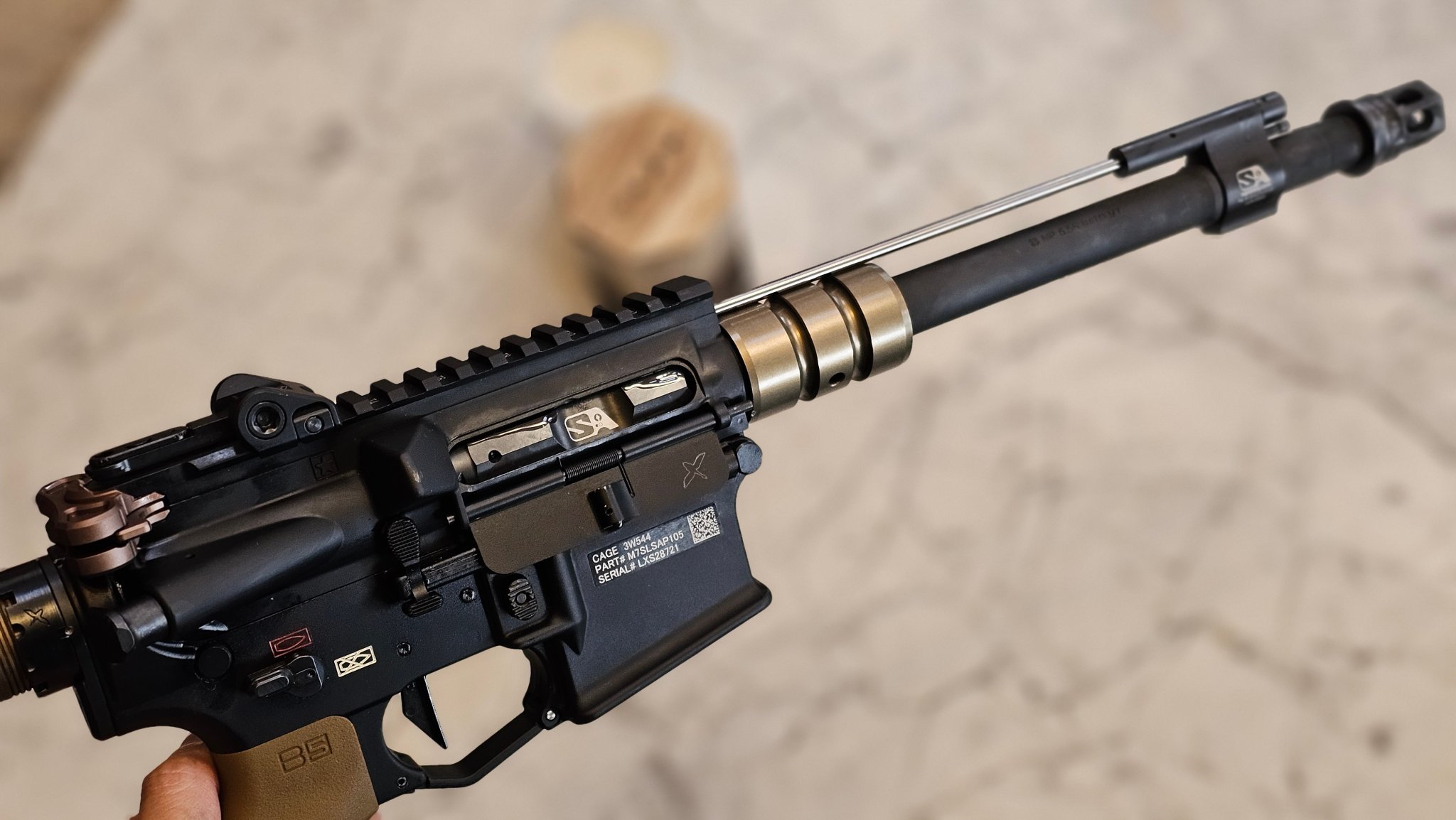

    Piston system with a venting gas block and a longer buffer system like the BCM or VLTOR. You don't make it all dissappear but it seriously cuts down on what ends up in the reciever. Gas buster CH's are a bandaid.
    The name of the game is to slow things down, vent whatever gas you can from entering the chamber, and increase unlock time for the bolt.
    My most recent build runs a SA Piston kit with LMT enhanced Bolt and a BCM buffer system.

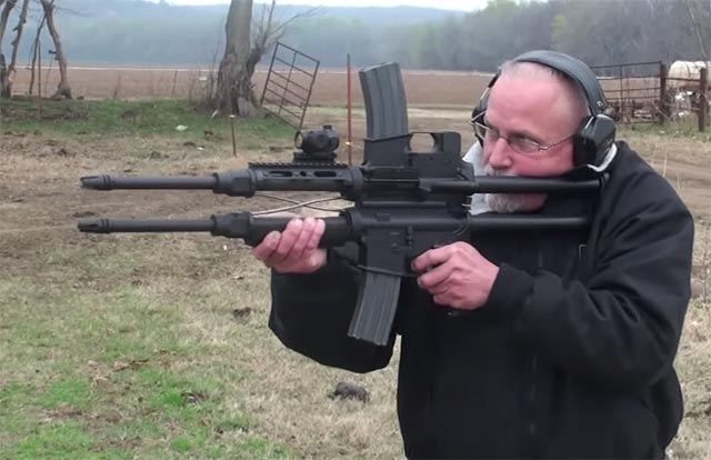

    There is also this Tromix select fire build with crossed gas tubes. It inadvertently showed how residual bore pressure can directly affect BCG travel after the bolt unlocks, as the gas ports had to be opened up before it would function (the individual weapons functioned properly in their original form).
    1692151599962-jpeg.8205818
    If it is so common, care to provide a link to this information?
