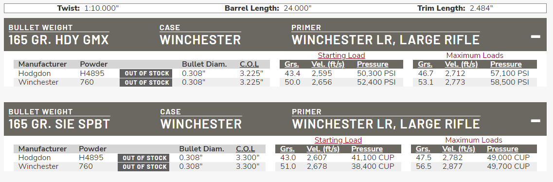

Rathmatik Sergeant of the Hide Full Member Minuteman Jan 6, 2020 418 97 KCMO Feb 23, 2022 #2 Feb 23, 2022 #2 I've had good luck with H4895 and WIN 760. Hodgdon has data for both on their site for 165gr bullets:
Mooseknuckles Major Hide Member Full Member Minuteman Jan 11, 2014 1,490 4,849 Feb 23, 2022 #3 Feb 23, 2022 #3 H4350 and imr4350 are great powders for 30-06, also could try Varget and imr4064. Reactions: Ravenworks
