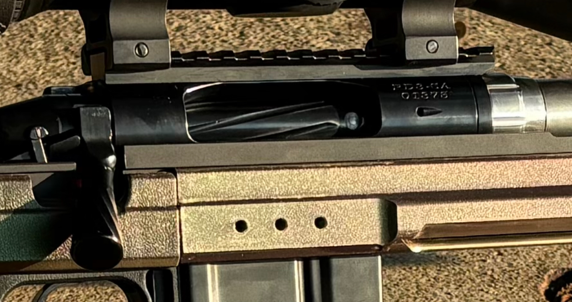

Nice looking build!
Yeah the barrel nut approach could also help in SHTF scenario (easier to make barrels that use nuts vs shouldered barrels) which is something Im slightly factoring into my HMR type build —> going with 308 instead of 6.5 creed, prc, etc bc of barrel life/ammo & brass availability, using a chassis (LSS XL carbine) that is all metal & has cross over to some of my AR lower parts, etc..

Nice looking build!
