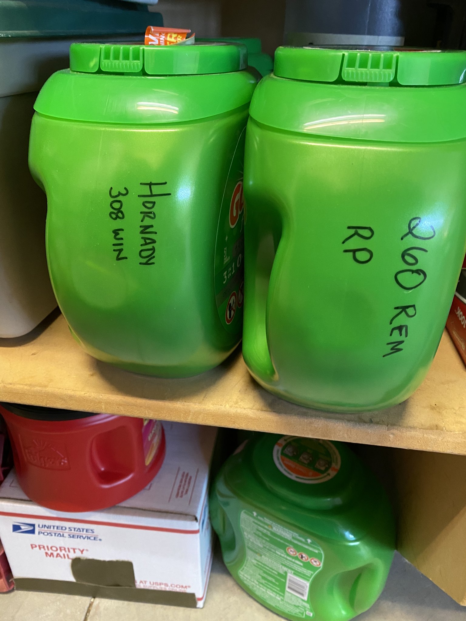

    It's quite simple, however, at times I question if the batch that I'm holding has 2x or 3x firings; hence the question. I'm repurposing empty Gain laundry pod containers. This is due to a family of five with three children all under the age of 9. We do roughly 3 to 5 loads of laundry a day! So I take them and simply write with a sharpie the case manufacturer and caliber on the side. Inside, I use gallon zip lock bags (I know, cheap) with 1, 2, 3, etc etched on the side to separate the brass by the number of firings. Then they are smartly organized on a shelf in my reloading area.

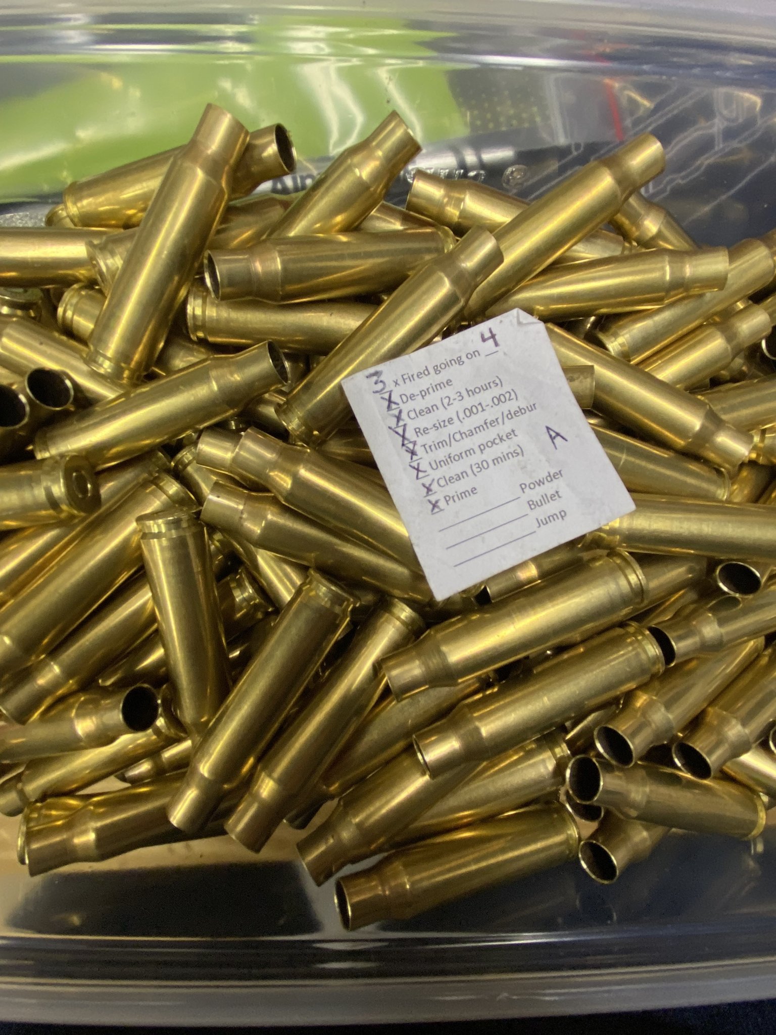

    I made these after I learned this from someone at a shooting class. These little papers stay with the brass at all times and I can make extra papers to go in each loaded MTM case. Once they are shot, the brass and the paper gets put into a ziplock bag and stored for when I am ready to reload the whole batch again.
    The papers also make it really easy to remember what step of the reloading process I am on, as the paper follows the brass through the entire process.

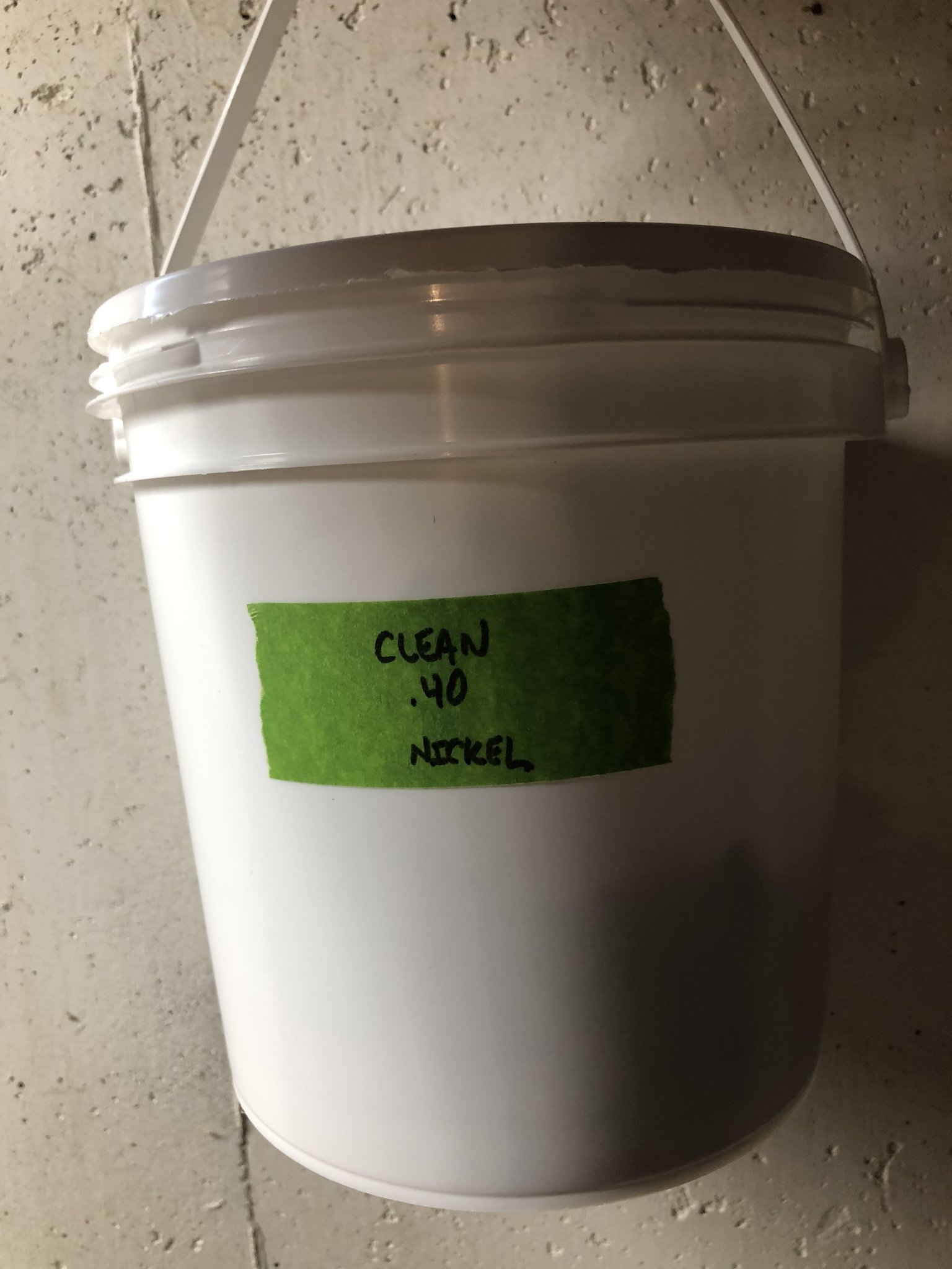

    A family friend runs a local orchard. They “make” caramels and fudges, and the caramel comes to them in white 1 gallon buckets with snap on lids. I grab a few buckets every year and sort my ever-growing brass stash into different processing stages, # of firings, and I also separate pistol brass into nickel and brass batches. I mark the processing step, caliber, rifle brass # of firings, and nickel/brass onto Frog Tape for ease of changing the buckets around when I finish up with a batch.
    Now that is an excellent idea!
    Thank you, I'll be adding these into my process!
    Definitely a good idea for pistol ammo. However, I'm not sure I have enough rifle cases to justify buckets that size. It does make storing much easier when everything is the same shape and size.

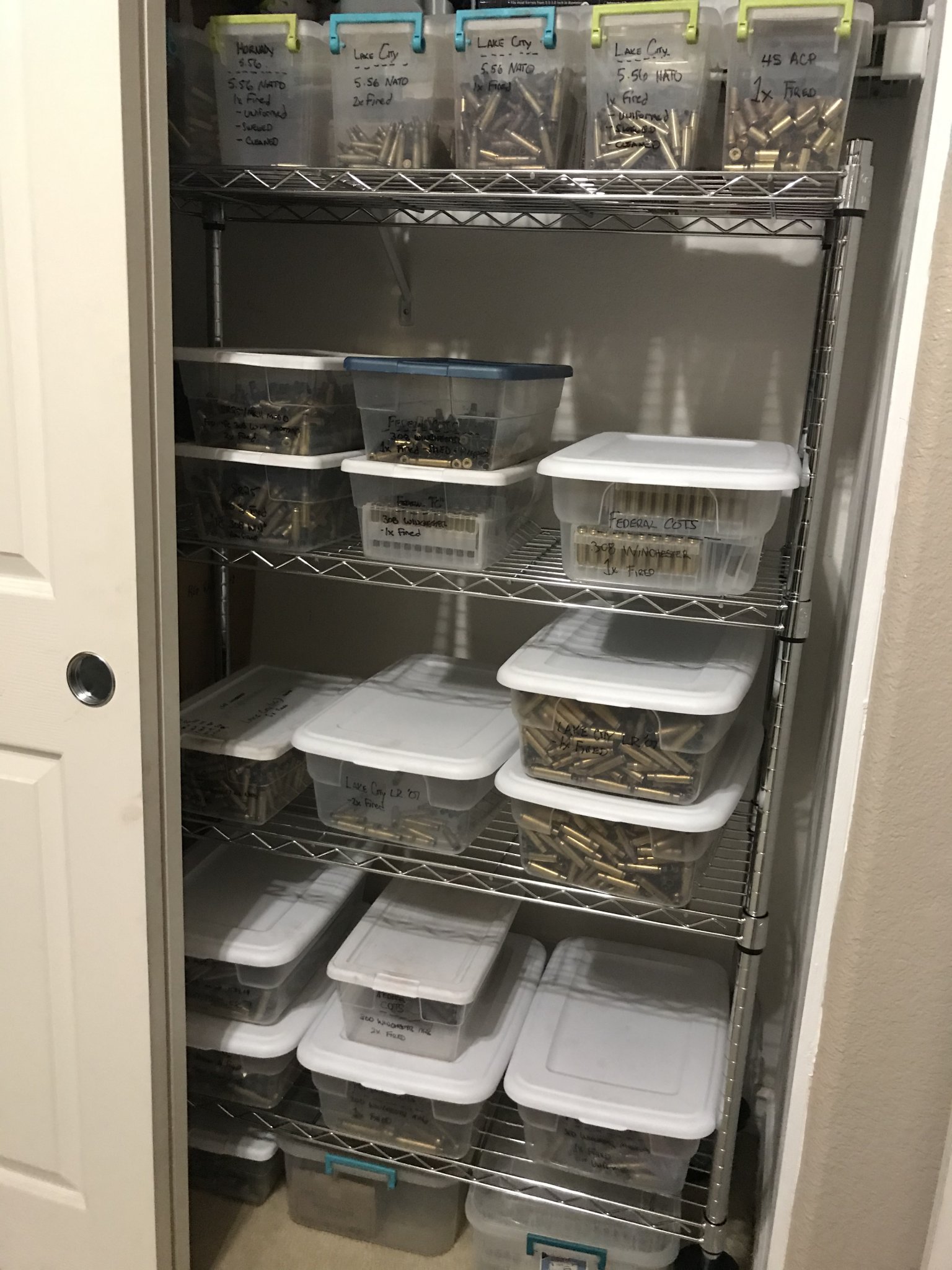

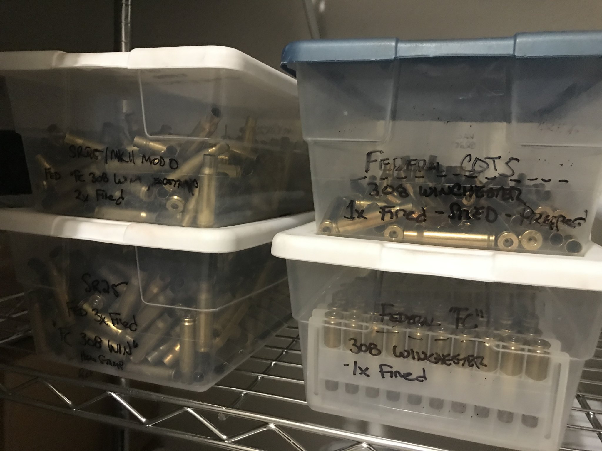

    I use plastic tupperware-like bins stored on a shelf rack with wheels. The bins are marked “1x”, “2x”, “3x” etc as well as the caliber (5.56 NATO, .308 Win, 300 WM, etc), brass manufacturer plus head stamp (“Federal 14”, “LC LR 07” and so forth). Brass shot from the session, which was prob once fired before that day, gets dumped into the appropriate 2x fired bin.
    Would you happen to have a picture of it?
    How many Tupperware bins do you have on a shelf?

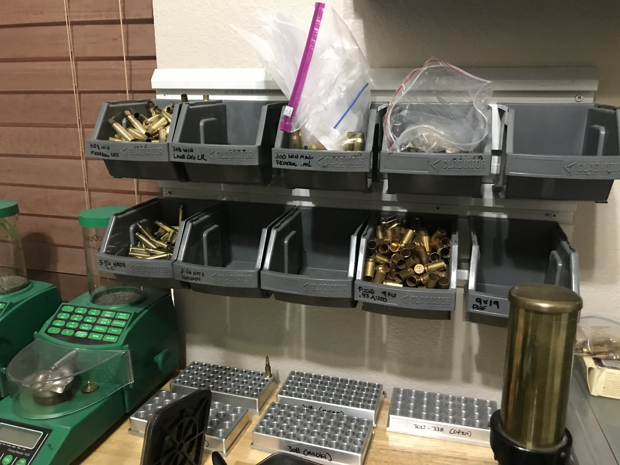

    Sure, here you go. I only keep brass on that shelf if it’s being actively loaded. Have tons of brass elsewhere that isn’t currently in use.
    The brass im ready to work with (ie brass that has already gone through cleaning and initial prep) is placed in the smaller gray bins (one bin for each system) and is ready for final assembly.

    Thanks for the pictures. It appears that you have a well thought out process that works well! One thing I’ve found out is being OCD about organization helps keep things in their place.
    Thanks again for the pictures.
    You’re welcome! Yes I am a bit OCD when it comes to reloading, lol.
