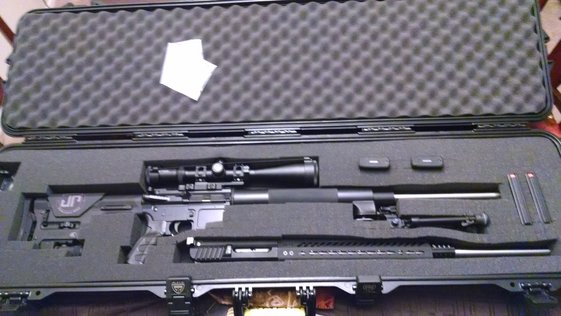

I built an AR precision rifle and had a lot of success with a BCM upper and a White Oak Armory 20" precision/match grade barrel and a Geissele trigger using .223 Federal Gold Match ammo with SMK 75 77gr bullets.
It provided consistently sub-moa groups out to as far as I could go on the range I was shooting (750 yards). In fact it shot 5 inch groups in a 1/2 inch group at 100 yards.
It was an awesome rifle, but I did not send it off for any additional work to the fit or bolt fact, etc.
