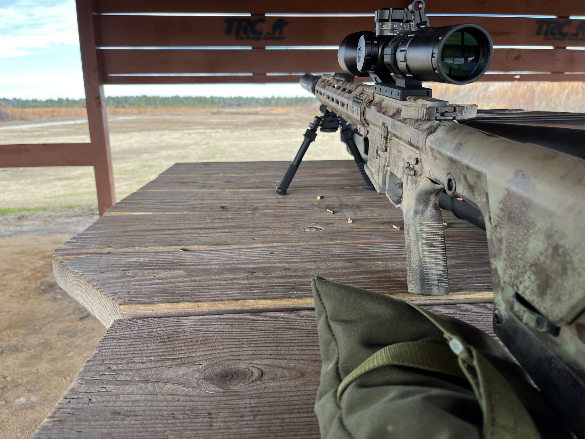

I put a Strike Industries GridLock on my 18 inch gun with rifle gas. It seems fairly solid to me so far. I have shot out to 600 with the setup.
