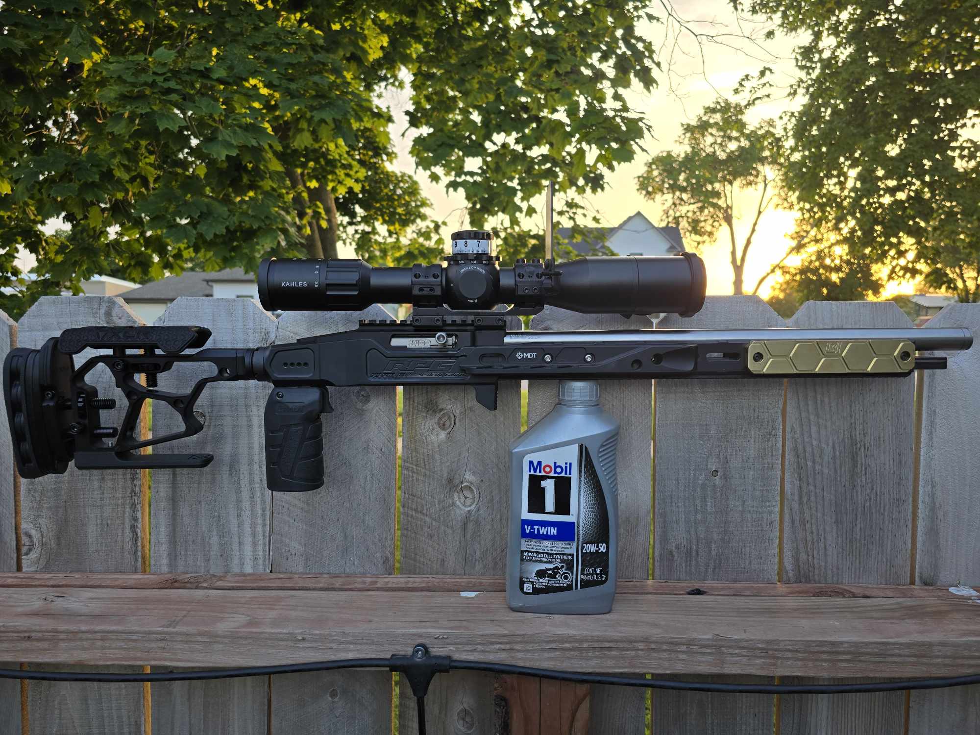

I just ordered one of the black XTR Pros to go on my Bergara B14R action. Can't wait to get my hands on it and get it mounted and sighted. Going with the Signature rings so I can maximize the available elevation when I mount it. I am really looking forward to trying this precision rimfire game and learning more about how to shoot a scoped rifle accurately and I think the Bergara B14R and XTR Pro will be a great combo for my new adventure.
