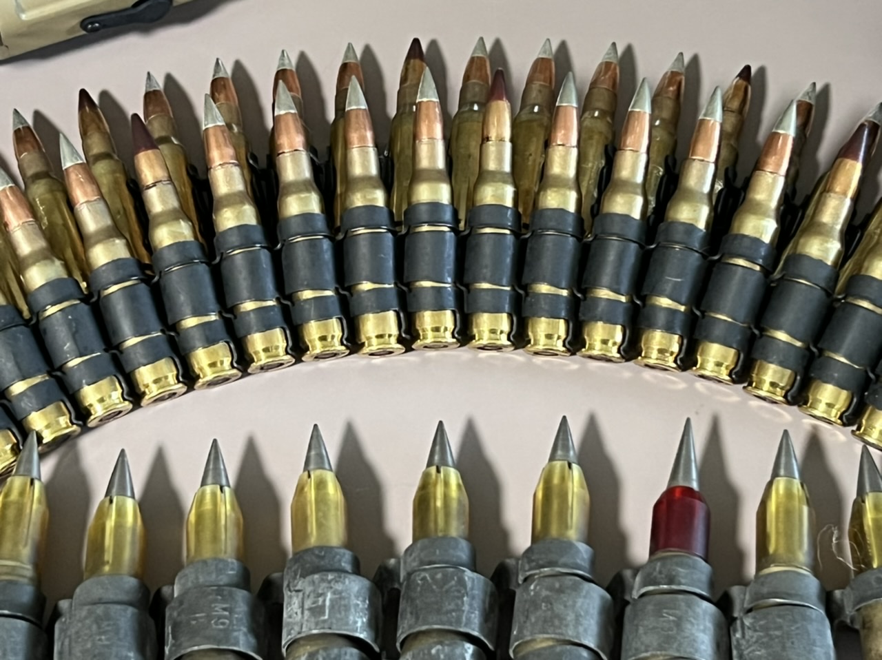

M80A1.
FGMM is for limp-wristed manbuns.
Go big, or GTFO.
