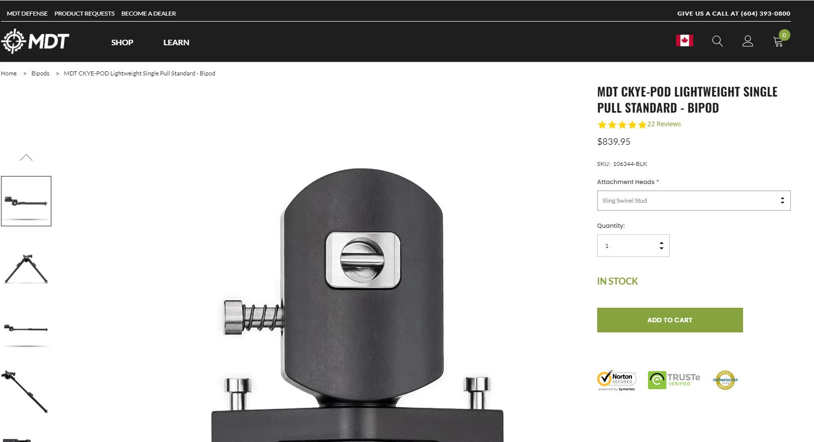

Ckyepod with sling stud attachment

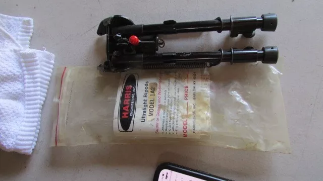

BTW, just snagged this on eBay to put on an older varmint rifle... $31. New in bag. WIth shipping... $38.
I am not sure I can get a quality non-ChiCom rail section for that.
Is it a Harris or a top quality bipod I'd stake my life or the lives of other on? Well, for decades until the advent of the Atlas and high-end bipods in the early 2000's... Harris bipods were the state of the art. As I said above, for 99 percent of applications and probably shooters, they still are perfectly usable. Even those stuck on sling swivels.
I have lots of more expensive, better, cooler, lighter, Tier-one-ier bipods. I think I got my first Atlas about 20 years ago... maybe a bit less and LOVE those guys. But Harris still has its place.

Could you compare the Harris to an MDT CYKE-Pod?
I use my Cyke pod for matches. It's awesome for weird angles, props, and barricades. Being able to use Atlas feet sounds cool but I've never taken the spikes off.
