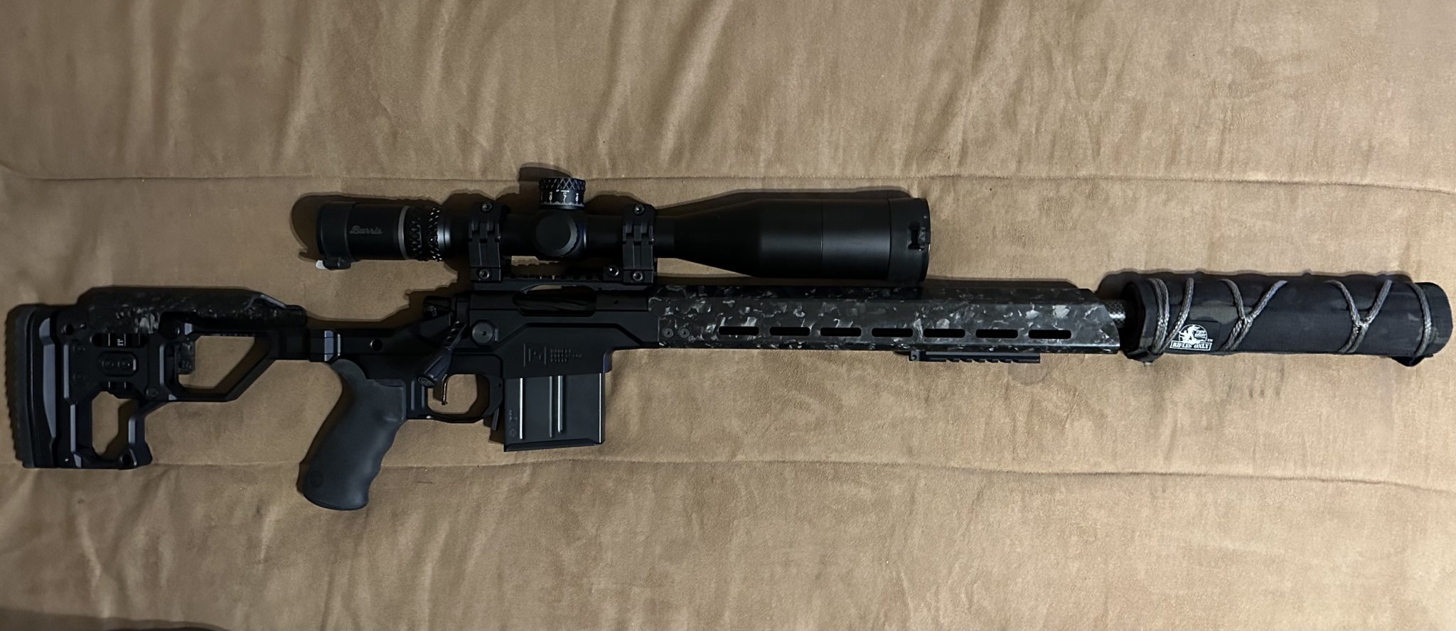

Ctr for me
Dropped in a krg bravo
Also look at a slip on limbsaver recoil pad with whatever you end up with. It will increase length of pull a little, but will absorb ~50% plus of felt recoil. A Good set of earmuffs is in order too.

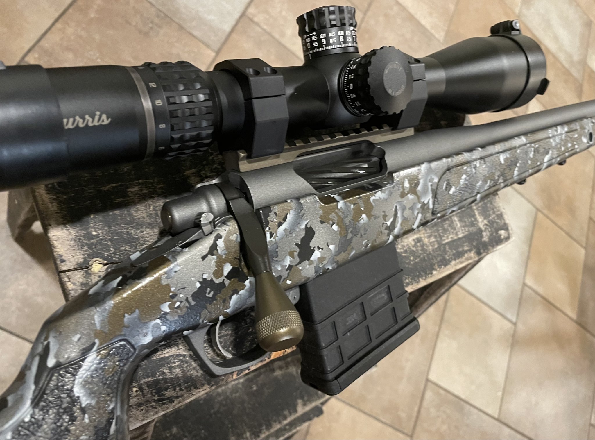

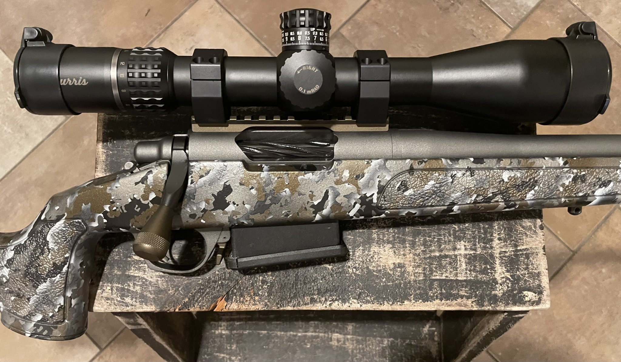

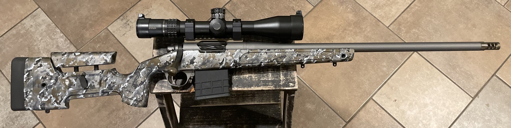

Get a bolt-action in 6mm ARC... If you handload you can load Nosler 115 RDFs that will be able to reach out there at long distances on targets. Virtually zero recoil. And long barrel life. It would also be fine for deer hunting out to about 300 yards with proper shot placement. With a 16" barrel, I'm getting 2,575 FPS MV average with the 115 RDF's and LeverEvolution powder.
I have one for coyote hunting & target shooting, but it's a little more than your $1,500 budget. But if you can spend more, I highly recommend it. It comes already in a chassis, and with a 20MOA rail, an MDT magazine, and a TriggerTech trigger. So, pretty much slap a scope on it, and rollout.
Same rifle in Night time Mode vs. Daytime Mode...

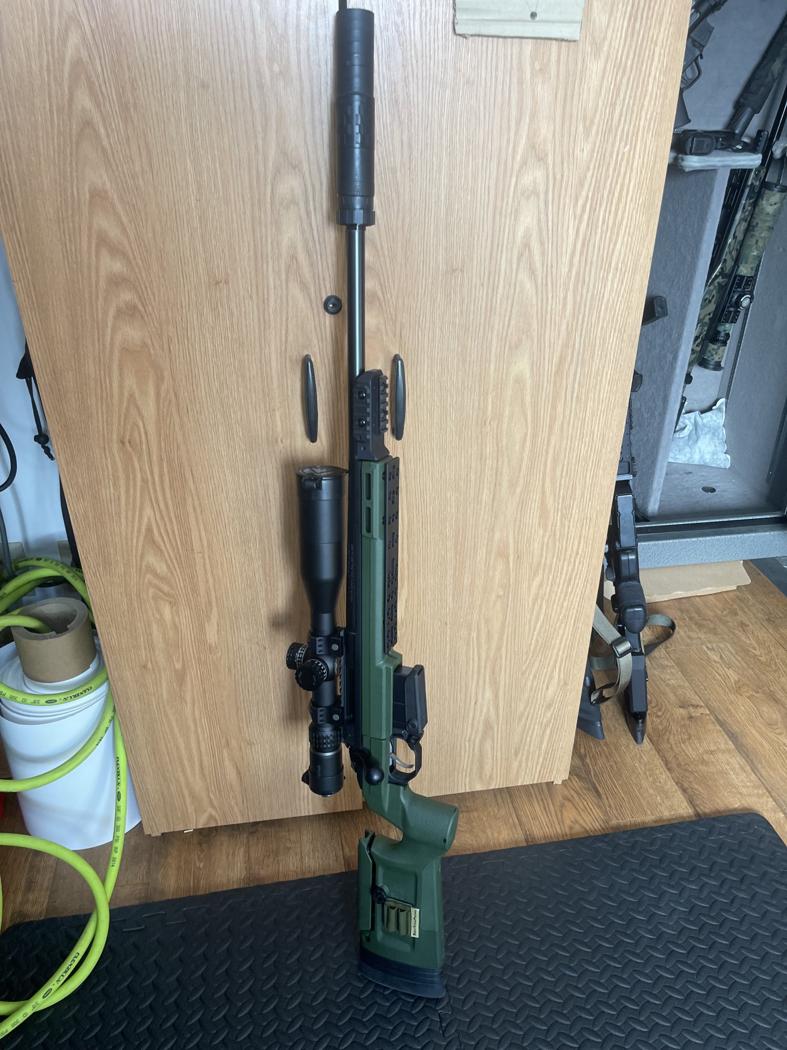

Checkout one of these... a fast twist Tikka with stainless barrel.
Just keep in mind barrel life is ± 1,250 rounds. Actually never mind that last bit...😄
I built my nine year old daughter a 224 Valkyrie bolt gun for the reasons you describe and for about $1500 in its first iteration.
I used a Stiller Scout from PTG (yes, I’ve had the same issues as everyone else with PTG, but i have two laser reamers and one good action). The action in 6.8 SPC bolt face was on sale for $600. After a custom reamer to avoid factory reamers issues, a Bartlein Rem Varm contour, and a take-off Bergara stock we had a rifle. Its an absolute laser and my daughter warms up at 500 yards before stretching it out. Factory ammo is ok out to 700 yards, but beyond that the ES starts to have big effects. With the little bastard brake and 13 lb weight, it recoils like a 22 mag or similar.

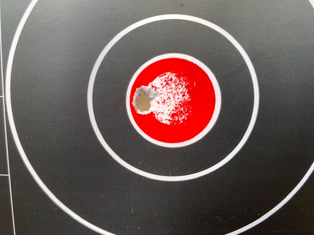

One pic has modified mags shortened. 3 rounds at 100 yards factory, ammo when zeroing. Nothing really wrong with a Valkyrie, but a 6 CM is likely a better alternative for several reasons. I have a 224 AR for my son so my kids are shooting 224 Valkyries. AR is running a Craddick/Bartlein barrel.
Cerakote in house,
