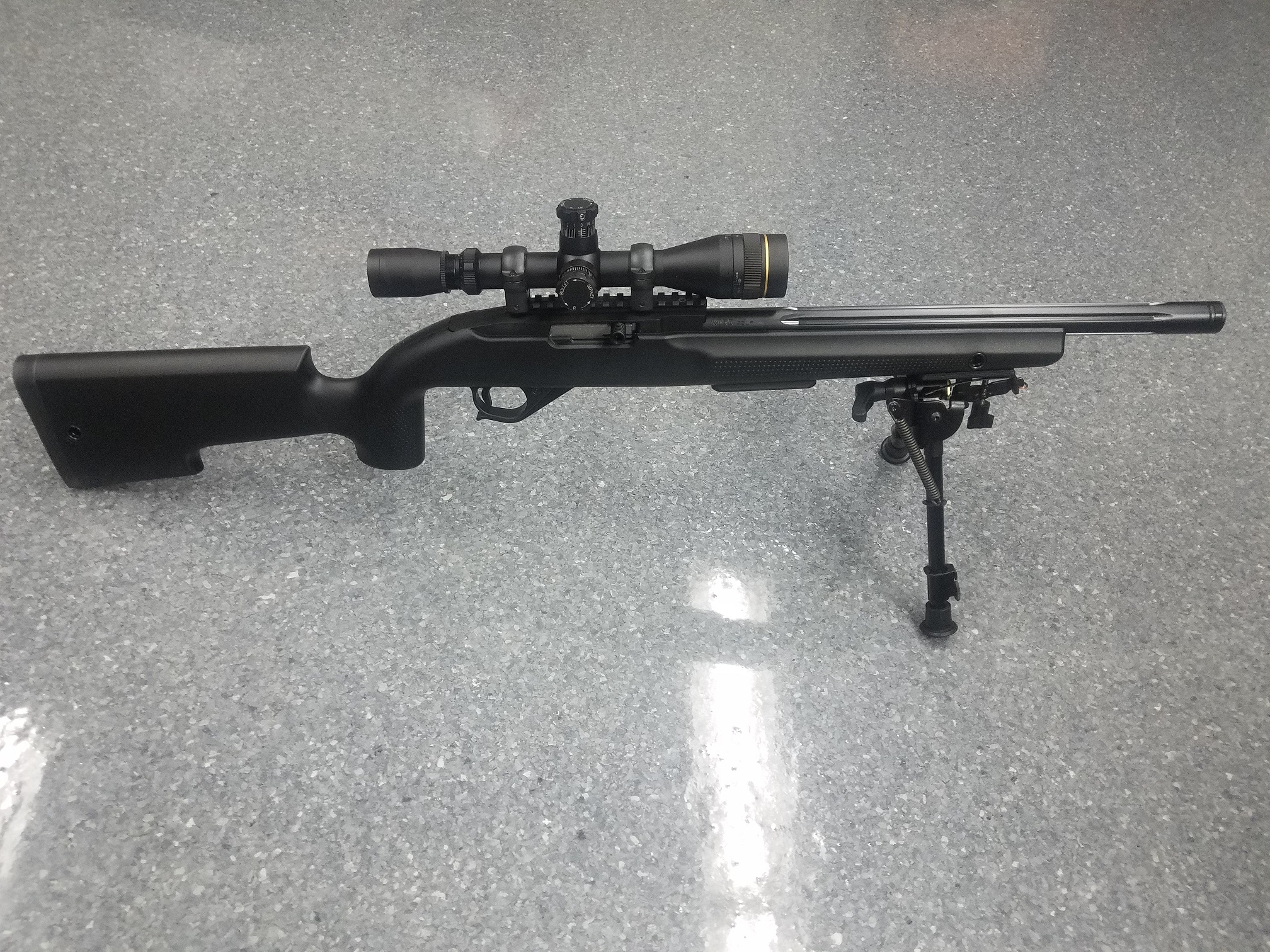

    I’m toying with the idea of getting a Kidd Supergrade with the extra rear action screw. I’m not thrilled with the Magpul X-22 stock they offer. I’ve been thinking of the McMillan A5-22, but I’m not sure what other options I should look at. Thoughts?
    I really like my SG in the Magpul stock, do be aware that you only have one chance to get the SG with the Magpul stock, and that is when you purchase a complete rifle from KIDD. They DO NOT OFFER the SG magpul stock (inletted for the tang and QC channels) as a separate item, only when you buy a rifle.

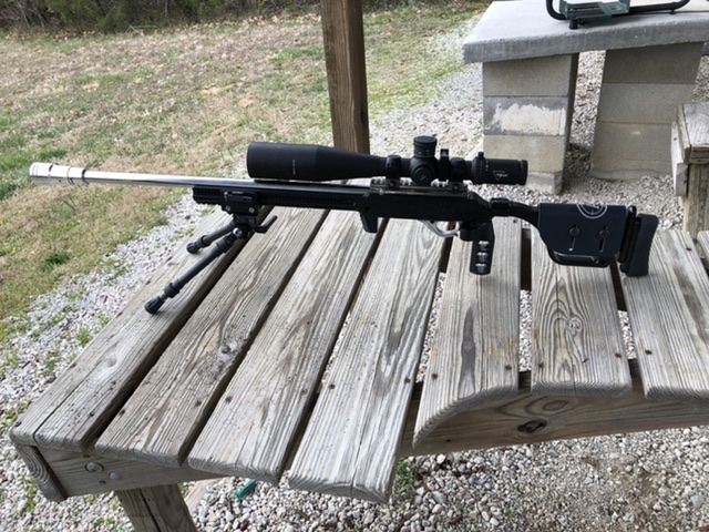

    I also run a PMACA long nose chassis (which are now machined with the tang and QC channels) and a Victor company Titan stock (has the rear tang option on all stocks, you would have to drill your own QC hole for barrel removal).
    The PMACA you put whatever AR pattern stock and grip you want on it, depending on the selection you might have thumb web bite if you select a rifle stock instead of carbine. I'd like for the receiver to sit 1/4" lower in the chassis for better ergonomics but it does ok as is. This is the stock I'll ususally select for NRL22 type competitions.
    The Titan is probably the closest to the A5 with a pretty vertical grip area, but LOP is fixed length and cheek weld spacers are screwed on top of the stock comb, but they work. Of the 3, I don't use this one very often as it just seems heavier and less handy than the other 2.

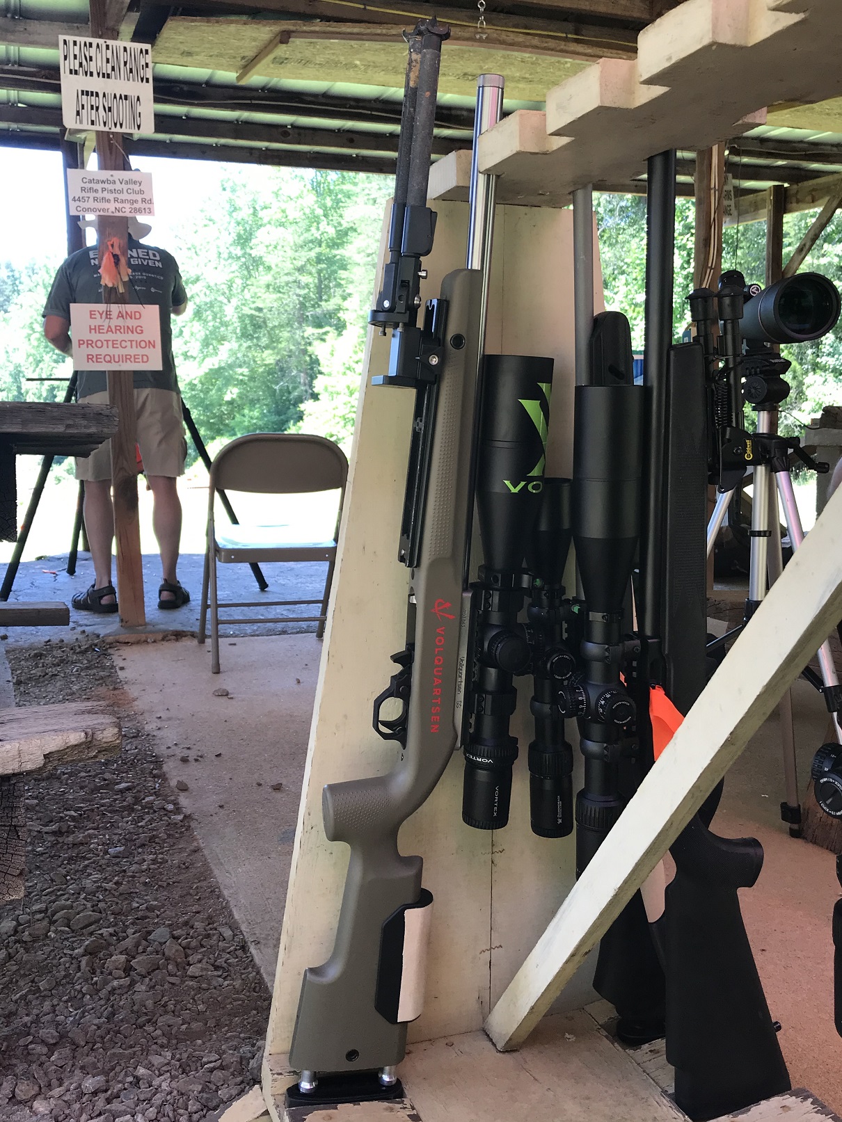

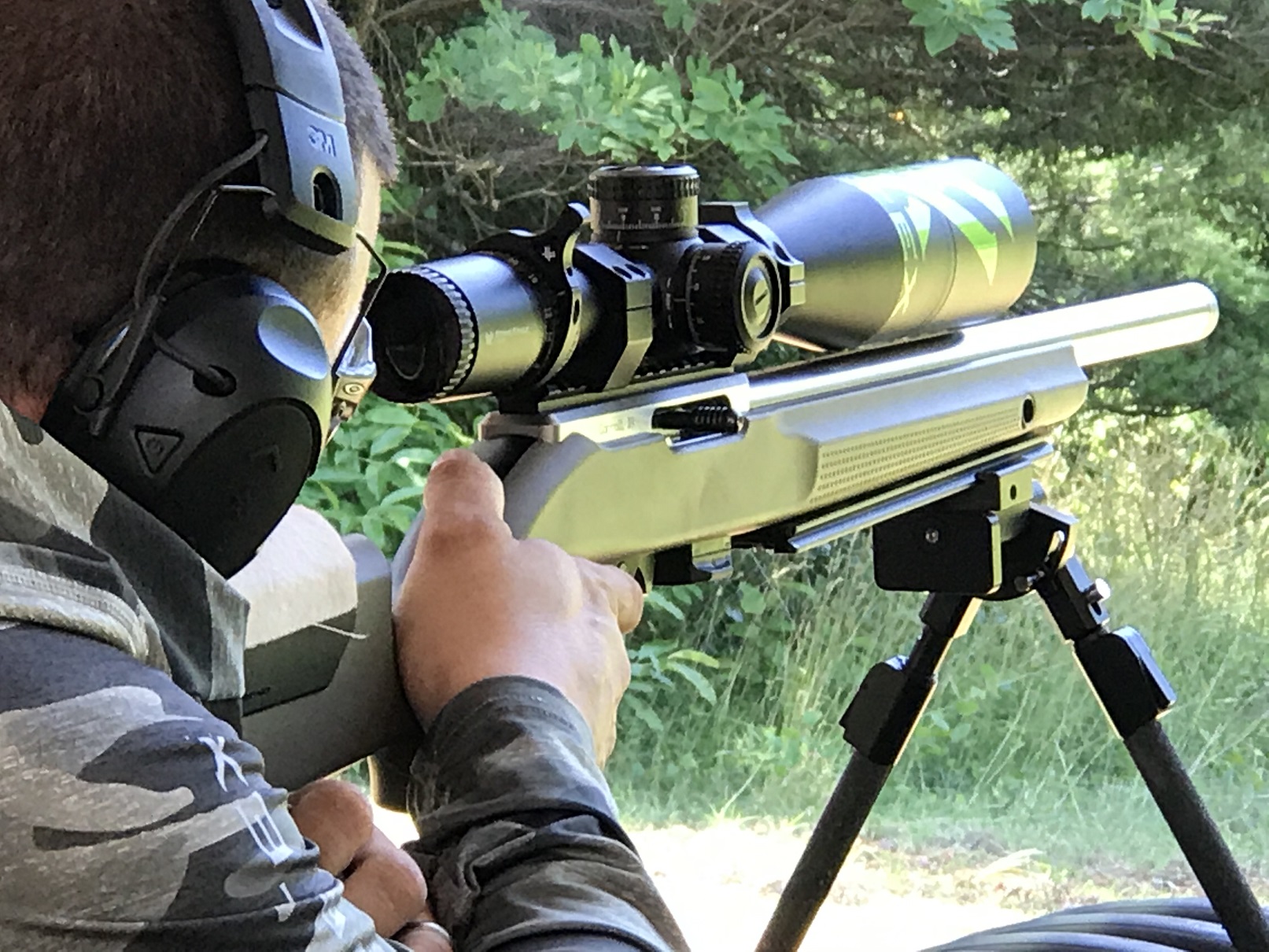

    Definitely the Titan stock. I have 2. The are awesome. The rear anchor, front rail and cheek rest accessories make it hard ro beat. Reasonably priced and well made. All mine are dead center in barrel channel and lock up tight.
    I have one Ruger factory receiver build and one Kidd custom.
    I too have the titan and very much like it. I am going to buy the wood finished ine when it become available. Would LOVE a titan stock predicted for the supergrade quick barrel removal. My next supergrade will likely be in the magpul bc of the ease if barrel change and bc Tony beds them.

    I like the chassis stock by Accurate Rifle Systems for the Kidd Supergrade.
    it’s available for the rear action screw.

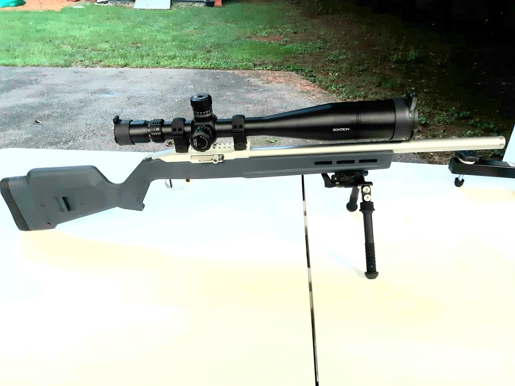

    I went with this stock for my custom 10/22 clone build by Joe Chacon.

    I'm currently using the Victor for my Volquartsen VG-1 10/22 based rifle. I've been working with for a long time, but several features have given me issues. I found that the fore-end is just not stiff enough (despite my stiffening attempts with aluminum ribs and hard epoxy filler), the angled fore-end does not work well with an ARCA rail, the lack of a thumb shelf for my preferred hand position, and the lack of LOP spacers being available.
    As a result, I'm really looking forward to the release of the KRG 10/22 Bravo. They're using the full aluminum back-bone for a nice stiff platform, all the optional chassis enhancements that come with their centerfire rifles (spigot mounts, ARCA rails, weight kits, etc), as well the great ergonomics and adjustability they're known for. Since I use KRG chassis' in other competition rifles, this will be a really nice chance for me to make my rifles all the same, and I'm REALLY looking forward to it.
    If you're looking for a competition-ready chassis for a 10/22, and you want all the stiffness, adjustment and flexibility of a competition developed chassis, I think the 10/22 Bravo is going to be the ticket!
