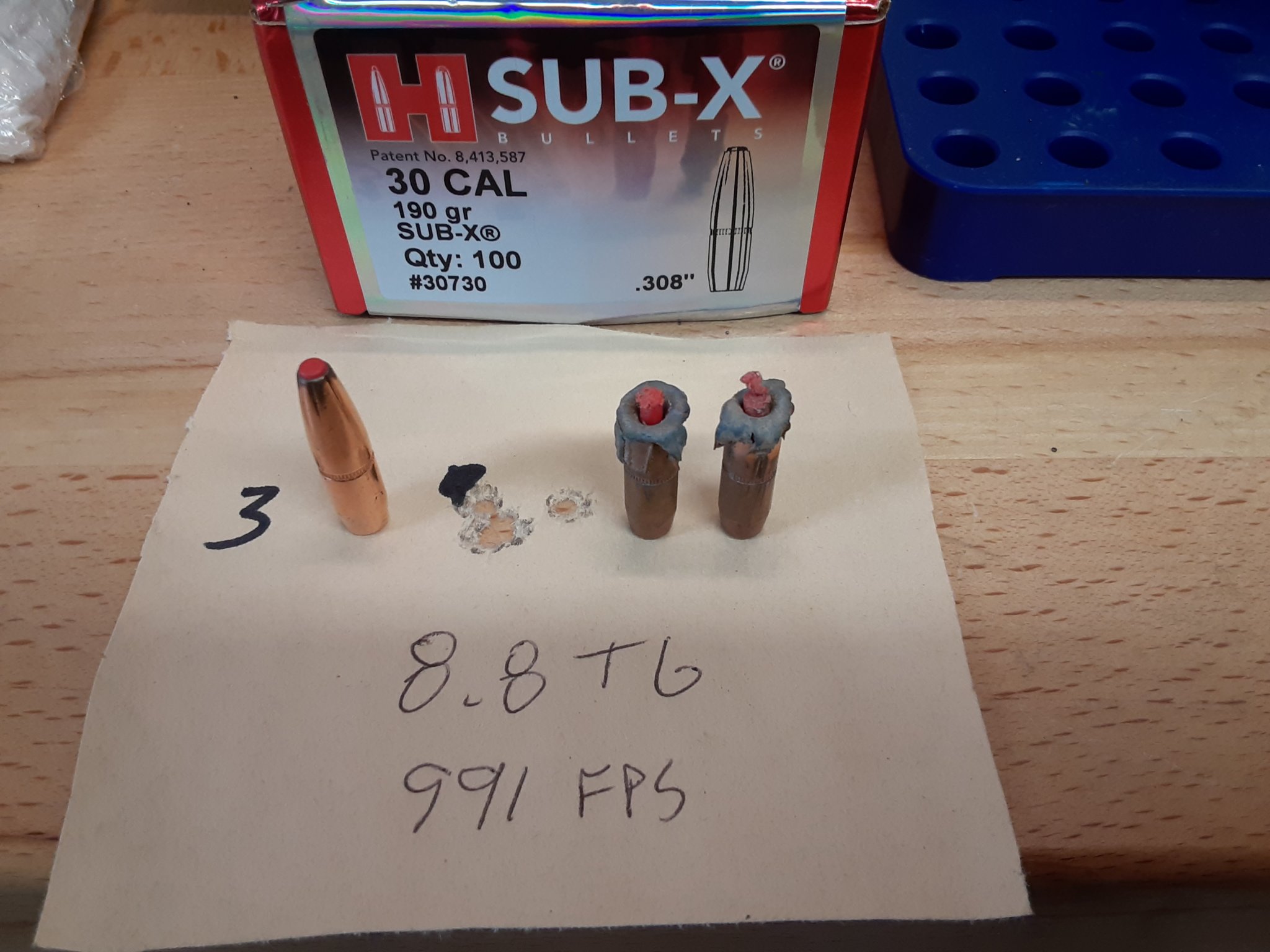

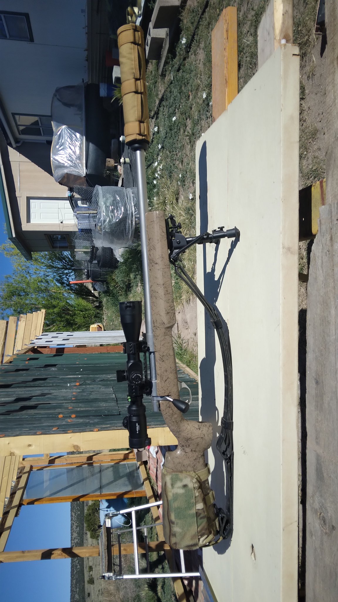

I would like to know your suggestions on N110 Subsonic .308 loads for a 22" 1in10 " rifle . Is this a possibility with powder coated lead ?
I don't see that working with 308win and N110. You'd be looking at 30-40% case fill depending on coal and bullet weight which you are limited with the 1:10 tw.
You'll need either Tinstar (N32C) or Trailboss for optimum 308 subsonic loads. Both of them as far as I know have been temporarily discontinued in the US.
Also with 1:10 twist you'll have to stay with the 175-200gr bullet (I believe the Lapua 200 FMJBT would stabilize at 1050 FPS out of a 1:10 tw, it's a fairly short bullet) so you can't benefit from a very long VLD like a SMK 230 or a 220 ELD-X which fills the case quite a bit.
I don't know of very much valid alternatives for N32c and Trailboss due to the large case capacity that has to be filled. I'd never do less than 50% case fill due to the atrocious velocity spread and the higher risk of secondary ignition.
N110 does work very well in a 300BLK case or a 458 soccom/450Bushmaster.
Reactions: Subsonic .308
Thank you .
Would be curious on your thoughts if you end up playing with 8.6 BLK, where you don't need Trailboss for things to work right.
Wish I could afford to go to a Blackout . Have to make due with my .308 . And have coyotes coming into close at night . Hoping to finda way to use subsonic thru my suppressor . No need to annoy the neighbors .
