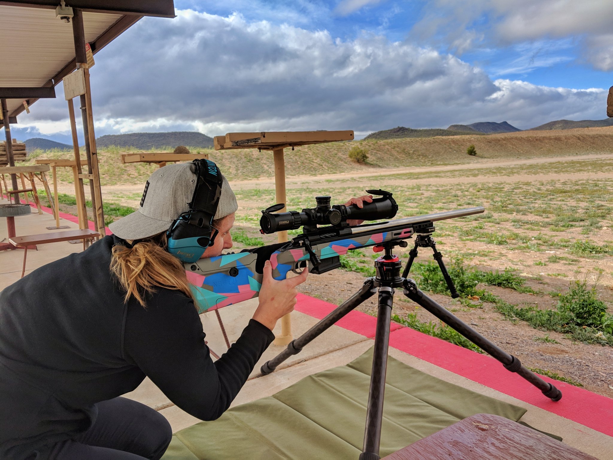

Check out the Uniqball UBH45. It's a gimbal ballhead. It has an outer and inner ballhead. You level and lockout the outer ballhead, and the inner ballhead can only move in the horizontal and vertical axis. There is absolutely no cant in the system. You can move the rifle from target to target, in 360° of motion moving the vertical plane to whichever degree you need, without introducing any cant into the system.
It's rated for ~88 lbs (it's stout and stable) and comes with an ARCA clamp. You can use it as a "regular" ballhead if you don't lock the outer ballhead out.
I have one, and think it's an excellent ballhead. It sits on top of an RRS tripod. The gimbal system is really cool, I love that it eliminates cant from the system.

That looks really nice, can you adjust the tension on the ball so that you can shoot with it unlocked, but still have resistance? Or is it fully locked or unlocked?

The only thing I want to change, is to change out the OEM ARCA clamp for one that has a lever release clamp, like the RRS SC-LR.
The stock clamp is a knob/screw type clamp, which you turn to tighten down. It's slower then a lever release, and I believe lever release clamps do a better job of applying tension. I have found that the stock clamp can come loose under heavy recoil, I've noticed the clamp slips when shooting my .300NM rifle mounted to it.
I think I'm going to pony up for the RRS SC-LR and change it out.
