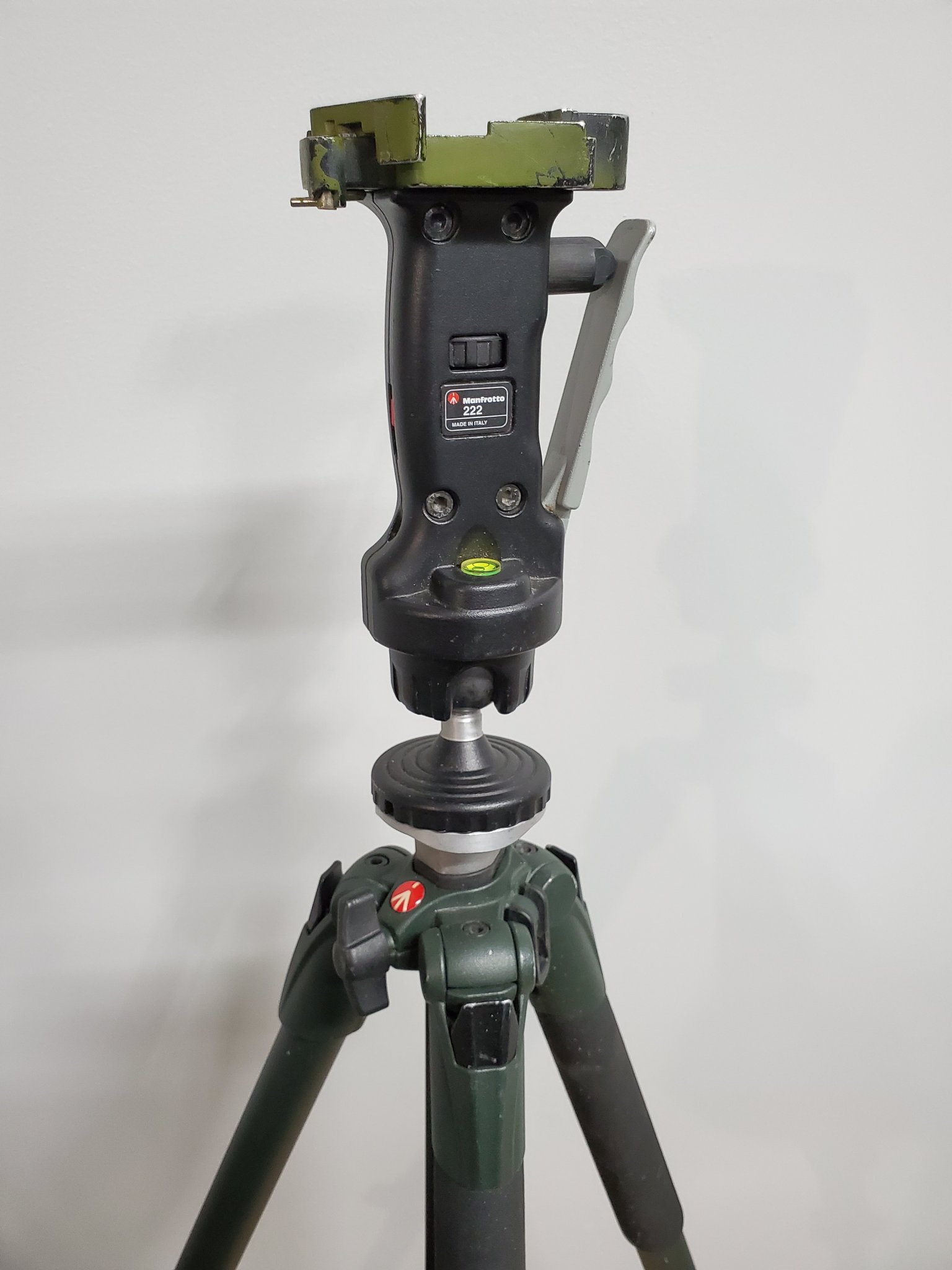

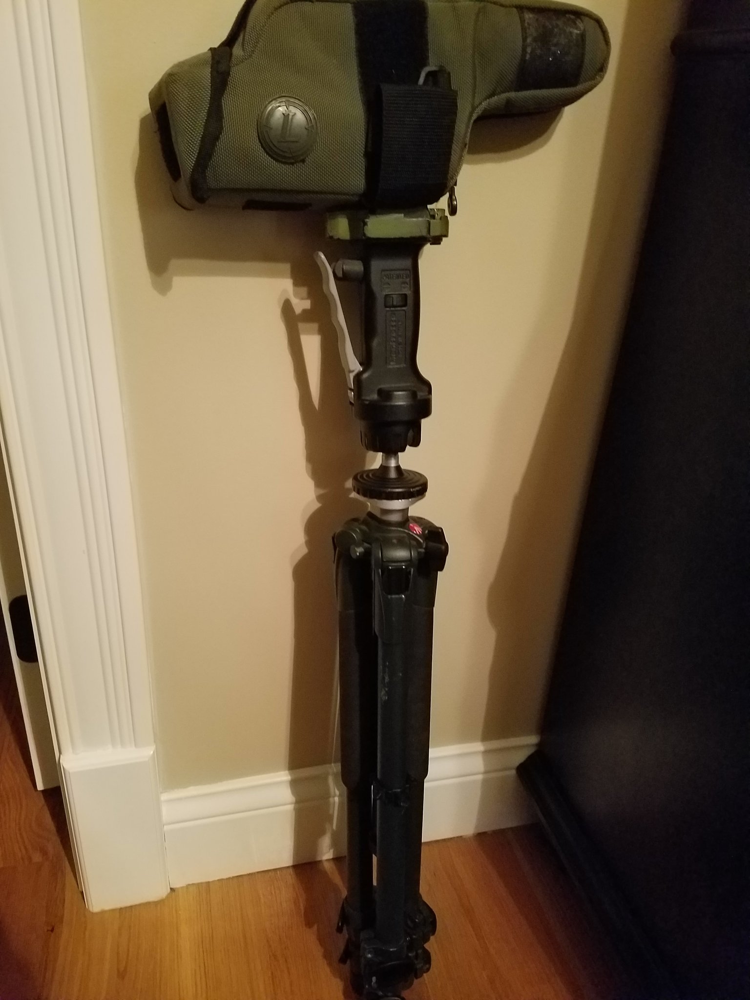

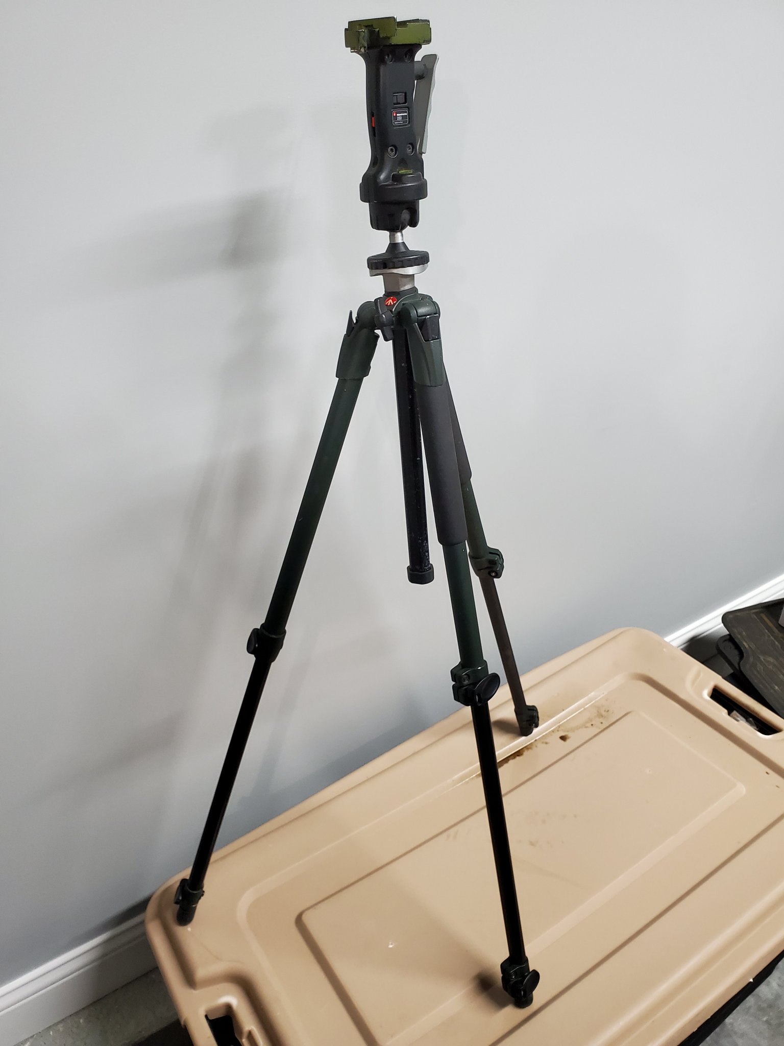

I got my mark IV, manfrotto tripod and manfrotto 222 ball head from a friend. Unfortunately I do no know the model number of the tripod but I am sure someone can identify it. The vertical manfrotto 222 ball head is great. This combo works perfect for a spotter sitting on something such as a chair (or anything else improvised with similar ergonomics).
I have used this to scout and I take it out hunting as well. Having a spotter when hunting long range is amazing compared to spotting with naked eye then using rifle scope for magnification. I use a phone scope and film through it too. The feet are perfect when bottom section is retracted and locked since the smaller diameter fits right through the holes/mesh style floor in my deer stand and when all 3 feet are stuck in a hole it's as stable as sitting on a completely flat surface if not more.
As far as the mount......I couldn't tell you but once again I am sure someone can identify what I am using. The remaining paint on the mount was applied by an individual who used it for work.
