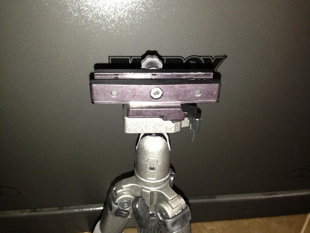

Most RRS Plates are custom-fit and camera-specific, so RRS makes a bewildering number of mounting plates. That's why RRS wants to know how big the mounting foot on the Razor is so they help you determine which QD plate(s) will fit on it (and if the BH-30's Clamp will accommodate one of those plates). I'm sure RRS has at least one Plate that will work. I would email Vortex and request a photo of the mounting foot with a ruler next to it (and the dimensions of the mounting foot would help as well). NOTE: The QD plate you choose doesn't have to be as large as or of the same shape as the Razor's mounting foot, but the Plate's size and shape must provide adequate support to the mounting foot so the spotter balances well. I’m using the RRS B6 Bi-directional Plate, whose interface is just a tad narrower than an Optolyth S80 Compact’s mounting foot. B6: Small Bi-directional Plate - B6
Take a look at the photos below of the mounting foot of my Optolyth S80 HD Compact. While I could have used a larger Plate it was neither necessary desired. The RRS B6 Bi-directional Plate is 1.6Lx1.75W” and works great for me. I have a two B6 Plates - one is mounted on my Optolyth S80 HD Compact and the other is mounted to my PVM-21 Chronograph.
If you want or need a slightly wider Plate, the RRS B76 should suit you. It measures 2.1’Lx1.6”W. http://reallyrightstuff.com/ProductDesc.aspx?code=B76&type=0&eq=B76-005&desc=B76:-Multi-use-plate
