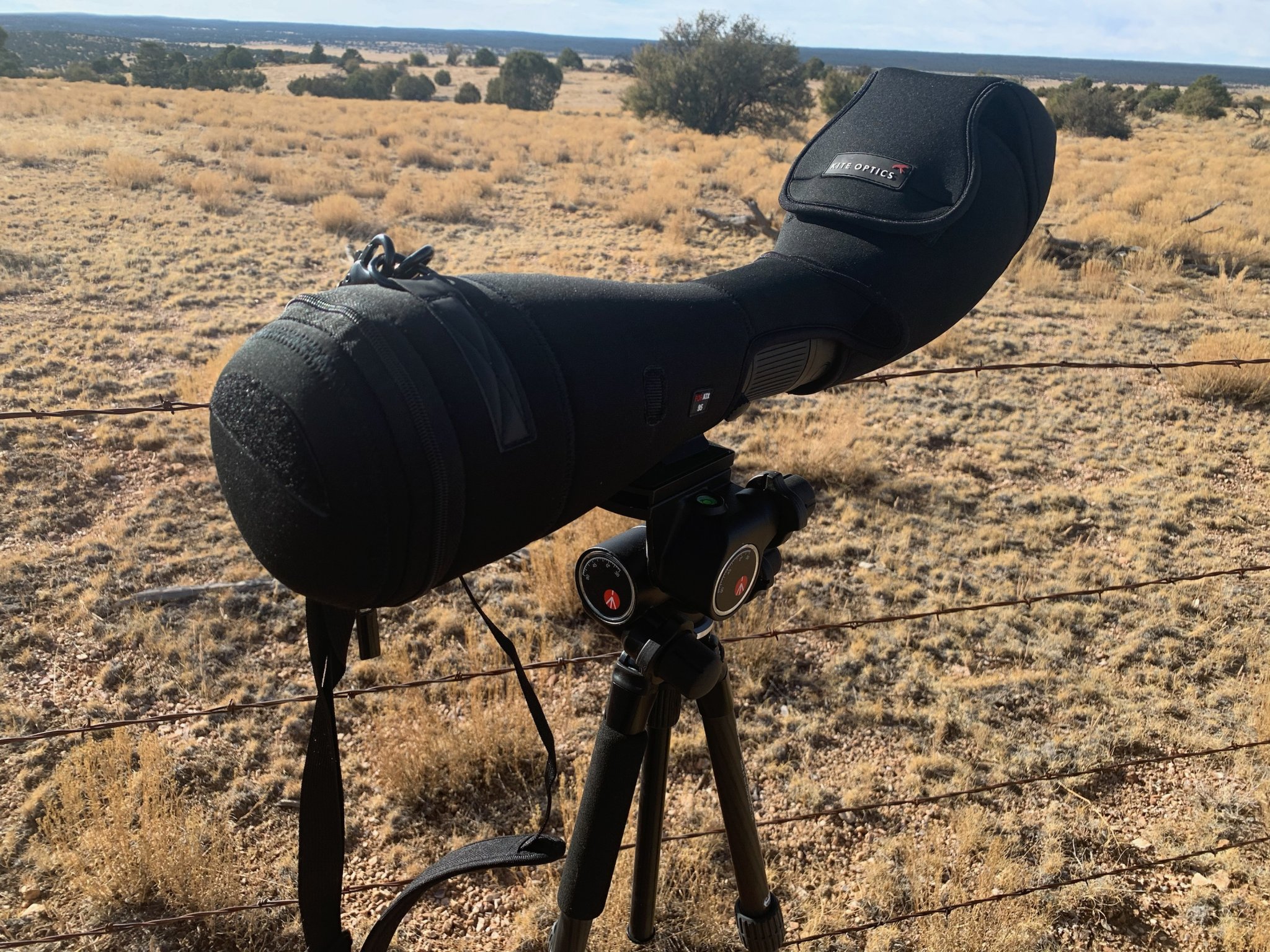

Turns out the SLIK 624CF works fine when the scope is mounted to the Manfrotto 410JR head. I can slowly sweep hosizontally & vertically using the knobs and the BTX w/ 95mm objective balances just fine...even in wind! Sure glad I listened to the Jeff & Joel at Cameraland. Great price, fast delivery and wonderful customer care. They set the bar so high other vendors need this spotter just to see it.
