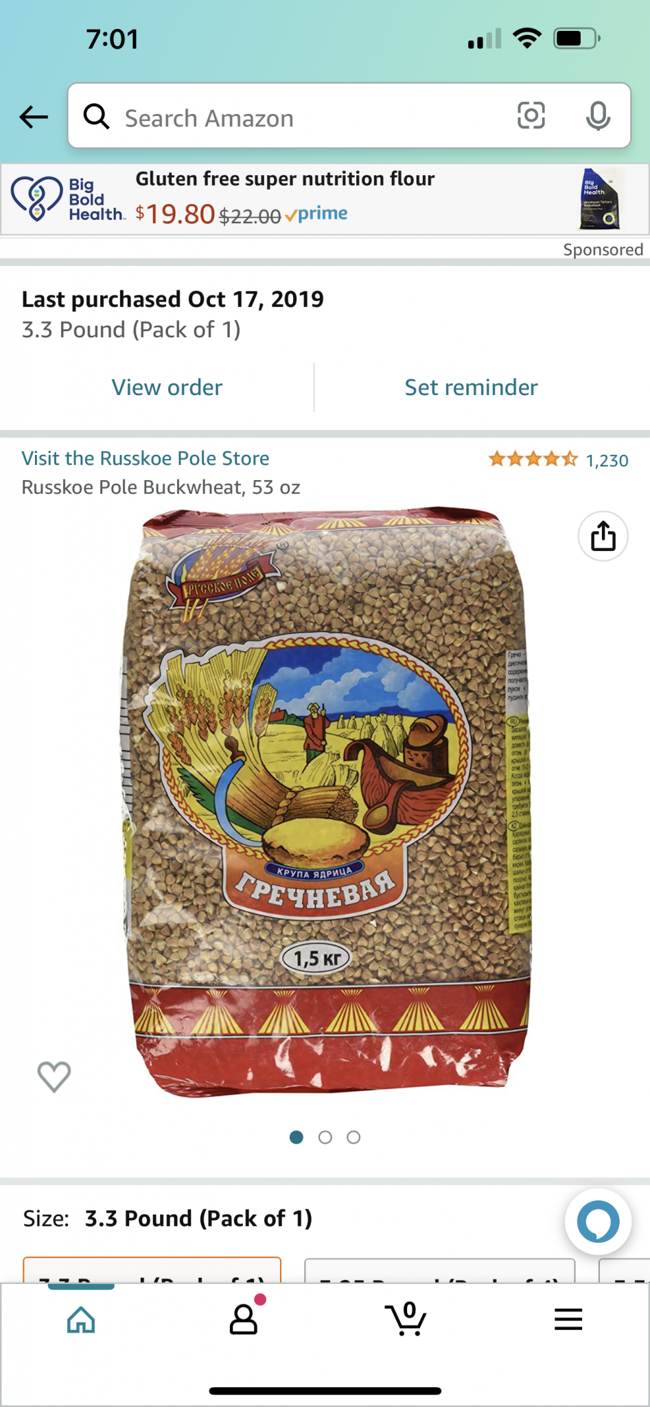

Russkoe Pole Buckwheat, 53 oz https://a.co/d/c2yBMwf
This shit right here is awesome. Almost ZERO dust. The only problem I have is they get stuck in primer pockets but I always use a universal decaper before I load.
I have tumbled probably 10k rounds through this shit.
This is what I used when I was loading...when it was fresh/new I'd get a lot of it stuck in small primer pockets after it was used awhile it would only be a few here and there. but it did get in the cases and some would pack pretty tight I'd just spin the cases in a large rotary media separator problem solved. Cut up a few drier sheets and throw them in every time you tumble and it keeps the media clean and your brass smells fresh.
