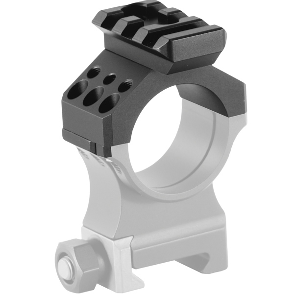

Depends on the manufacturer of the rings, if they even support something like that. For instance, Badger has the Accessory Ring Cap (ARC) system that works with their normal 1" rings as well as the COMM one piece, but then you need to source plates and adapters for the different microdots. For instance, this is just one piece (the ARC) https://www.rooftopdefense.com/prod...arc-accessory-ring-cap-for-30mm-scope-mounts/

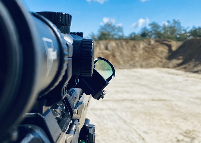

Again, depends on the manufacturer. If you're no using a gas gun or something else that has a large picatinny section at the 12 you're pretty much fucked. If you are on a bolt gun with a pic rail, you can look into a 45 degree offset from someone like Knights, Trijicon, GG&G, etc. that matches whatever dot you want. Not as nice as piggyback at 12 o'clock like you want but an option nonetheless.
Something like this:
Reactions: Arevalosocom
I personally think the 35* and 45* offset mounts are nice for competition and gun games type stuff but I have grown to like the 12 o clock rds mount that sits up higher for passive aiming through nods and while keeping the rifle upright and not having to worry about cant and all that. Both options definitely have pros/cons.

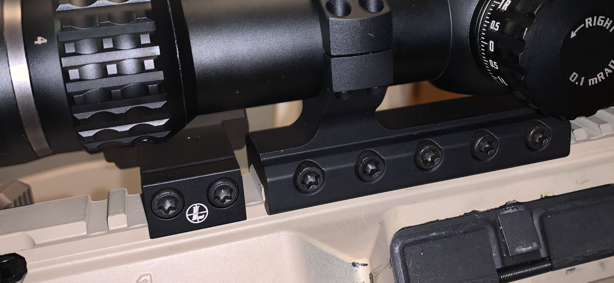

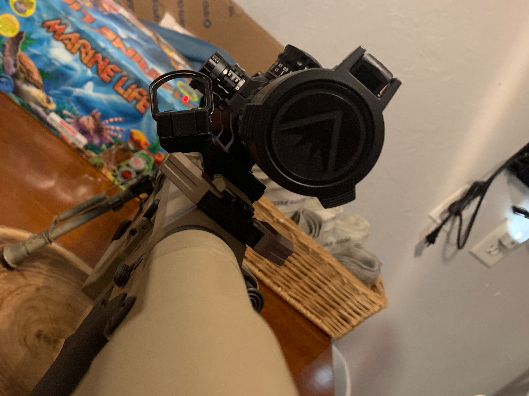

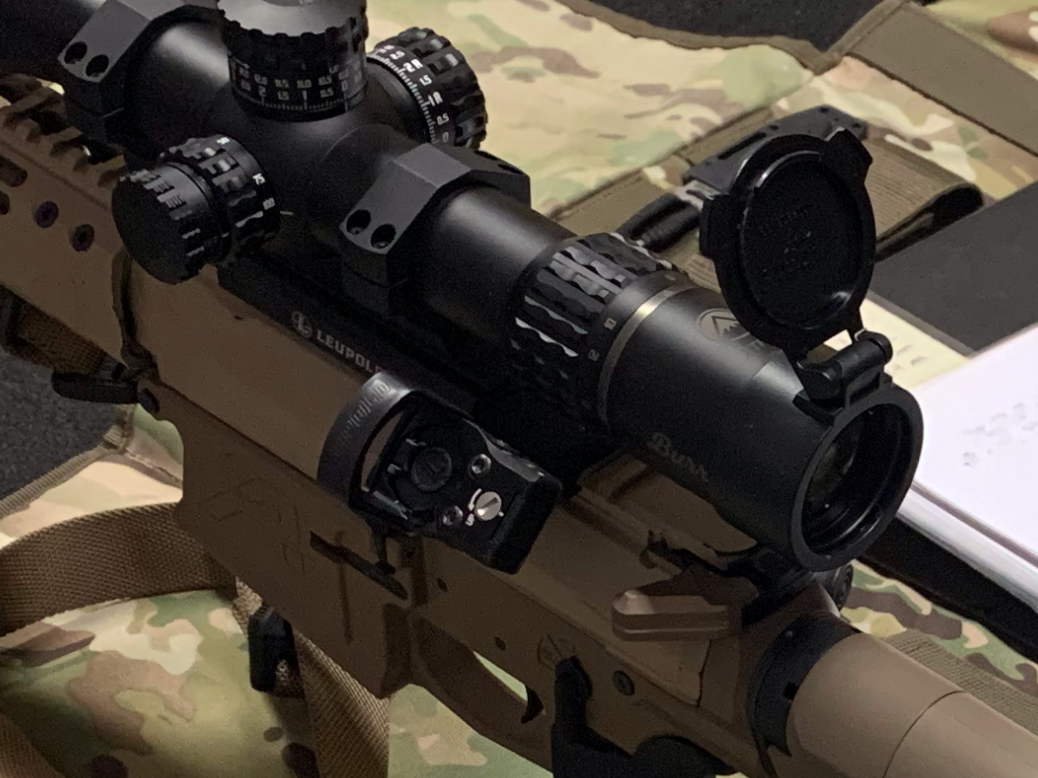

Here is how I did mine. It’s an Aero M5/308 build with Leupold mounts, scope one piece and DPP 45*.
I haven’t shot it enough to matter (got them both close at 25 yards), but it’s useable doing dry runs in my house.
I’ll try the other pics, in the next post. They aren’t loading.

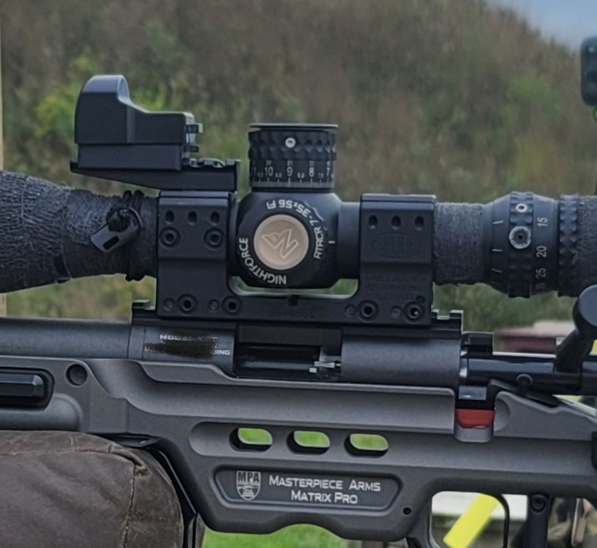

You want 12 o’clock?
Nightforce Multi mount. Can also do like 1 or 11 o’clock also.
