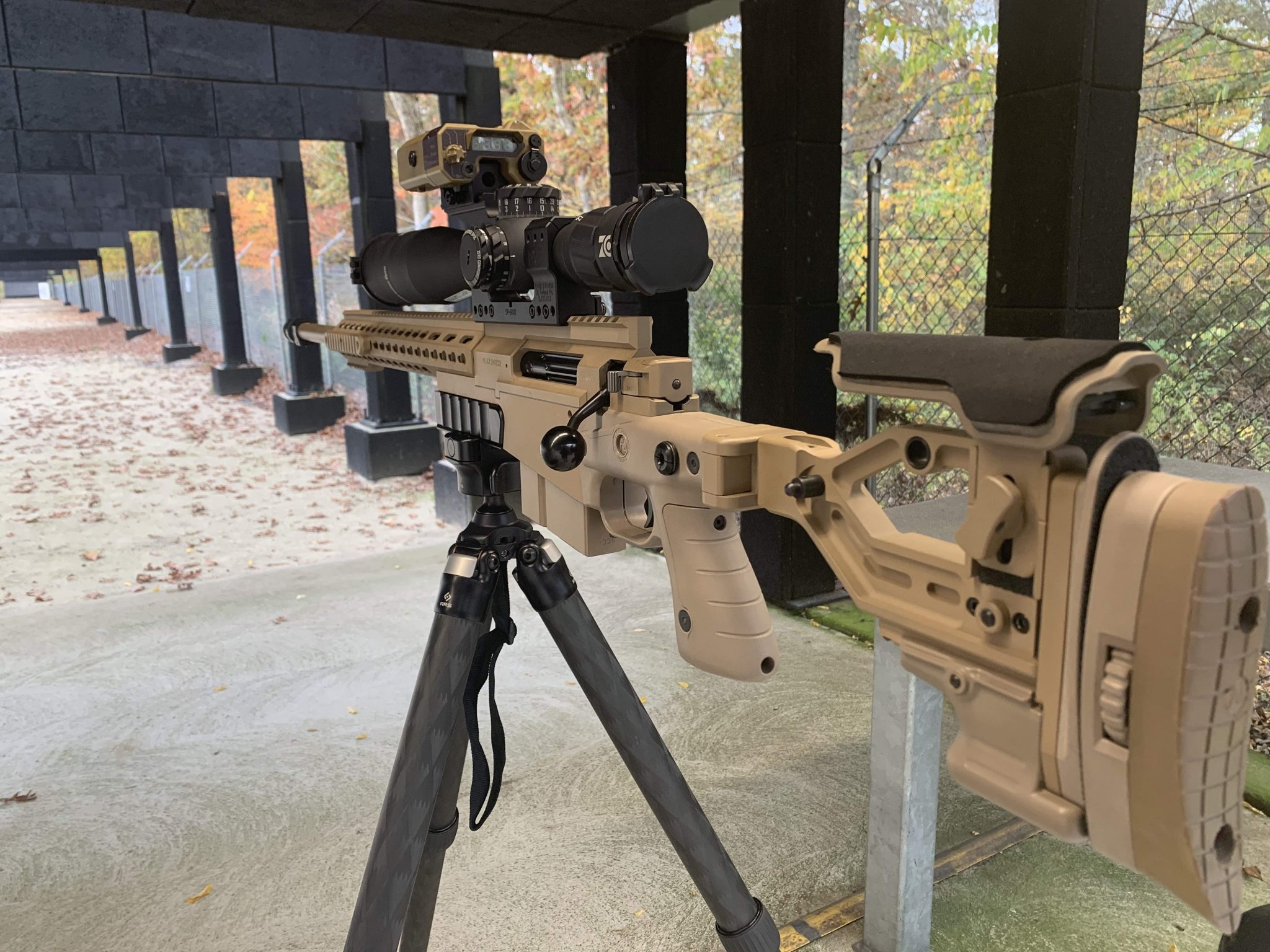

Spuhr has 3 0029 options — A B and C.
The C is the lowest version, so if you’re not using a larger clip-on, like a PVS-27 or a UTC, get the lower profile “C” unit and do NOT use the Picatinny rail adapter included with the Raptar to keep things compact and looking slightly less freakish.
If you plan to run a clip-on, get the “B” variant that is about a 1/2-inch taller so it will clear the clip.
My Raptar-laden rig:
