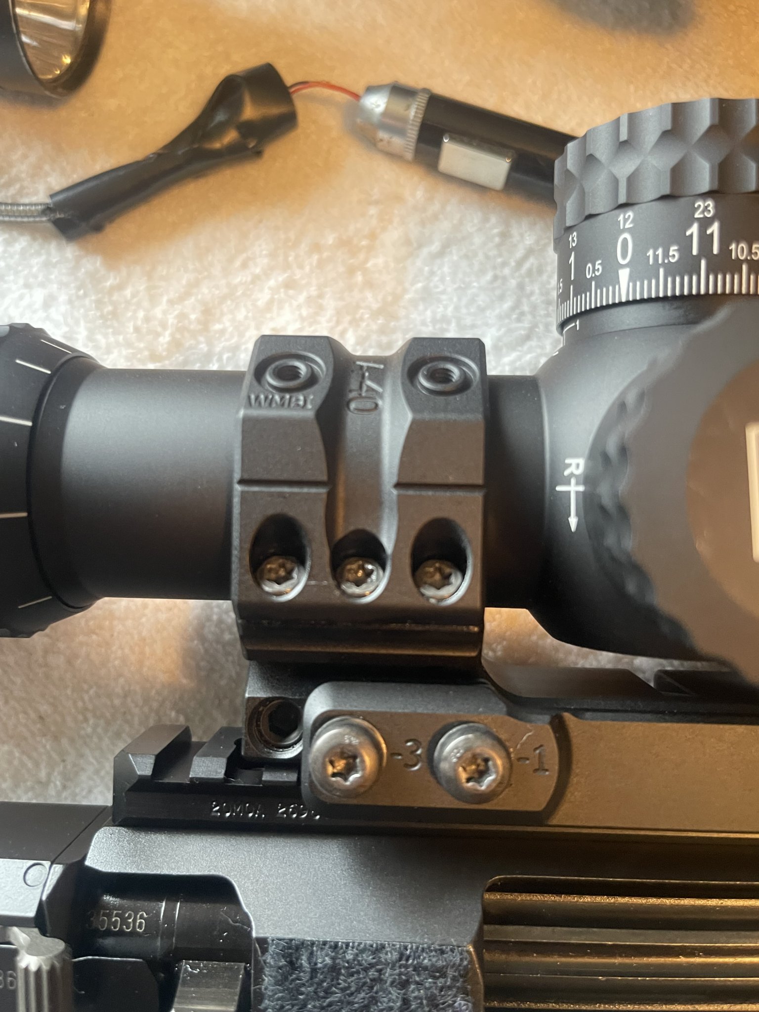

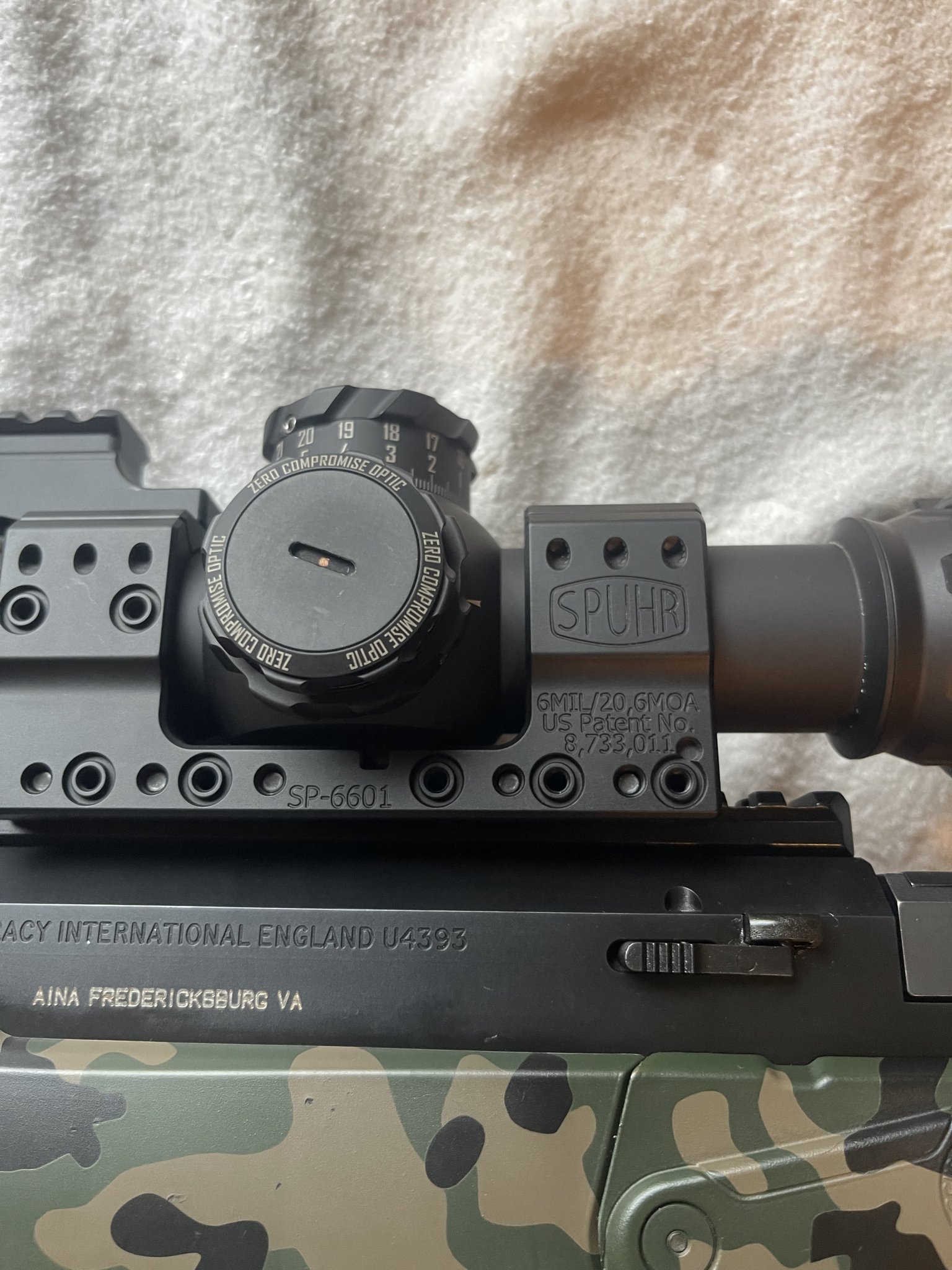

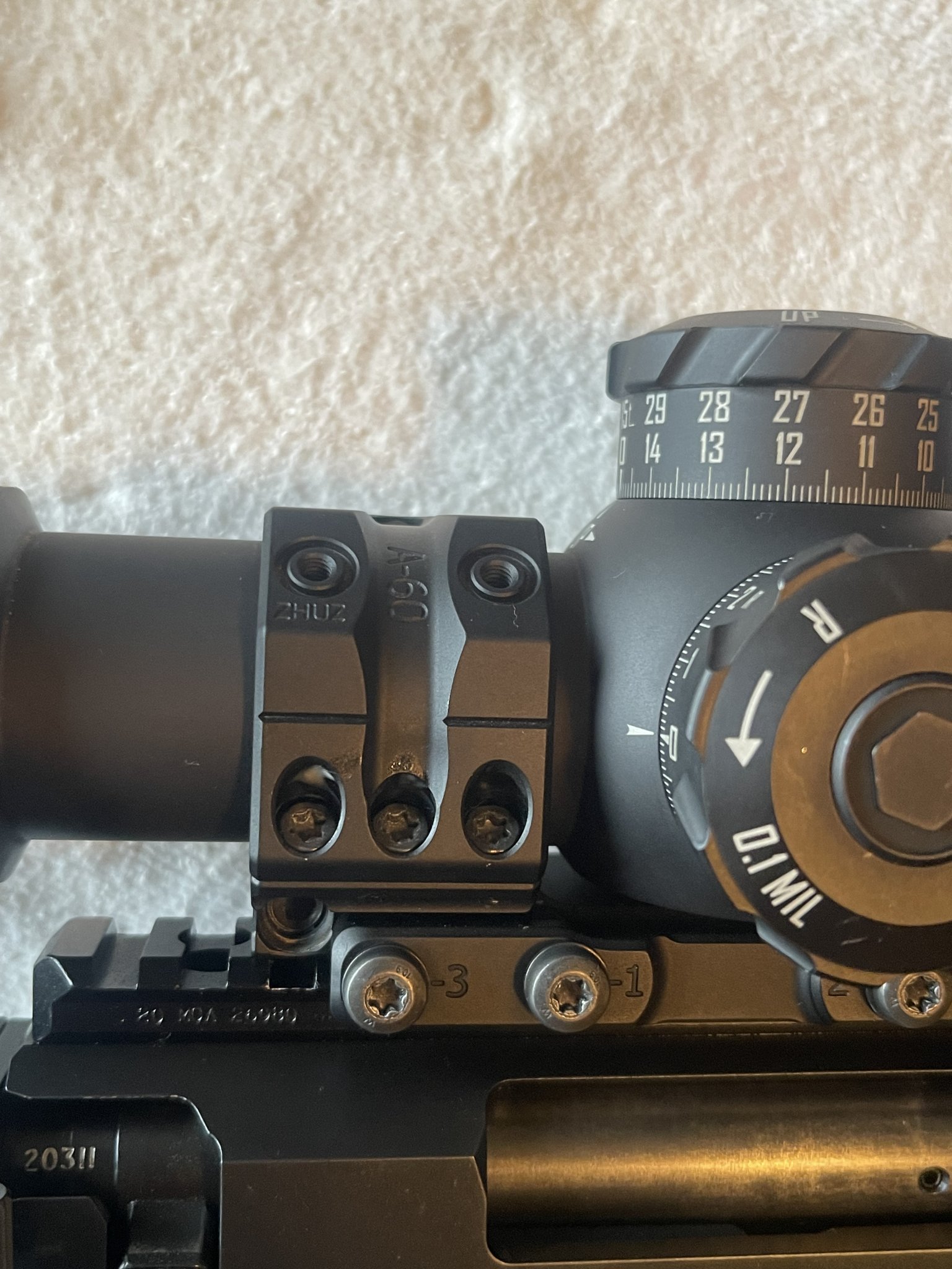

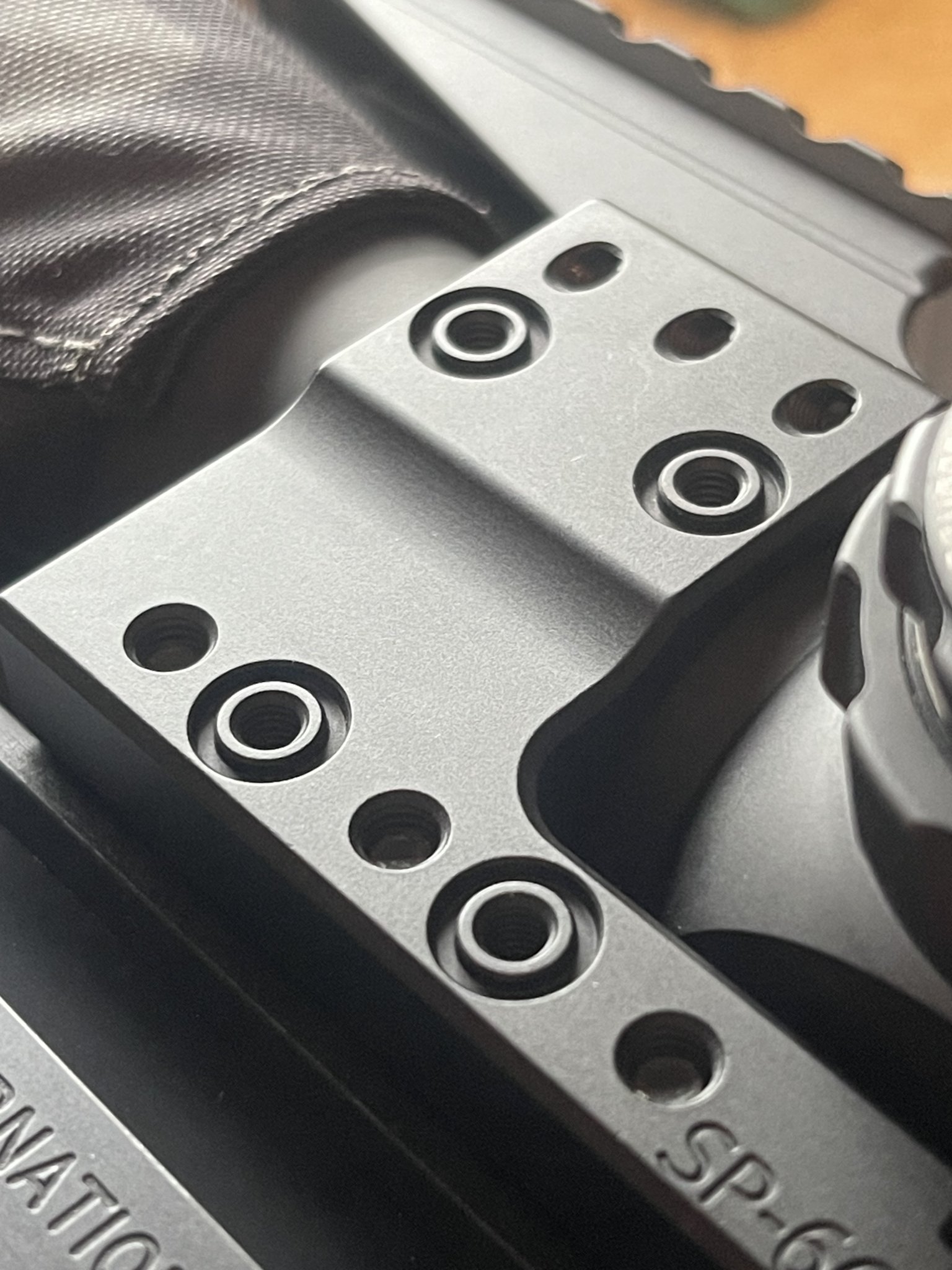

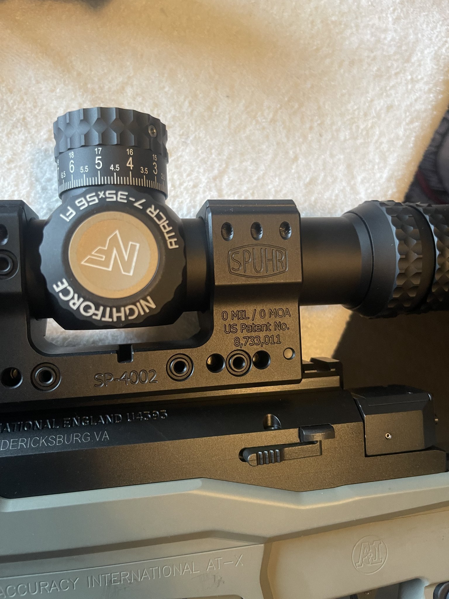

I am generally curious how that is legit determined to be a fake. I’ve looked over mine in the past and have tried to spot the differences. So I’m legit here to learn. Saw another video a couple weeks ago. I’ll try to find it. But in that video the stuff pointed out seemed more extreme then here
The levels- Spuhr has both clear and green. That green level is a very clear as compared to other fakes I’ve seen. Although you can replace them I’m curious if that’s not a legit level
The numbers you point out are different because to my knowledge they’re batch numbers. Each part I believe is associated with a batch number. When cracked my crossbar I gave the batch number on the bar to Mile High and it didn’t seem to surprise them it was cracked. Assuming that batch had its issues

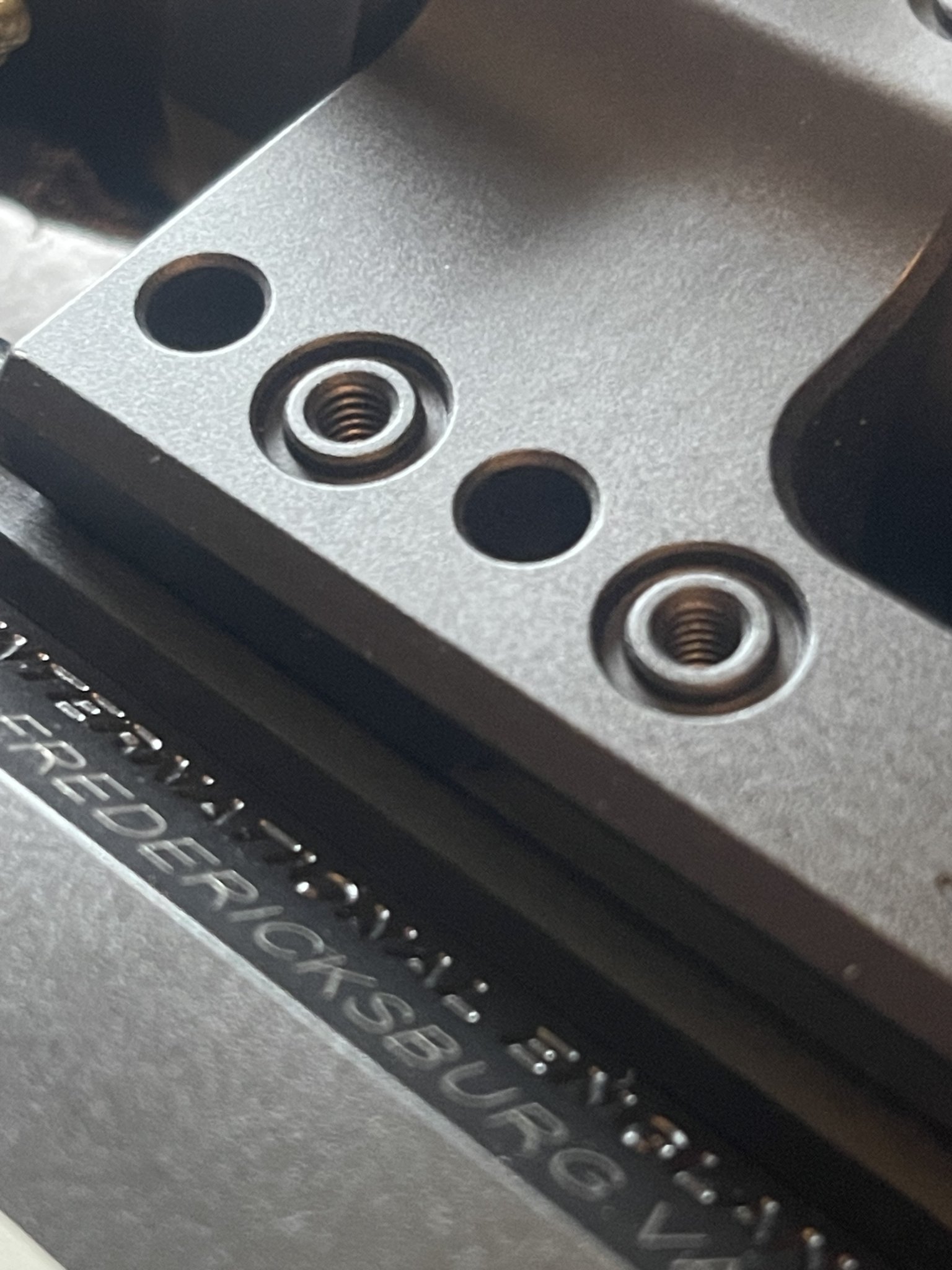

I’ll give the machine on the fake to be less deep and the burrs on the ring screws are not counter sunk from opposite end. But damn these things are so legit close. I also don’t see markings on the hardware
Does anyone else have pics of these areas on legit or fake spuhrs?

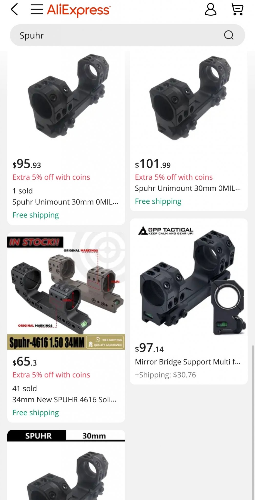

That being said, fakes are 100% a concern, especially if you're buying used. I just did a search on AliExpress and look what we have...
Several listings on eBay: $61.99 for Spuhr one piece mounts in black or fde coloration. Shipping from China. The seller has a wonderful 86.5% rating on eBay.
