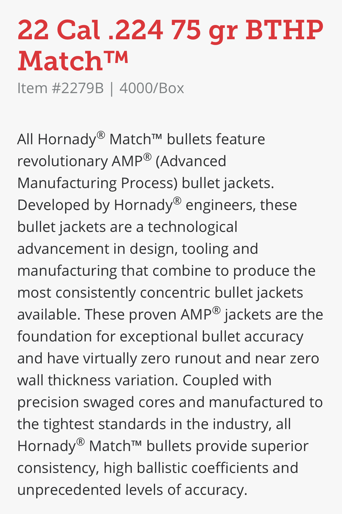

I will start by saying this... ive been a HUGE Hornady supporter since day 1. I use their duty ammo on duty, their bullets for reloading, and their factory ammo for most calibers I run. I had decent luck with the Frontier ammo in the past, so I ordered 500 rounds of the 75 Gr OTM Match 223 for my Knights LPR. I had 5 other kinds of ammo out with me that day as well, so I only brought a box of each to see what the rifle liked best... When I opened the Hornady box, I was a bit annoyed to find two FMJ rounds stuck in the box with 18 OTM rounds. I contacted Hornady, they basically said ammo is fine, go shoot it. Obviously I figured it was safe to shoot, however I was more concerned with spending $14 a box and receiving $6 a box ammo mixed in. After emailing my concerns, they agreed to send me a box of comparable ammo, which was fine.
Fast forward to today, retesting with some new ammo I received recently, so I grabbed 2 more boxes of Frontier from my 500 round case. Sure enough, both boxes had FMJ mixed in. One box had 3 rounds, The other had 2 rounds. Now im a bit angry that quality control is complete crap. All from the same lot number, same brass, same looking crimp, etc. So after shooting today, I got home and opened up all the boxes. Of the 25 boxes, only THREE had all OTM rounds. The rest had between 1-6 FMJ rounds mixed in. If my 500 rounds had that many in there, im sure the whole lot (and who knows if others) are affected as well. I emailed Hornady today, so we will see if they want it all back and replace it, or just replace the total number of FMJ rounds. Total I found was 65 FMJ rounds, and one random soft point. Thats over 13% mismatched.
I figured id at least notify people looking to save a few bucks on match ammo... you get what you pay for. Thankfully the 73 and 75 gr match ammo actually labeled Hornady were all the correct rounds.

Not making excuses for them, but frontier is not match grade ammo. It's their budget plinking ammo.
Maybe my eyes are getting older, but looks like it clearly says "Match" and "Hornady bullets"...
That’s the name of the bullet.
Also as I understand it the Frontier ammo is made by Lake City with Hornady bullets but I’m not sure exactly who is packaging it.
I personally have had good luck with the .223 ammo but have never tried any of the Frontier 5.56 ammo.
Its Frontier brass, Hornady bullet, and sold by hornady. It says loaded in Independence, MO, and sold out of Grand Island, NE, where Hornady is. While I dont have the tools to measure brass consistency, bullet or powder weight anymore, "match" grade is really just more consistent than plinking grade. PPU has a Match line, PMC has a match line, as well as many other companies we consider "plinking" ammo. This could just be plinking grade with quality bullets, or maybe its built to a higher tolerance. If I still had a chrono, id go get some readings and see if its sub 10 SD or not, but all I care about is it shoots well, which so far its been decent. I dont expect ANY ammo, even the cheapest of cheap plinking ammo, to come with assorted bullets in their box that designates one type of ammunition. Regardless of if it shoots MOA, Sub MOA, or 5 MOA groups, they should at least be all the same bullet. Being the bottom of the barrel Hornady private label ammo doesn't get them off the hook for that.
My comment was more in reference to the fact that it is really plinking ammo loaded with match bullets but that’s no excuse for the mixed ammo. I’m not well versed in ammo manufacturing but it does seem odd that different types of ammo would end up in the same machine packaged boxes. As I understand it that ammo is all made on different machines so somewhere they are getting cross contamination in their packaging lines.
I’ve never had that happen with any Hornady ammo that I’ve bought over the years so I’m curious if it was being made somewhere else then bulk shipped and packaged by Hornady that could be causing the issue or if Lake City was packaging it and causing the issue. Either way it shouldn’t happen and the ammo should be replaced.
Id be even more sad if Lake City did it... ive never (knock on wood) had a lake city manufactured product fail, and ive shot 20+ year old stuff.
The cases are from Lake City. The ammo is loaded at Lake City, the bullets are from Hornady, and Hornady handles the fallout if there are problems. It is similar to Hornady Match ammo only in the bullets used. Pressure, velocity, accuracy, and sorting tolerances are likely very different. In this case it's plinking ammo with higher grade bullets. As others have said, give tech support a call and you'll be taken care of.
By the nature of how ammo machines work, I very seriously doubt they had 2 different bullets (especially with that much length variance between a 55 and 75) being loaded in the same run of ammo. I'd guess you're likely looking at 2 separate lots of appropriately loaded ammo accidentally getting mixed.
3 separate :)
