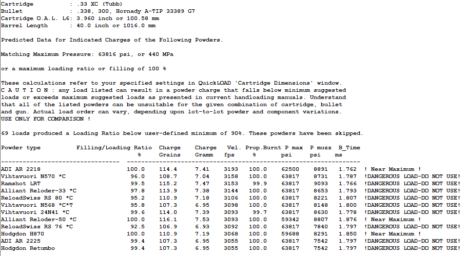

Quickload says you might get close with .33XC a 40" barrel and AR2218 (H50BMG)
