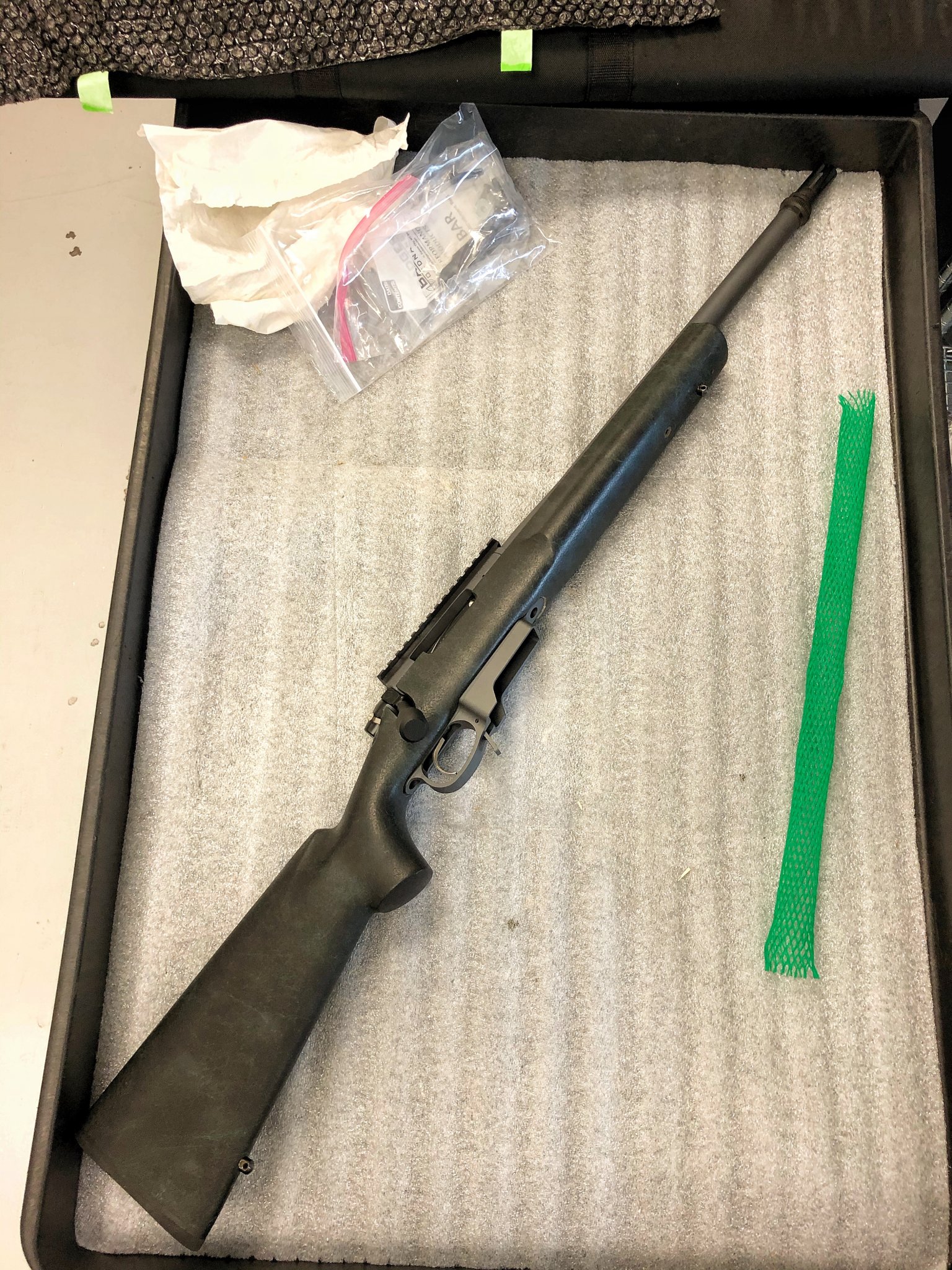

    This. I had Caleb at Alpha & Omega spin up a shouldered prefit for this 16.5” .243. Any smith worthy of the title should be able to set you up just fine.
