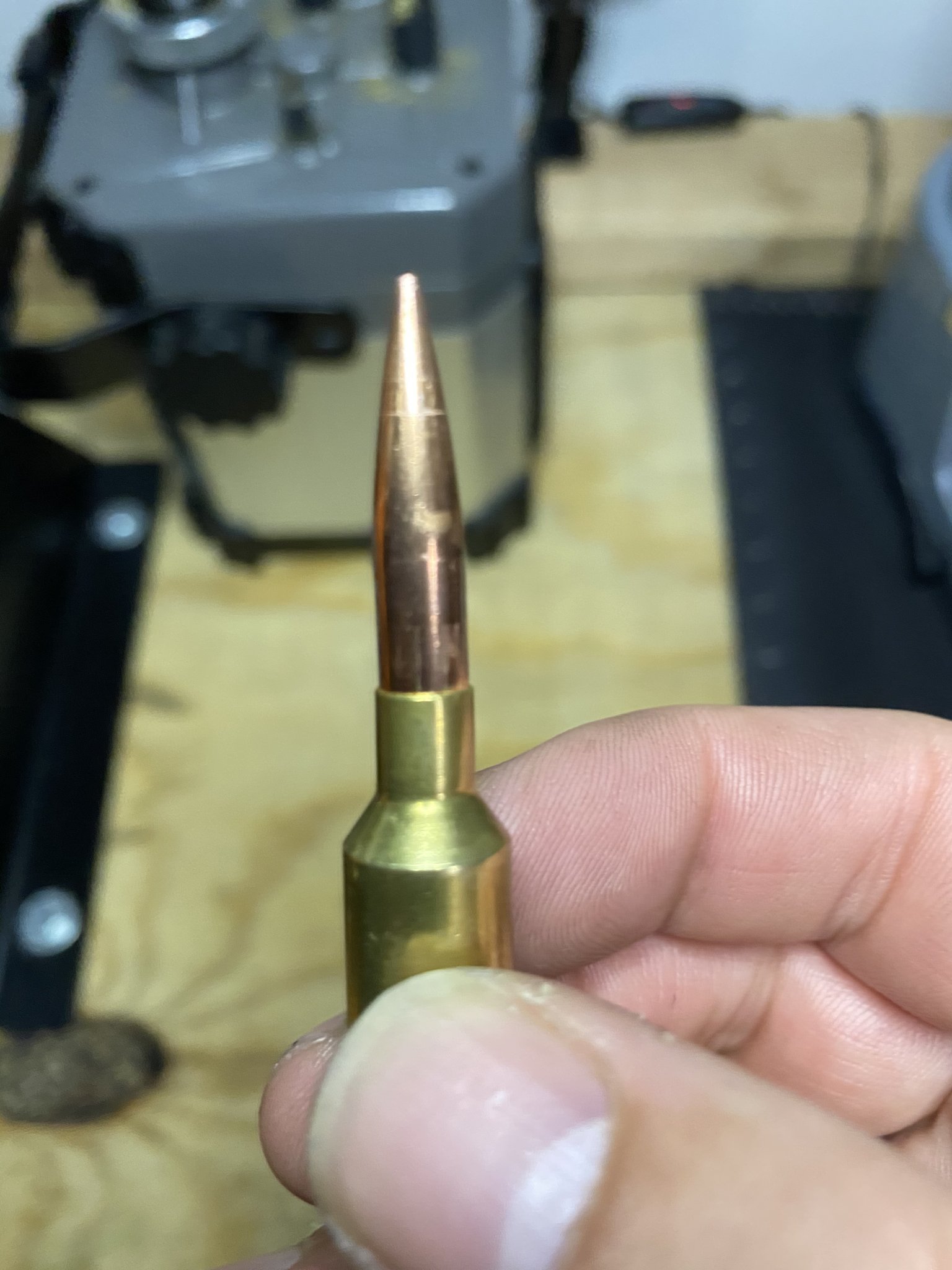

    I then seated 2 bullets and and then the first was a struggle to chamber and on the second it got stuck. In the process of running the bolt back the bullet was in seated from the case.
    i think I can deduct from this its not a brass issue or the action but maybe the barrel or the bullet...
    fair?
    Carbon ring? You did mention there were marks on bullet. Clean throat really good and see if it improves. If you have access to a bore scope I would look in there first.
    Thats what I think to be honest.... I forgot to post the pic... this is the case and bullet that was pulled apart....

    @Gwain and @Steelhead you both were on to something!!! So after full dissemble I took several cartridges and slid them into the barrel directly. On some I could feel 2 points of contact... went the boretech / bore scope (thank god for Amazon same day) route and found it was carbon ring sticking to the bullet.
    Once that was cleaned up I could feel 100% just sliding the cartridge into the barrel that the case bottom was not sized fully. The. It hit me after trying other rounds I loaded 2 weeks ago.... the ones giving me issues were ones I pulled bullets from and I must not have fully sized them. Broke them fully down reset my sizing due from scratch gave them a full press and tested just the brass in the barrel. Much better. Rebuilt the cartridge tested and good! Tested 4 problem cartridges that I knew still had issues and they did... broke them down and rebuilt worked great and no issues.
