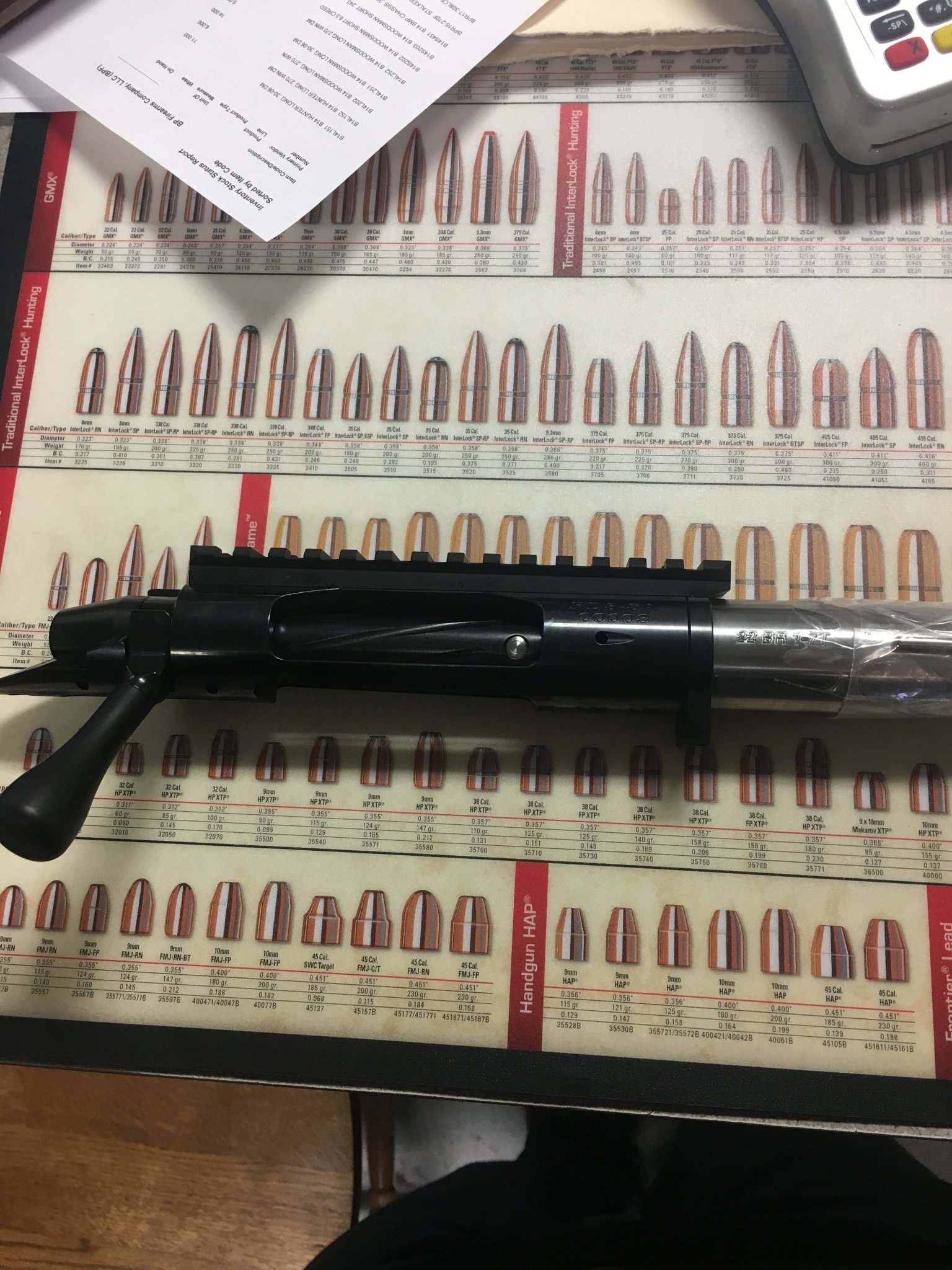

Can’t wait to shoot it. Serial number 00003
