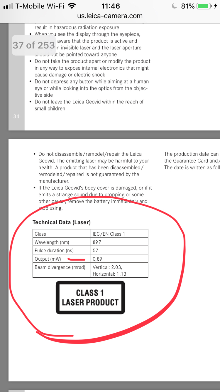

That’s asking for a lot. The laser on the Geovid is underpowered and the beam divergence is horrible in my opinion.
I can’t recommend any Rangefinding binos. I’m curuous how well the new ranging binos will be but I’m far from an expert. I personally think asking a rangefinder to range 3k yds is asking a lot. Can some low priced handhelds do it? Yes. Is their accuracy within what’s acceptable for making those kinds of shots? Hell no.
