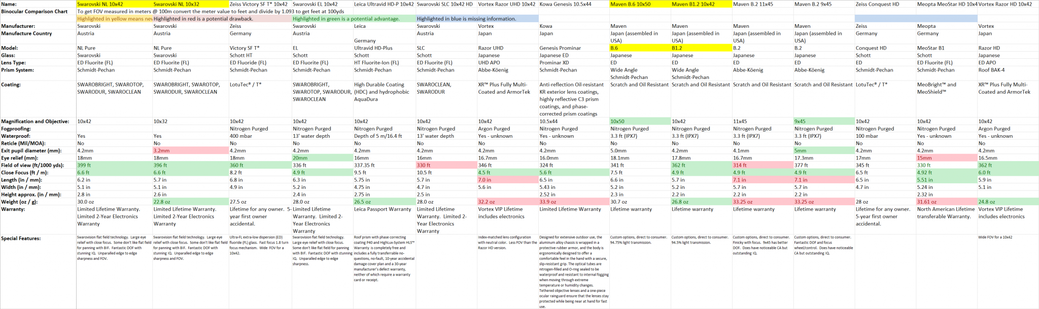

Here's a chart I've put together on 10x (and close) binos, just a quick spec check, one thing to notice is the FOV values, it really does make a difference IMO
Reactions: kthomas
Awesome, appreciate the detailed response!
